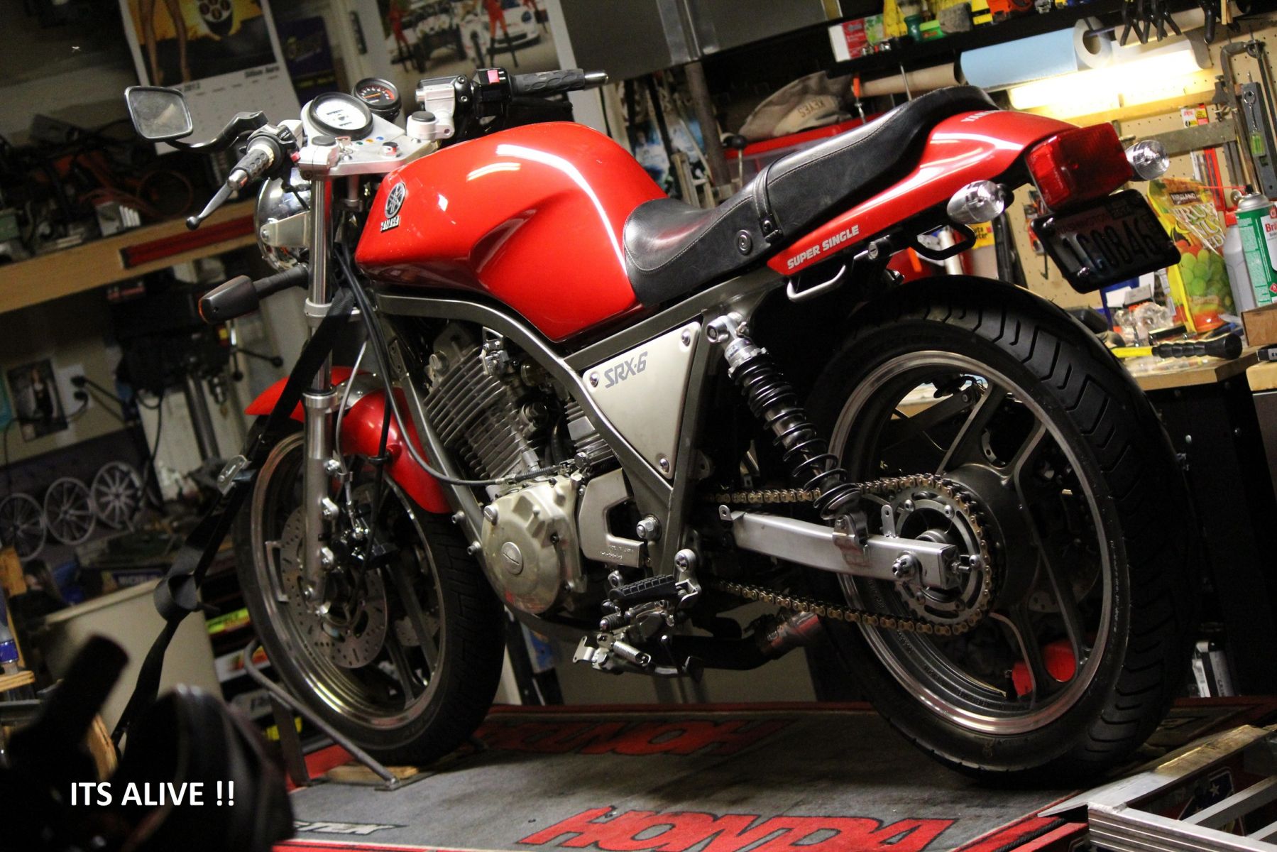

I finished another project.. brakes and stuff.... on Yamaha SRX 600 for a buddy in Washington State.
