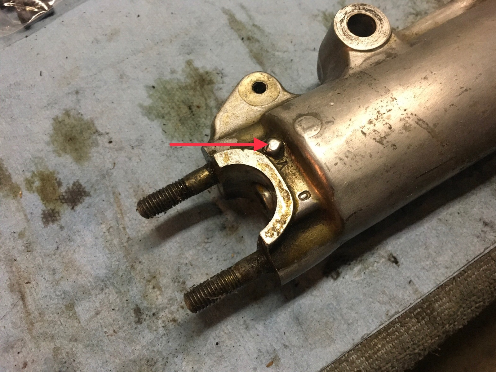

The cable is supposed to exit the housing pointing straight back, parallel to the ground. I can't remember, but thought there was a feature on the fork which engages with a matching feature on the cable drive housing to orientate the housing correctly?

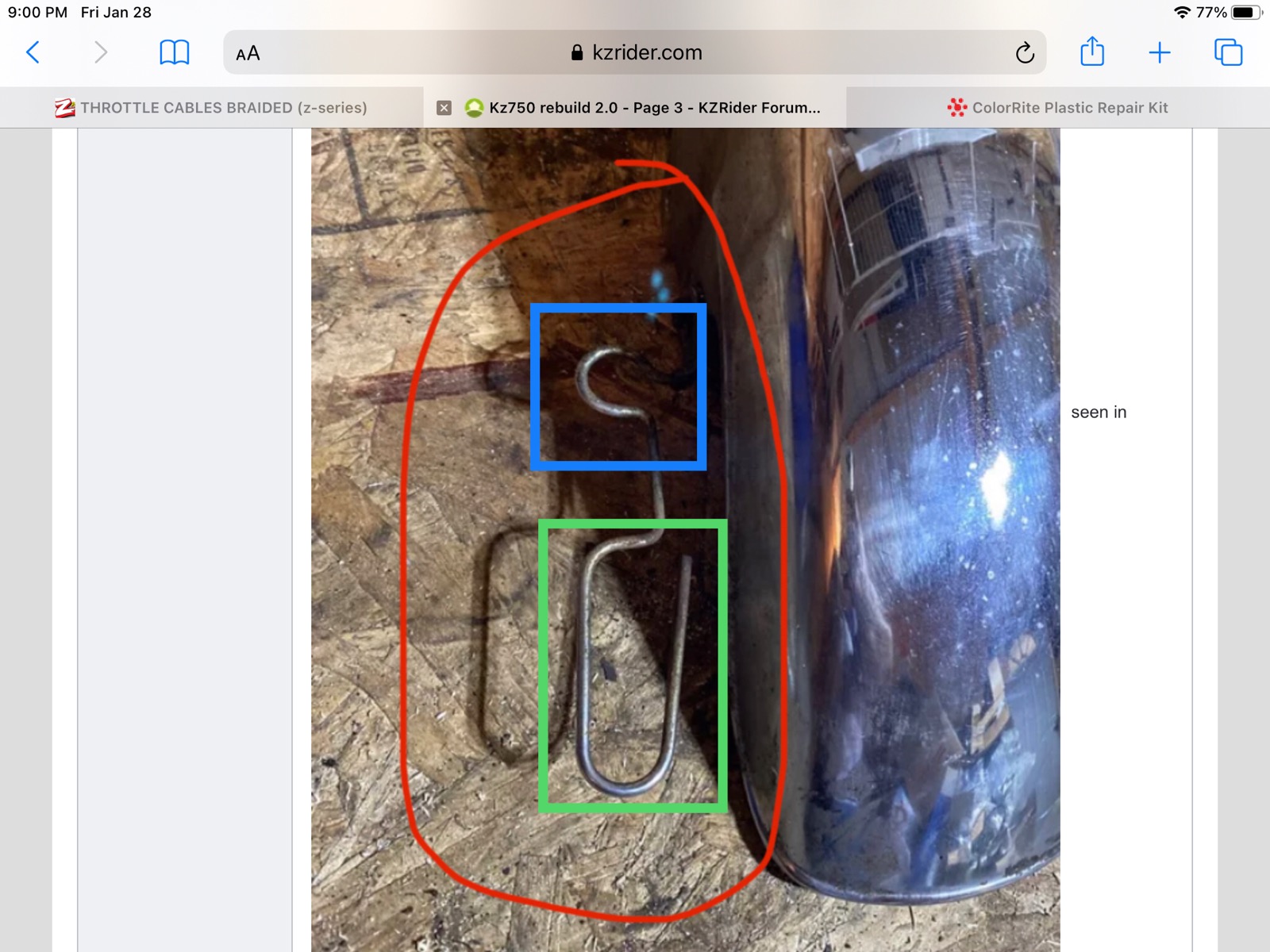

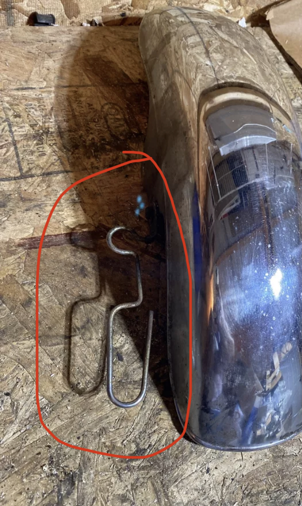

Nessism, do you have a picture? You are probably correct however I have always had it parallel to the forks. There is a holder for the cable coming off the fender.
seen in the red circle.

blue square is for the brake hose. Should have a rubber grommet
green square is to fix the speedo cable. No grommet.

Learn something new everyday. I guess one of the previous owners lost the grommet so I’ll add that to the list of things to buy from Z1. I will definitely correct the gear housing tomorrow. The cable always did seem a bit long. Thank you once again gentlemen.

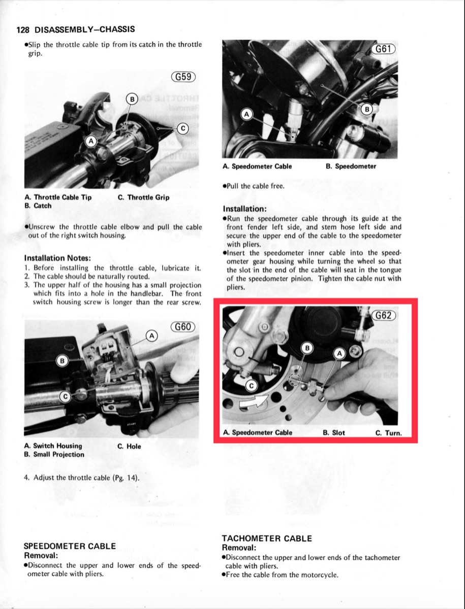

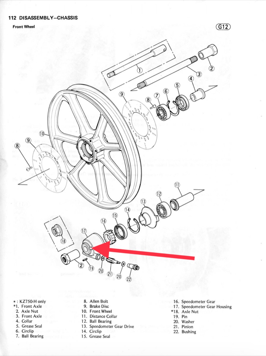

I’ll look to see if I find assembly instructions for your bike. On my big fours you assemble the axle and wheel. Mount the wheel into the fork, with the speedo housing pointing to 6:00, then loosely attach the axle clamps. Before tightening the axle clamps you rotate the speedo housing CCW till it stops (the two tabs will touch). Then torque the axle nuts, then the axle clamps.

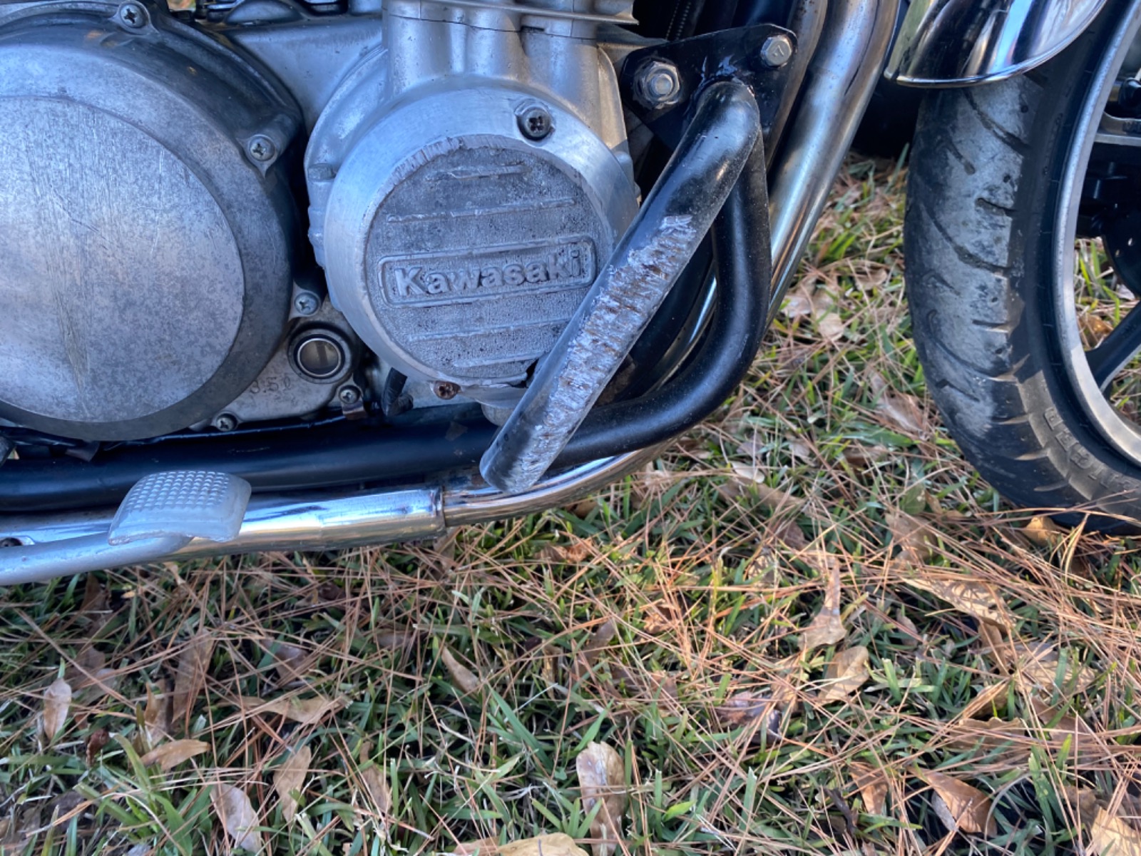

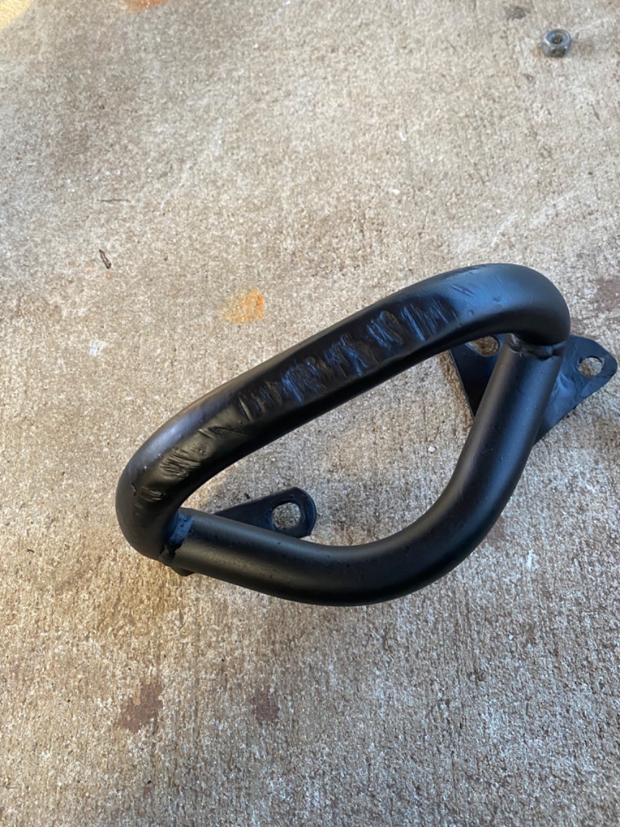

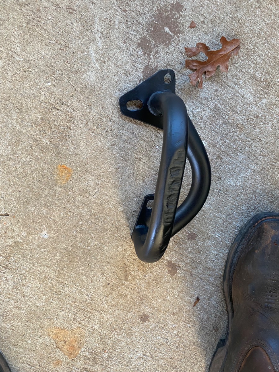

Made some decent progress on the bike today. Removed the case guard, bent it back so it’s all straight, removed all the sharp edges and have it a new coat of paint. It came out quite good compared to what it was before.
Last edit: 29 Jan 2022 15:58 by Elfarm98648.
