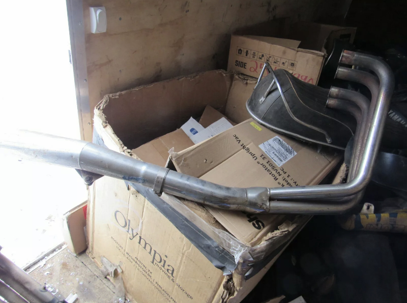

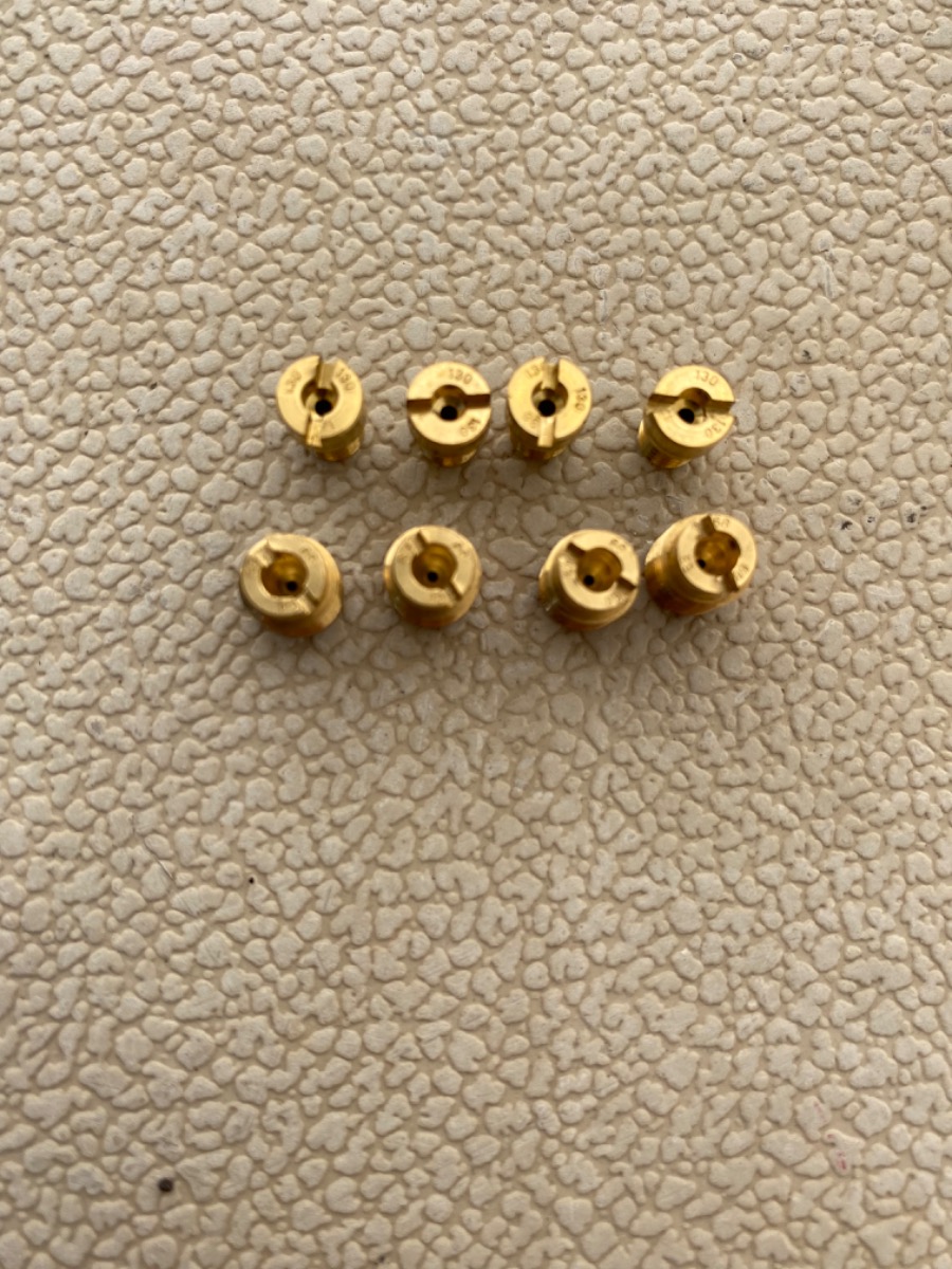

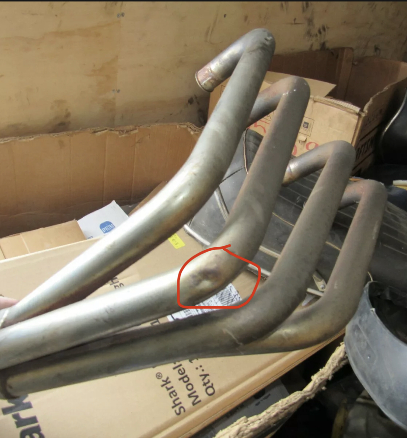

Welp, I found an exhaust on EvilBay for $150. $160.50 shipped. It definitely needs some chrome polish however the only dent it has is a very small dent in the #3 header pipe. Now I can finally use the spare jets I have laying around for my CV carbs.

I’ve done some research on a 4-1 only and it’s recommended to do 130 secondaries as the only change if you don’t have the pod filters. Do you guys think I should do a 62/130 or just install the 65/130 and remove the shims from the current needle setup? Is this just something I will have to test once it’s on the bike?

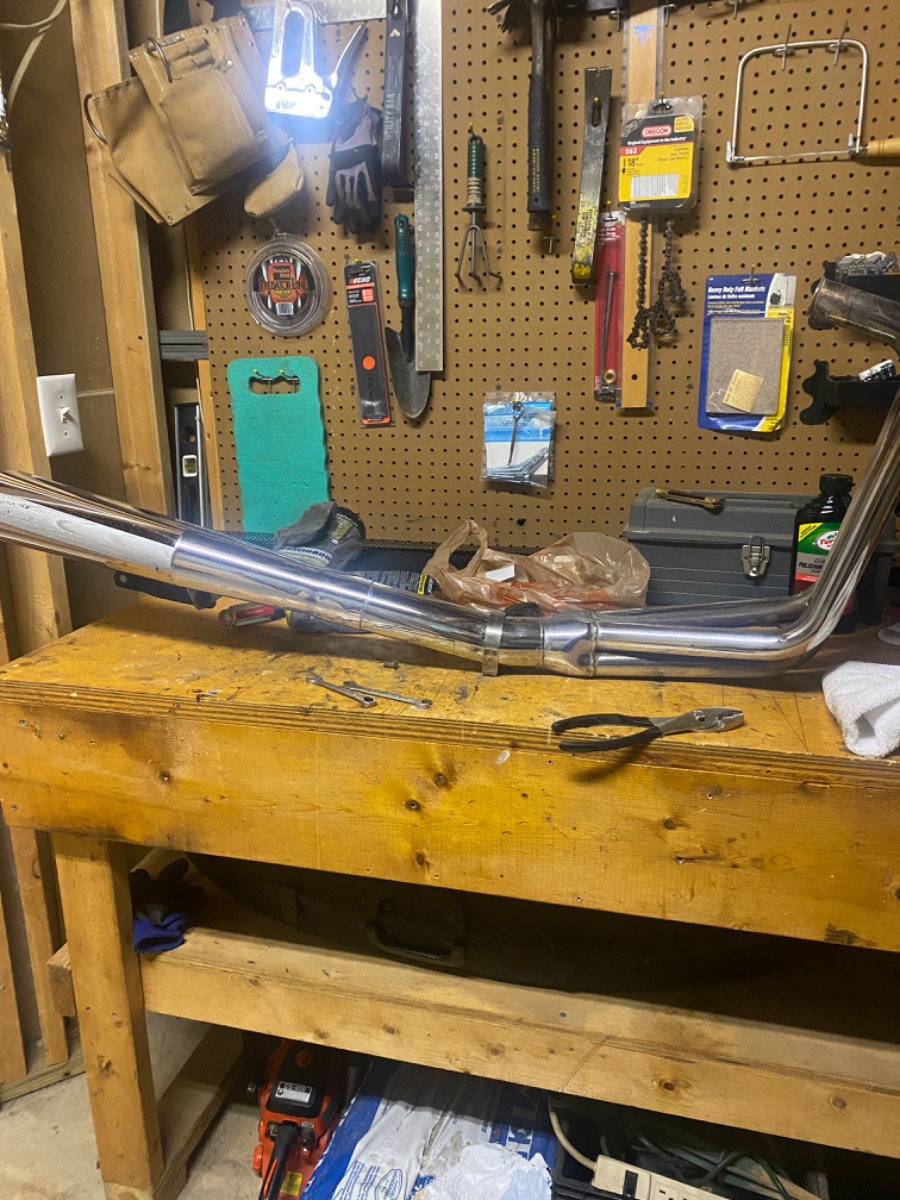

Well the exhaust didn’t look like much when it arrived. However after some elbow grease I was able to make it look like this
I think I’m gonna change the secondaries to 130 and shim the needle up a smidge and see how it runs like that.

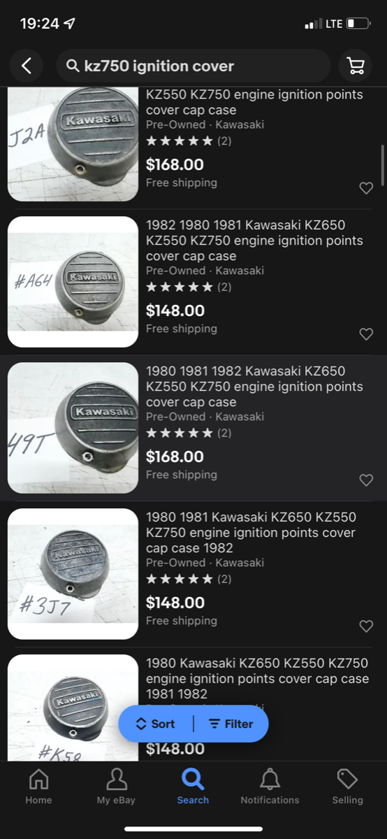

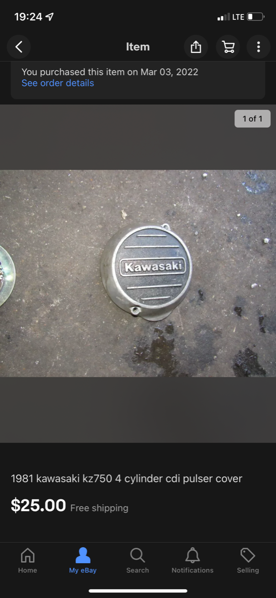

[justify]Finally snagged a new ignition cover, you wouldn’t believe what some people have these listed on eBay for… someone apparently didn’t know what they had.[/justify]
