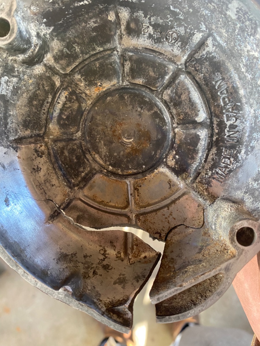

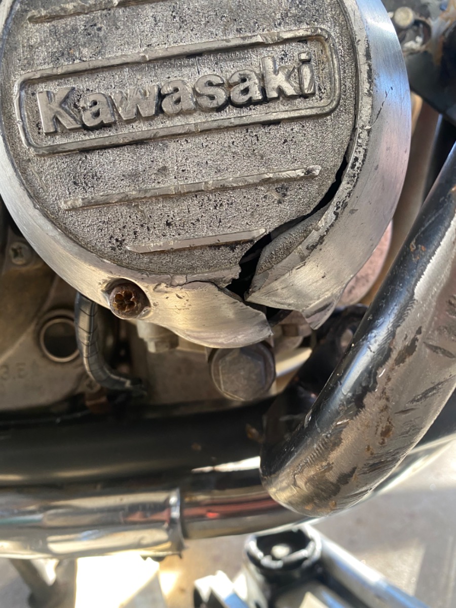

As far as the ignition cover…
Kinda safe to say it’s pretty unrepairable. Add that to the purchase sooner rather than later list.

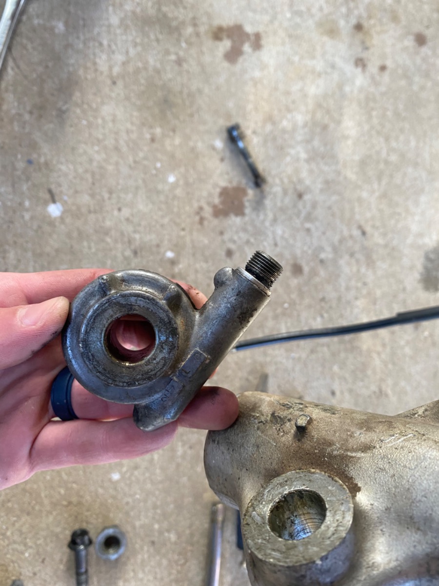

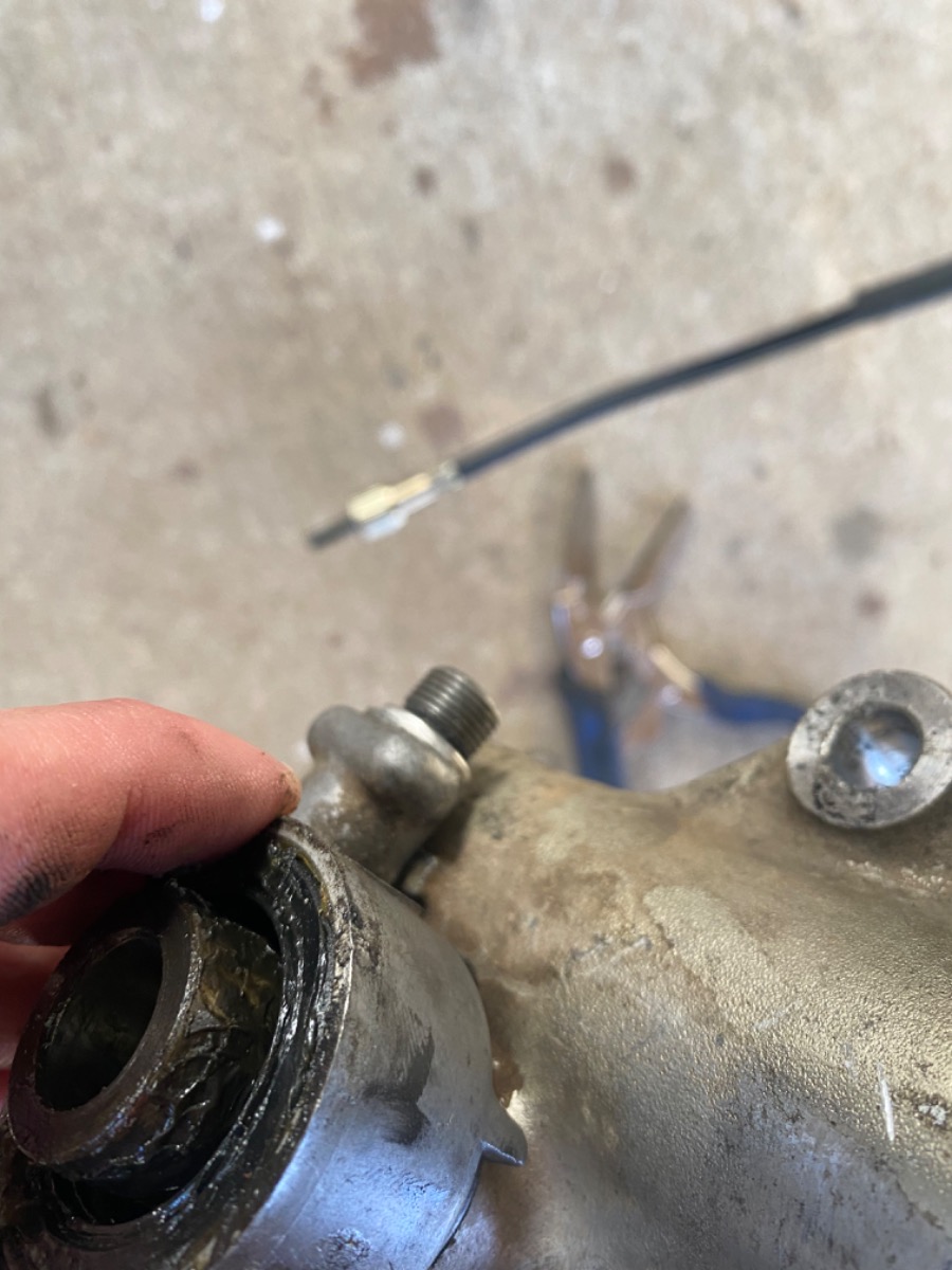

I looked back at the speedometer gear housing and found a peg on the left fork, like y’all said there would be. So I got that moved around and how it should be now. Ran it through the routing thing on the side of the fender and it looks very clean now. Also took up some slack in the length of the cable.

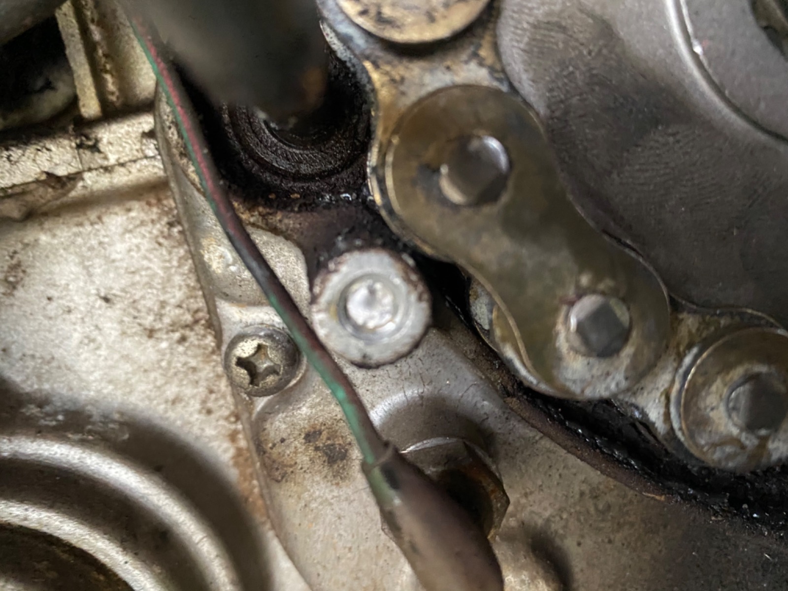

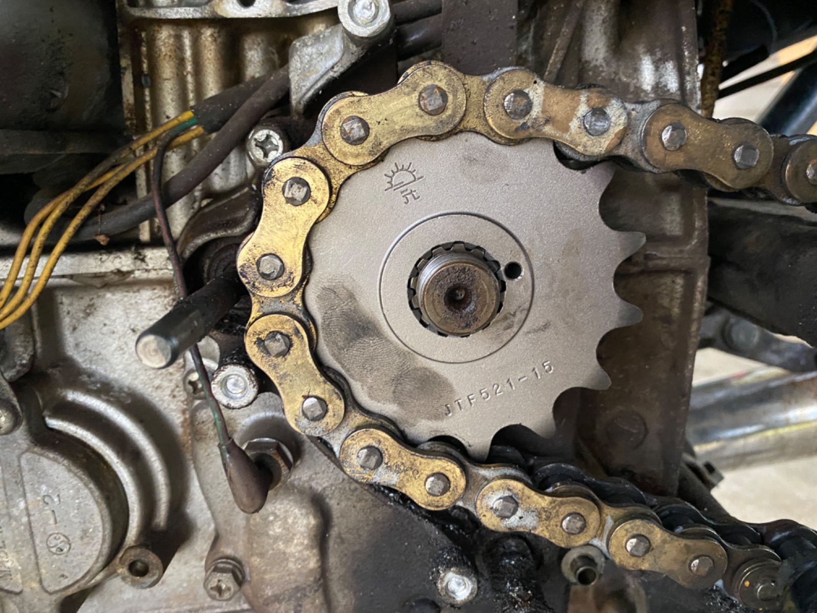

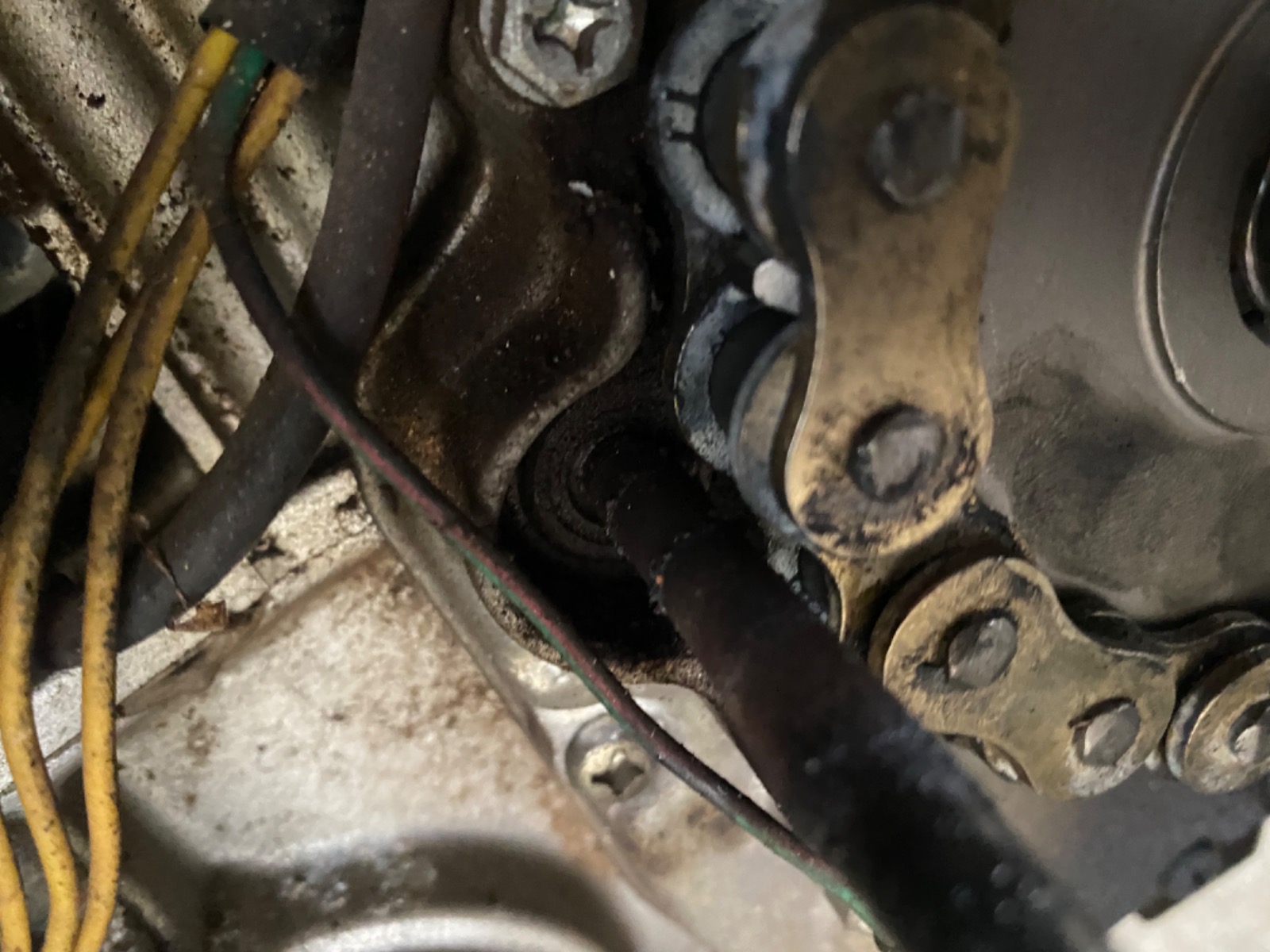

Aligned the forks, put on the replacement handlebars and she’s back to pointing where I want to go now! Got a lot done today. My Z1 Order came in, super happy with the customer service from them. I will no doubt be purchasing from them again. I got my shorter clutch cable(TU06-3030) and installed it, it is the perfect length for the superbike style bars. The throttle cable(TU06-3112) is also the perfect length and very well made. The replacement rear sprocket is also on, no upgrades here just maintenance. The front sprocket is the sad story. I was hoping to put a 15 tooth on the front, a sizable upgrade from the stock 13 tooth. However the 15 tooth makes contact with the clutch push rod and the chain guard brackets.
So I have sent Z1 a return request, let’s see how easy or hard the return for this sprocket will be. I will be purchasing a 14 tooth with the hopes it will work, if not my 13 tooth is still in good shape.

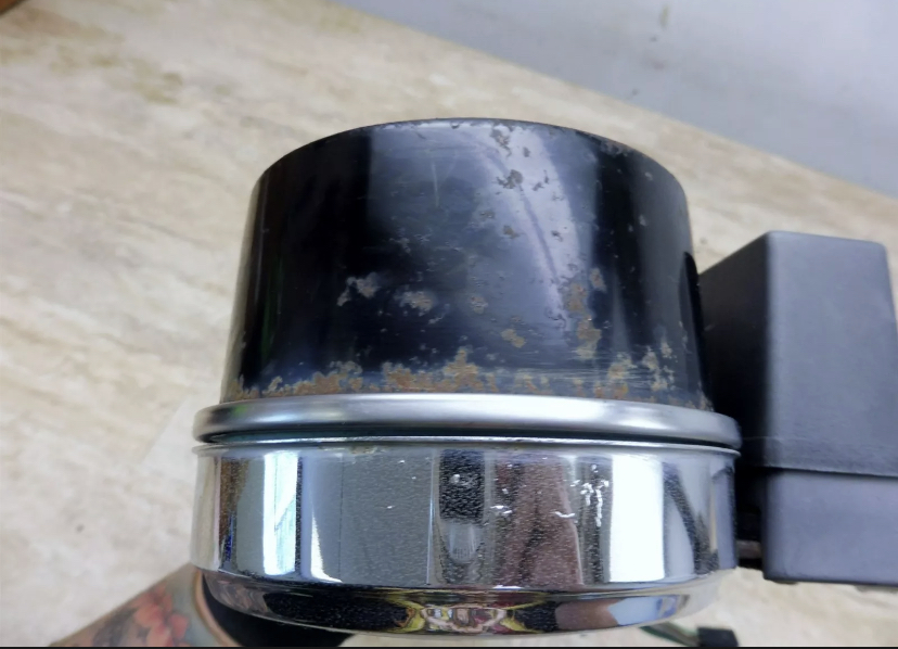

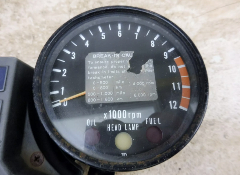

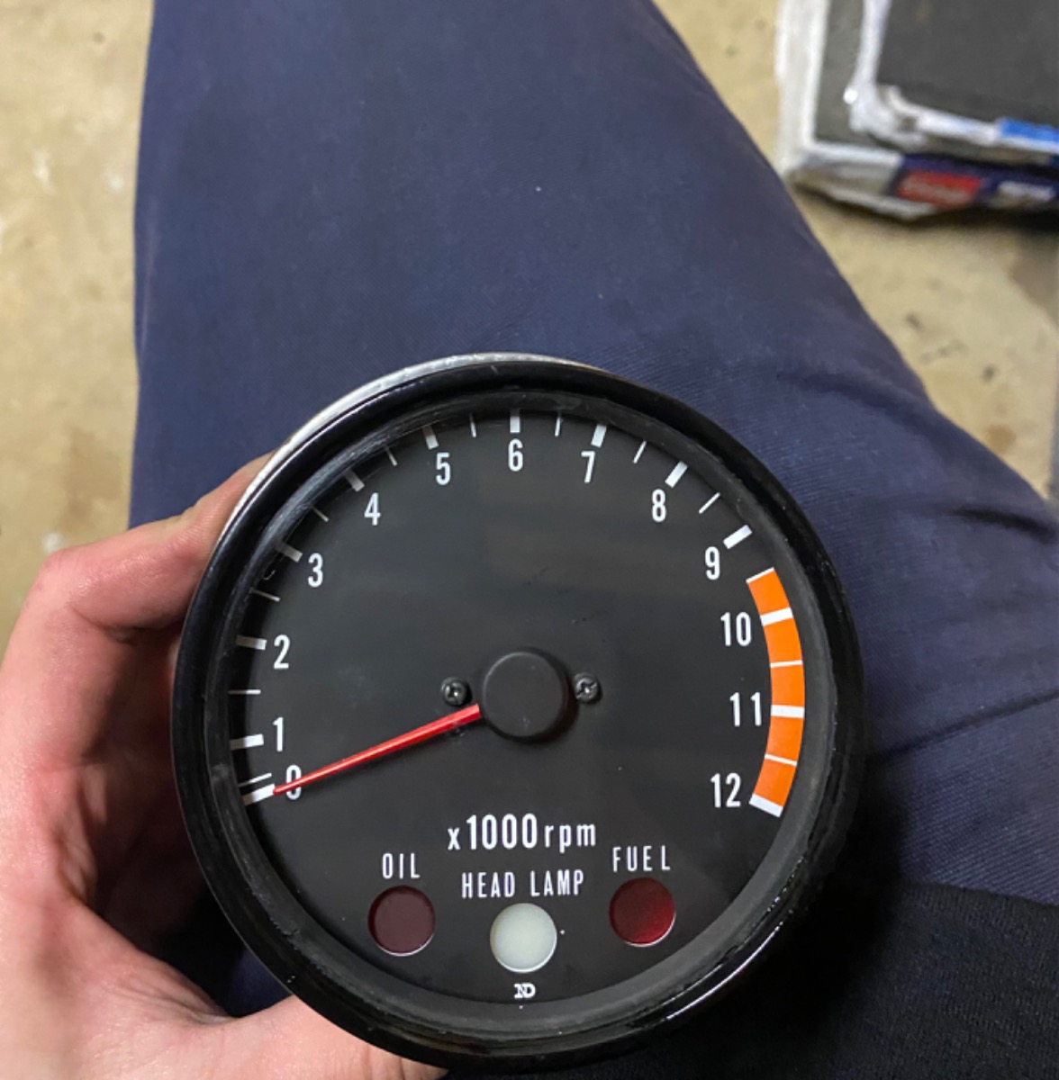

Also got the tachometer and indicator light cluster in the mail this week. It came in rough cosmetic shape but inside the gauge it was pristine. I opened it up to put my LEDs in it, give it nice coat of paint, and give everything a good cleaning. Here’s some before and after pics.
Before
After
Before
After
I am super happy with how these came out. My goal for tomorrow is to top off the fork oil, get my return sent back to Z1, and possibly install my valve shims just to make sure everything is top notch.
Before
After
Before
After

05 Feb 2022 00:20That why the conversion to a smaller chain and sprockets is the way to go, same strength or more if you want, less weight, and more room to fit bigger sprockets. I'm running a 17 tooth front on my 750....The front sprocket is the sad story. I was hoping to put a 15 tooth on the front, a sizable upgrade from the stock 13 tooth. However the 15 tooth makes contact with the clutch push rod and the chain guard brackets.

Another edit: Nice work on the tach
