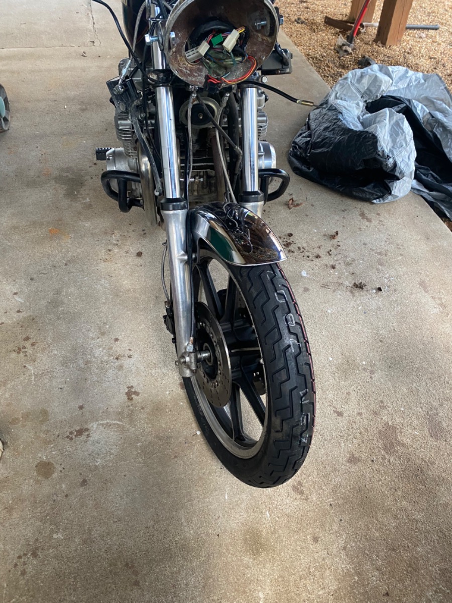

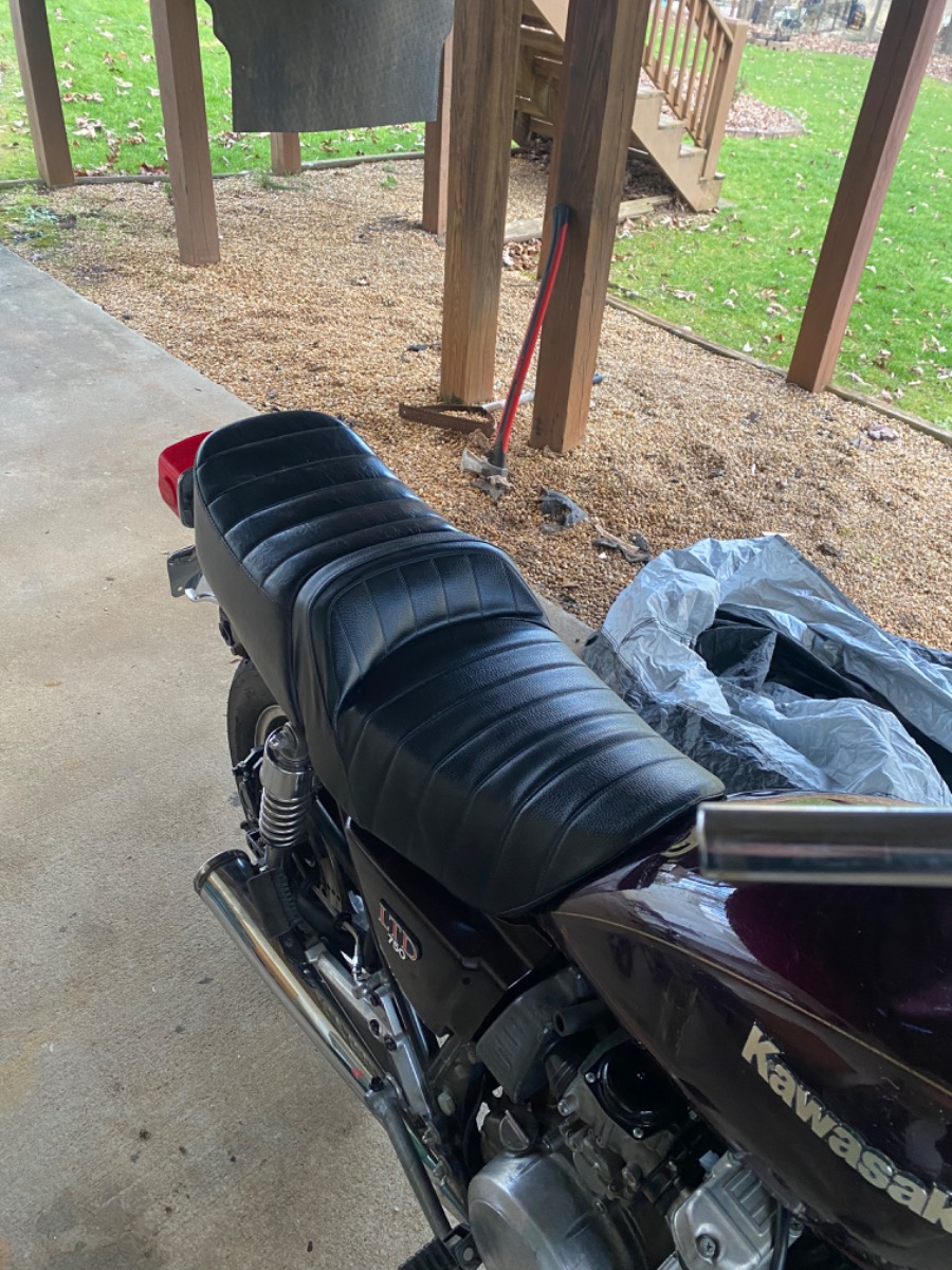

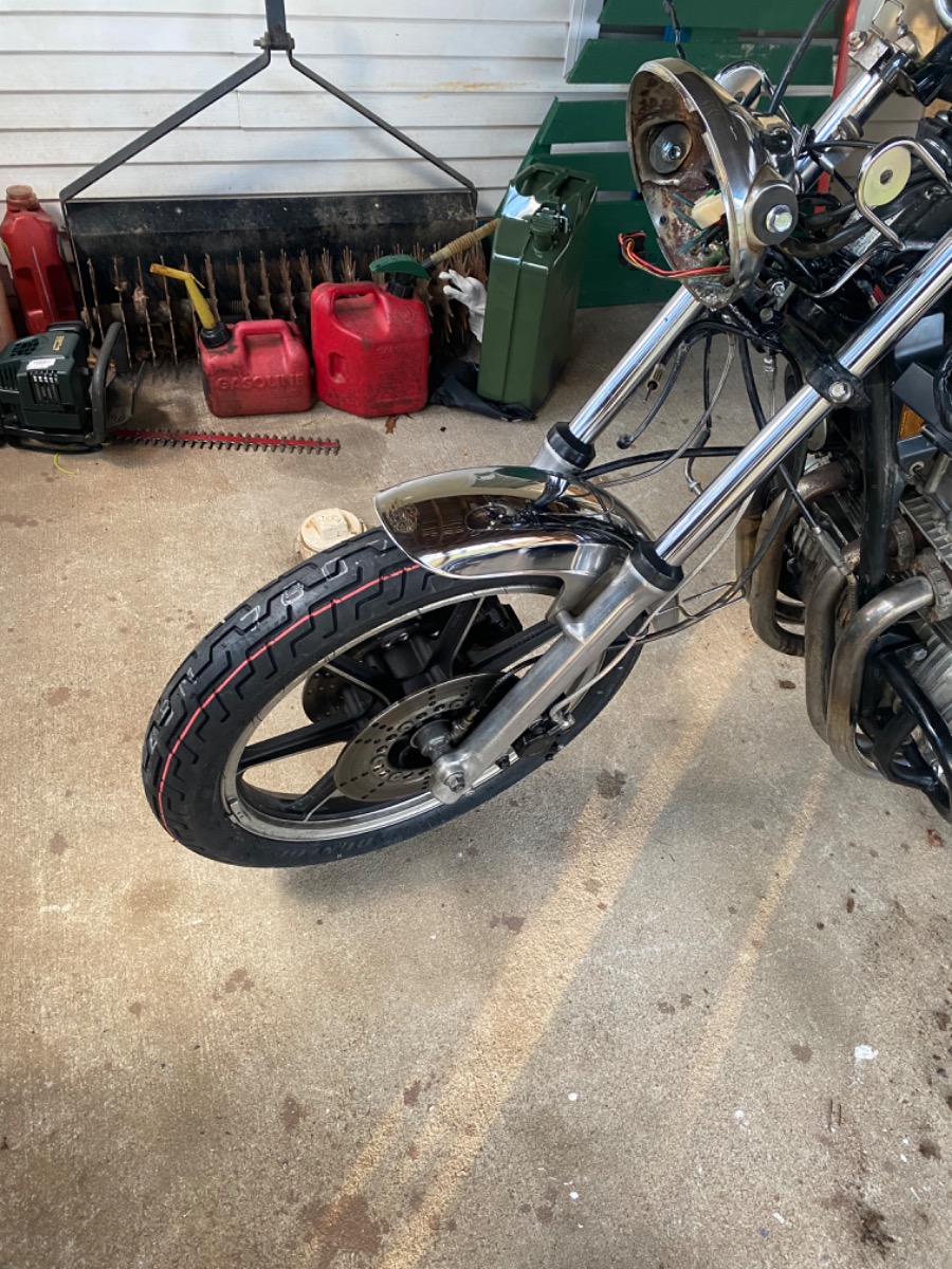

Re: Kz750 rebuild 2.0
28 Jan 2022 14:49 - 28 Jan 2022 14:51
Welp, $45 later the new front tire is mounted, new valve stem installed, and the front end is all put back together. Now the only part that I HAVE to replace is the tachometer and indicator lights. Right side Muffler will hopefully come with the replacement of the entire exhaust with a 4-1 so I’m not jumping at the bit to get a new muffler for that one.
Good news is I checked my oil level while up on the center stand and it is perfect.
Also got to saddle soap the seat and reapply some leather conditioner to it as well. Not even a scuff on the seat. Still looks new!
Last edit: 28 Jan 2022 14:51 by Elfarm98648.

- Posts: 4581
- Thanks: 1851
28 Jan 2022 17:06
I have never had a bike with leading axle forks but the placement of your speedo drive doesn’t look correct.
