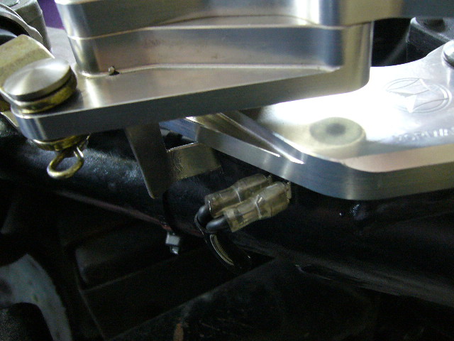

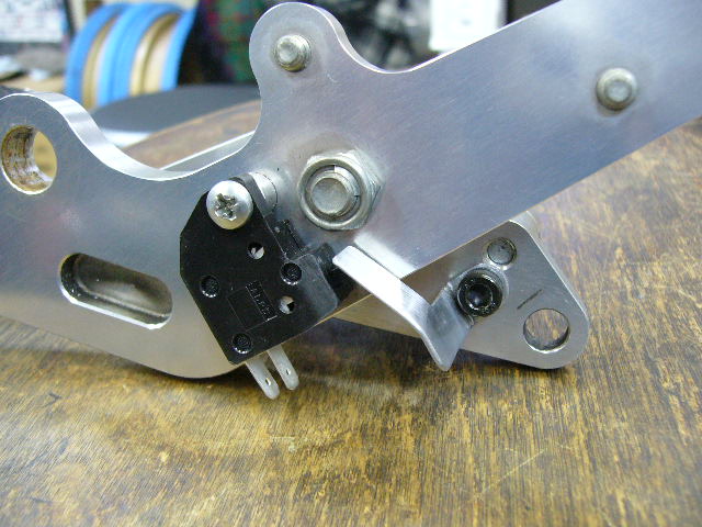

- Posts: 7442
Re: Which one do you prefer?
14 Aug 2012 11:12
here is one way to do the brake switch.
the pressure switch built into the banjo bolt has got to be the slickest solution tho.
- les holt
- Posts: 1633
- Thanks: 286
14 Aug 2012 11:21
I don't know Leon, I like the micro switch, the banjo fitting is going to be exposed to potential damage, the micro switch can be tucked under neatly.
