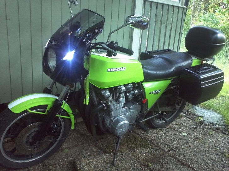

Hey again,
Thax for your input. I decided not to go for the Z1 chopper bike...to many parts missing before I have it somehow complete.
Found this one instead: Kawasaki z1000 -79 ($1900 US)
Could this work as a Z1 clone ?

Alot better choice. You should be able to attach the Z1 style fuel tank and side panels relatively easy judging from your previous projects. You'll be able to sell all the stuff you don't use off that 1000.

That kz1000 seems to be some sort of a z1r having a bad hair day,not sure id cut that one up without doing some investigating.

what are the frame and engine numbers?

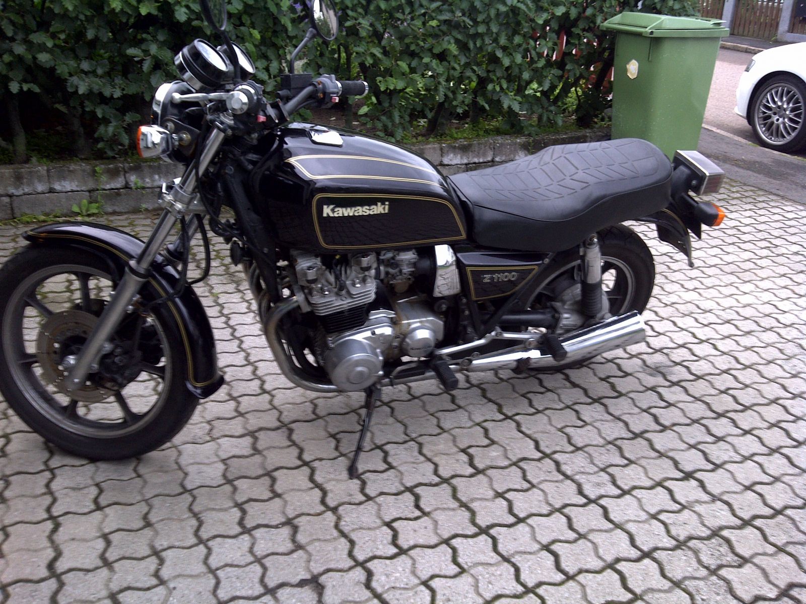

Hey again,
The "green beast" was sold just before I got hold of the owner. But I agree with you...would be sad to chop up that bike. BUT...I finally bought a bike to use for base for my build.
It´s a Kawasaki Z1100 A2/St (european name) -1982...and I just love it !
It was a steel for only $ 860
The sound of the engine is amazing, the huge tank and big engine is awsome.
Will need to convert it from shaft to chain drive.
There are a lot of these around so I don´t feel to bad chopping it up...even if it will hurt a bit.
Will this do for a Z1 clone ?
Did not get the frame or engine number of the green bike.

Looks extremely clean! Great find!

That looks awfully clean too! Not sure I'd chop that up...
Depending upon how detailed you want to make it, it could be quite a task to turn it into a Z1. It's a completely separate bike than the Z1s and early KZs: different frame, motor, bodywork and tank, etc. Just mounting a tail piece on that might prove difficult. I wouldn't want you to get halfway through then get fed up with the work you have left.
Either way, that's a pretty sharp looking bike! You'll be able to enjoy that for many miles as it is already!
