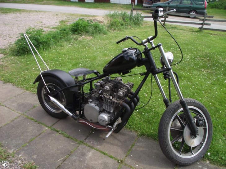

Came across an add and for a Kawasaki 900 Z1 -75 rebuilt to a chopper. (see pic)
I can buy it for 1.700 $US and the only useful parts would be the engine and the title.

And whomever built that chopper like thing needs to hunted down and shot. That is just plain UGLY.

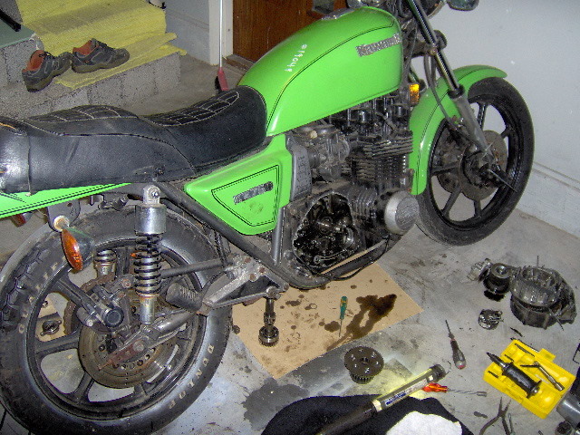

Last Project before pic:

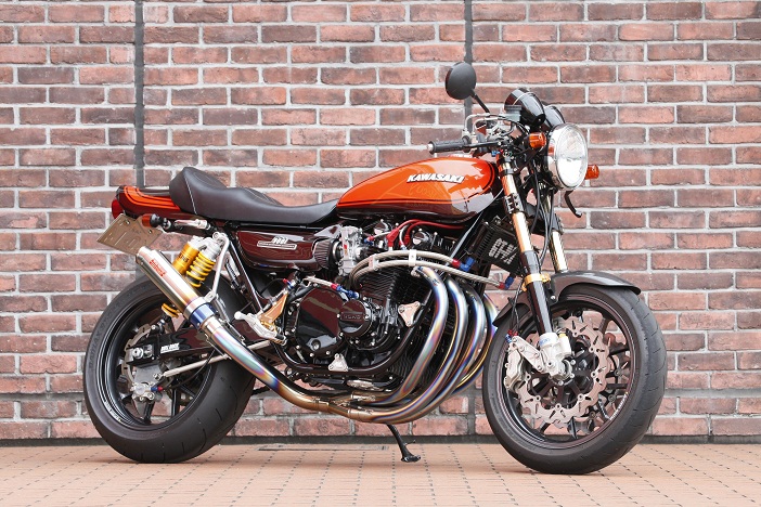

And this is similar to what I´m going for now...
