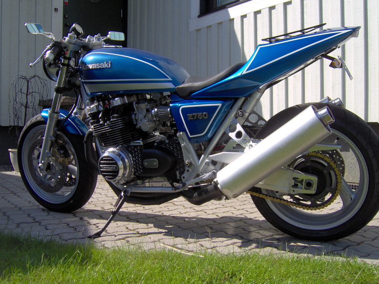

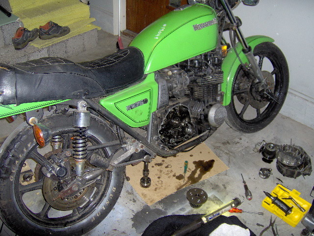

Here´s pic´s of before and after of my last project.
See next post..
Thanx a lof for all the info...it´s all good news !
I know it´s expensive but in europe a z1 engine can sell for $3000, guess there are less of them here than in the states. I buy a lot of parts on ebay and it´s a bargin even with shipping to Sweden.
I want the Z1 900 look on the bike, with the drop shaped tank. KZ1000 are more easy to find and cheaper but they have squared tanks and the engine isn´t that "exclusive" as the 900.
Yepp..the plan is to take the engine out, sell the chopper frame...punch in the Z1 framenumber onto a "original" frame, buy a tank, tail, covers and then put the suspension on from a Yamaha R1..
I´ll start a new project thread onec I start the build for real.
See next post..

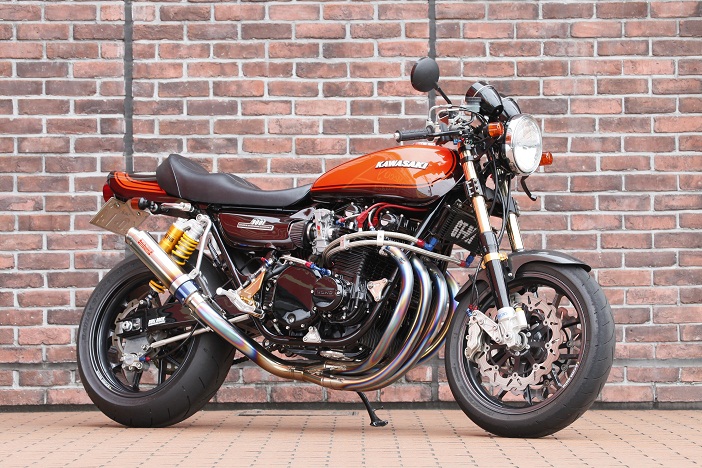

And this is similar to what I´m going for now...
