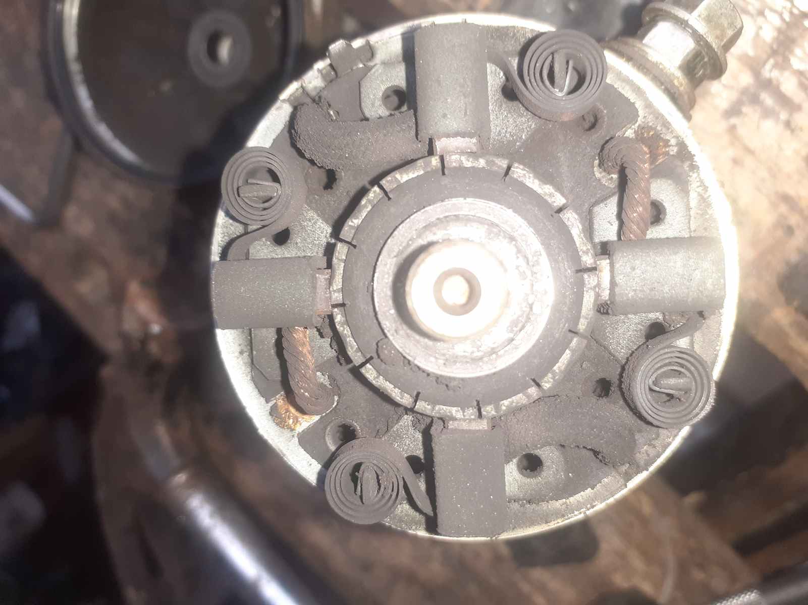

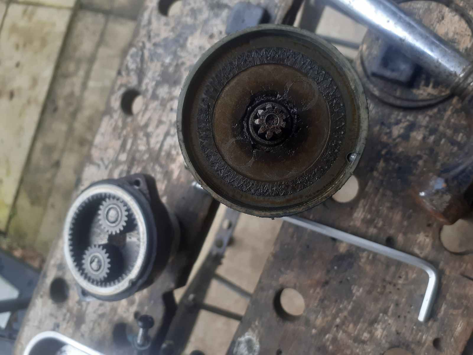

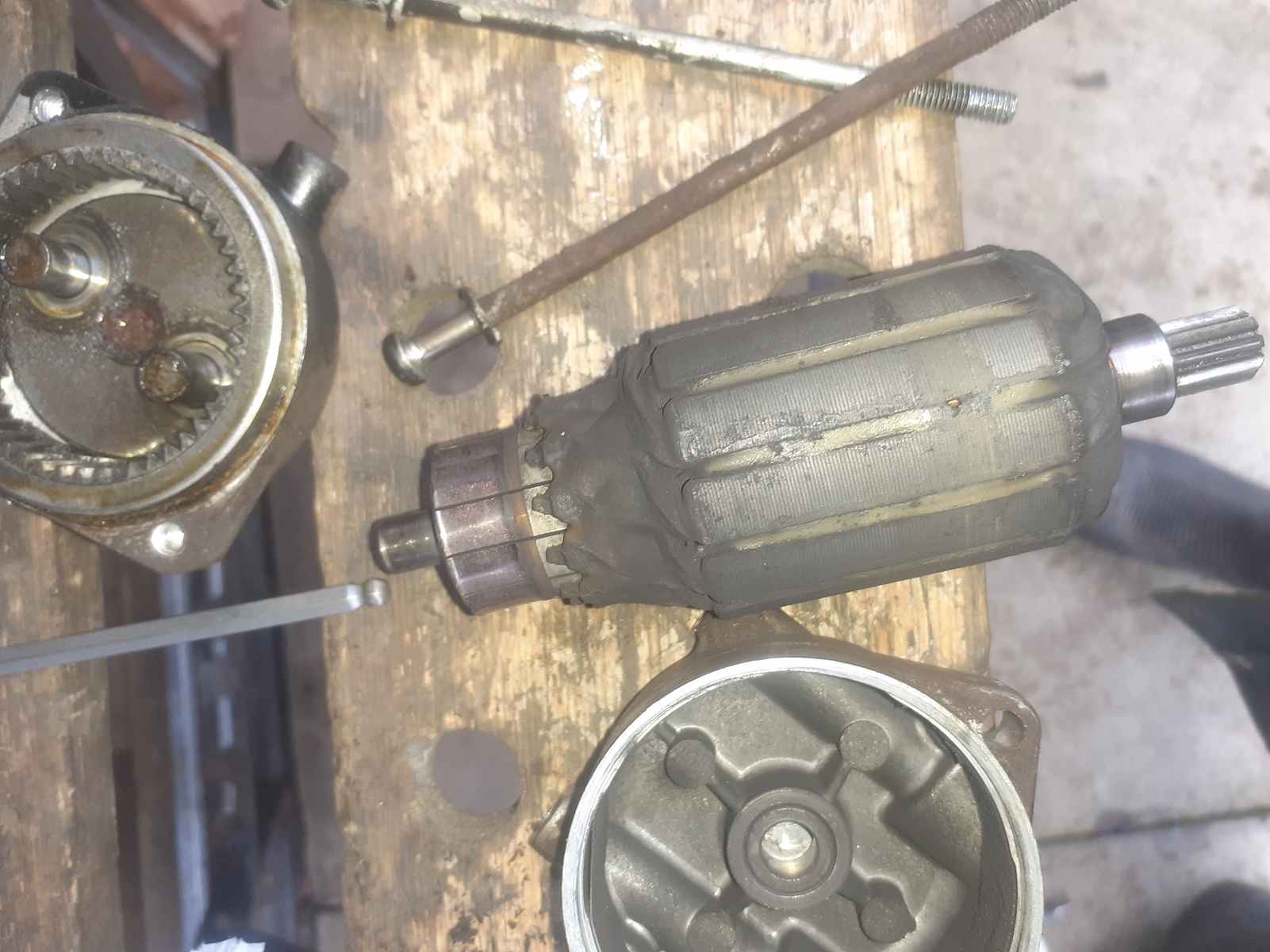

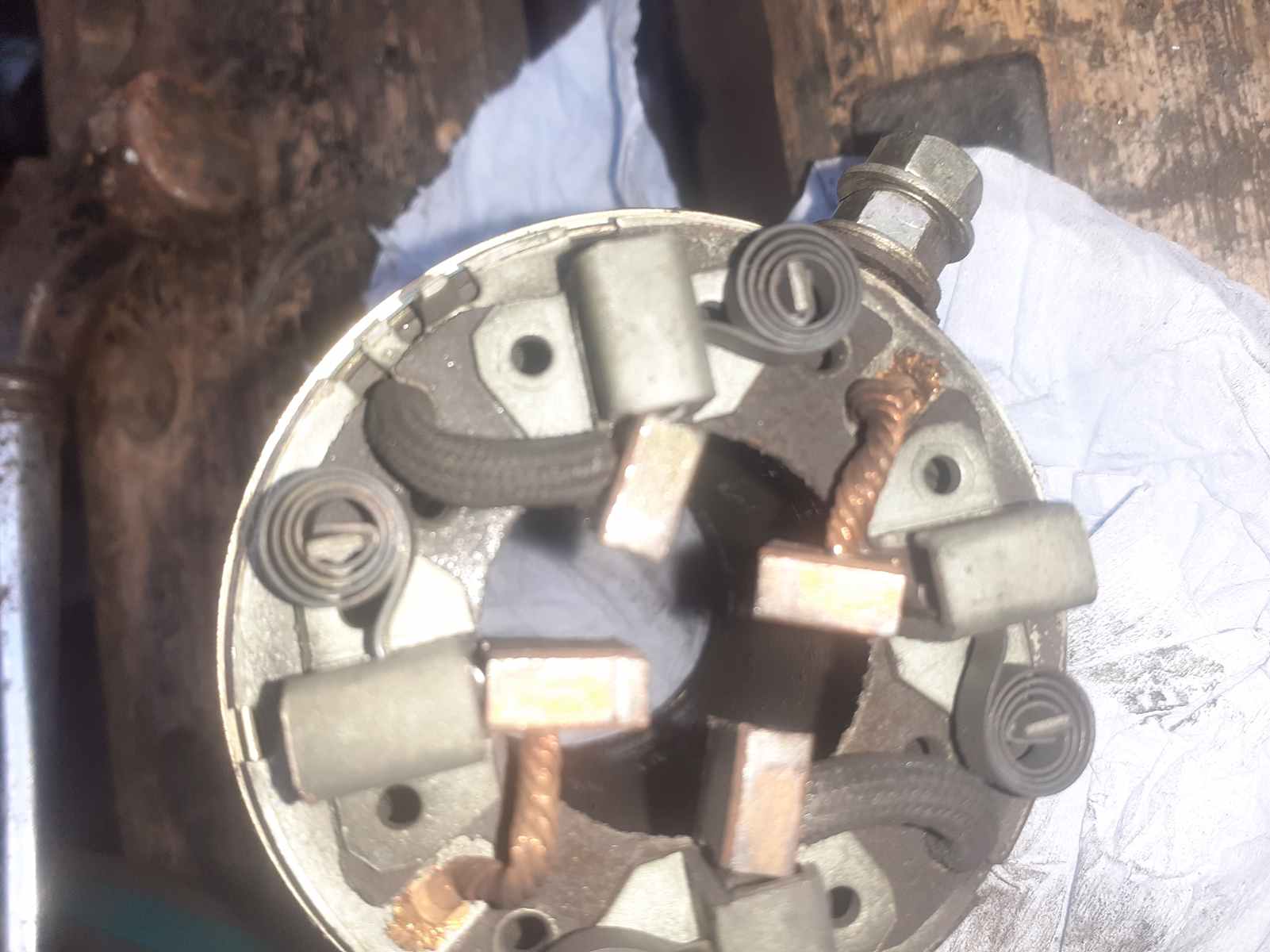

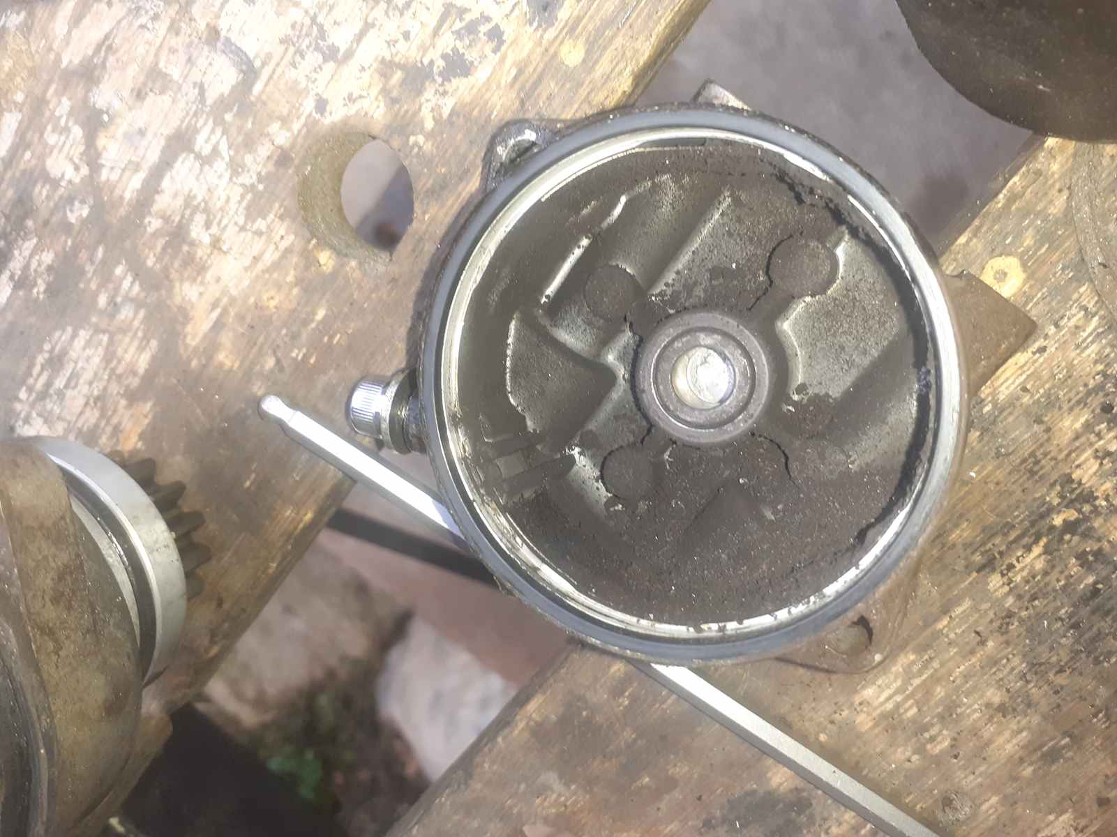

You may want to check your starter motor after 40+ yrs it may look like this, give it a clean & change the grease for the (planatery) gears could be like concrete
good luck
good luck
