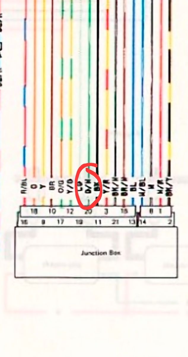

At a bit of a loss as I'm finishing reassembly, I have everything in the wiring harness plugged back together except for a single white/blue wire that goes to the junction box for accessory and a yellow/black wire that goes to the igniter. They both have a unique metal connector that I can't find anything it plugs into. The bike was running prior so I'm not sure if I misplaced something or what? Everything works currently except no start unless I bridge the starter and the headlight. If anyone knows what these go to would be much appreciated, I don't even see a white/blue in the clymer diagram

First image is the two without homes, the second is all the connections. Everything else is pretty easy to figure out since they can only go one way. The kickstand safety is bypassed because the bike didn't come with a switch for it
There's some sensors that I think don't work but those can be dealt with or ignored entirely so long as I can start/stop the bike and I have a headlight to ride with. One of those times where I wish I documented my take down much better but at the time of I didn't expect an issue reassembling it

The only thing left is gonna be why the starter button doesn't work. Continuity between red and red/yellow, 12v when leads are on ground and both sides. Continuity from button to starter itself

The previous owner crimped the brown and g/w together under the sprocket cover

meter the g/w wire at the junction box.
put your volt meter on DC V.
black probe on the G/W wire.
red probe on the positive battery post.
what is your voltage?
