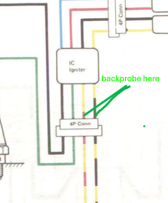

Ok, let's figure this out.
Grab your volt meter.
Put your meter on DC V.
Turn the KEY ON.
Kill switch set to RUN
Try to start the bike.
If the bike starts, let it run till it dies.
We can't find the problem if the bike is running ok.
When the bike won't start.. leave the KEY ON
kill switch set to RUN
red probe on positive battery post(post is the metal part of the battery)
black probe on negative battery post
What is your voltage to the tenth decimal place (12.3 instead of 12)
move your red probe to the yellow and black wire at the igniter connector
back probe that wire from the igniter side(do not disconnect the connector)
what is your voltage?
Voltage should be as close to 0.0v as possible.
Any higher than 0.5 then your ground connection isn't very good.
Move that red probe to any metal part of the engine block.
All points that are metal on the block should be 0.0v
Move the red probe to the green wire at the coil.
What is your voltage?
Red probe to the black wire on the other coil
Move your black probe to the positive battery post.
Put your red probe on the yellow/red wire at the igniter connector.
Back probe the wire from the igniter side.
Should be close to 0.0v
move your red probe to the yellow/red wire at each coil.
should be 0.0v
