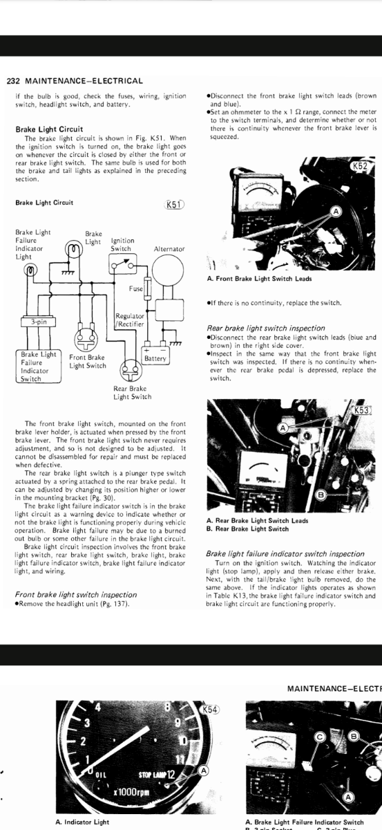

Searched the manual and didn't find a reference to 'bulb failure unit' anywhere, only a 'brake light failure indicator switch'. Is that what you're talking about? Cause I'm thinking I'll just replace that. I don't really ever ride at night so I don't imagine it'll ever be a problem not having the running light going but still would rather it be working.

29 Jun 2024 13:00Yes that is it - why do you want to replace it when it won't work correctly anyway, just disconnect it and call it "done". I take it you don't have "inspections" where you are, statutory lighting is a legal requirement here in the UK and EuropeSearched the manual and didn't find a reference to 'bulb failure unit' anywhere, only a 'brake light failure indicator switch'. Is that what you're talking about? Cause I'm thinking I'll just replace that. I don't really ever ride at night so I don't imagine it'll ever be a problem not having the running light going but still would rather it be working.

Well I could follow the manual to test if it's the switch that's bad, but I really hate using the fucking multimeter with a passion. Thing doesn't make any sense to me and might as well be black magic as far as I'm concerned. Guess I could pull the headlight bucket and just unplug it, to your point but would rather have it working.
