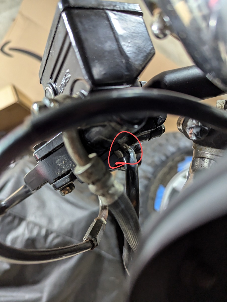

You are looking in the wrong place at the wrong thing, the below picture you posted has the answer for you !!!!!!!

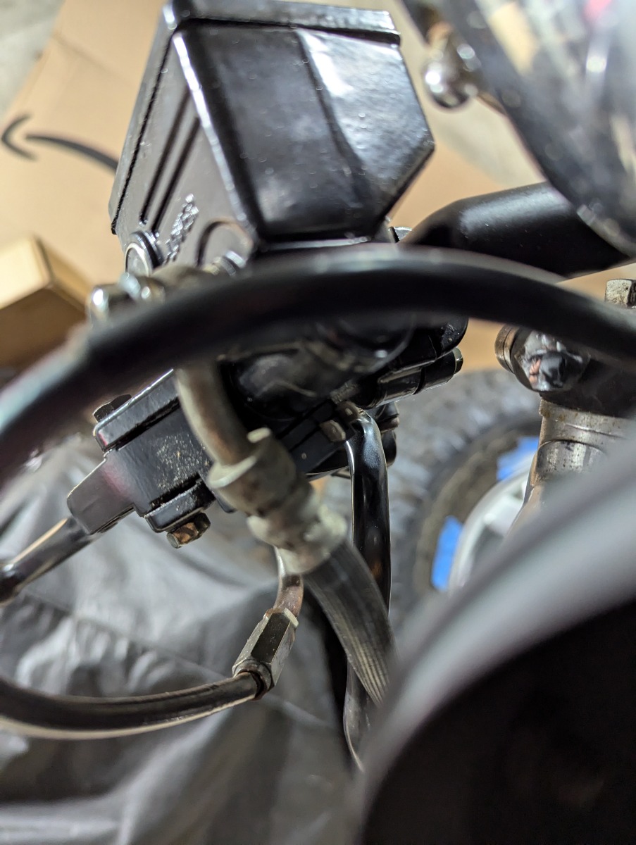

Thanks and so I should add the resistor to the circuit? They came with tap connectors and I'm a bit leery of using of as I'm worried they'll ruin the wiring and doing some searching it seems they may not be a great solution. Also I've no idea what's in that photo, I pulled it from the manual posted online and can't make out where on the bike it is or what is in the pic that's helpful.
Also what's missing that's meant to plug into the brake fluid reservoir?

No resistors, I will try later and sort a diagram for the "diodes" for the turn signal warning
Does the brake light work when you pull the handlebar lever? (If so nothing is missing)

Thanks, cause I'm not understanding otherwise. Also it seems this likely needed something plugged into it but can't find anything in the manual.

Does the brake light work from the lever ? (that is the brake light switch and should have 2 wires from the switch loom to plug into it unless it has a pressure switch in the brake line)

Believe so but will have to confirm later. Can see the brown and blue wires that I believe are meant to go to it go under the backside of the tank but can't see where they end up and didn't have time to pull the tank last night.

I am about 83% sure that all of the disc brake equippped KZ400s, except the 1979 KZ400H, had a pressure switch on the splitter. The 1979 KZ400H and the later KZ440s had the pressure switch on the master cylinder.
Your signature line says yours is a 1976. Since it has a front disc brake, it would be a KZ400D, which should have a master cylinder with a round reservoir, and a pressure switch on the splitter.
www.partzilla.com/catalog/kawasaki/motor...cylinder-76-77-kz400
Evidently, yours has a later model master cylinder from a KZ400H, or a KZ440, with what is now a redundant pressure switch.

Believe you're right that it's a kz400D, as it's got the disc brake and electric start. Bike definitely wasn't 100% original when I got it but pretty close so maybe that was already swapped? Is that something I need to replace to fix this problem?
