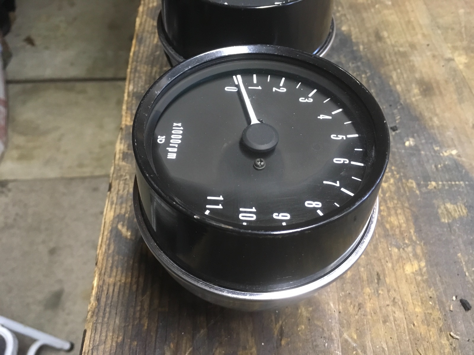

Re: Reproduction speedo OEM replacement
28 Dec 2019 21:22
#816050
I know the tach has a fluid damper... See photo of mine... I assumed the shading was sun fade, but asphalt900 told me it was fluid that had leaked out of the damper
