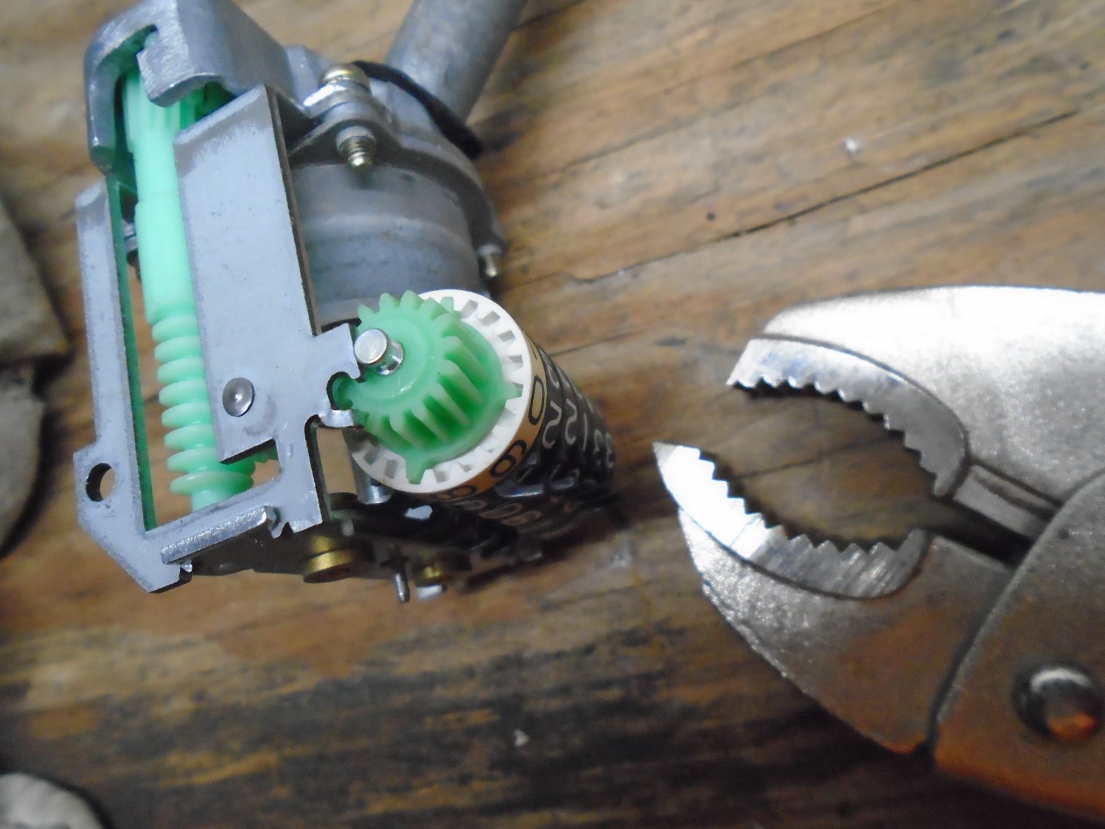

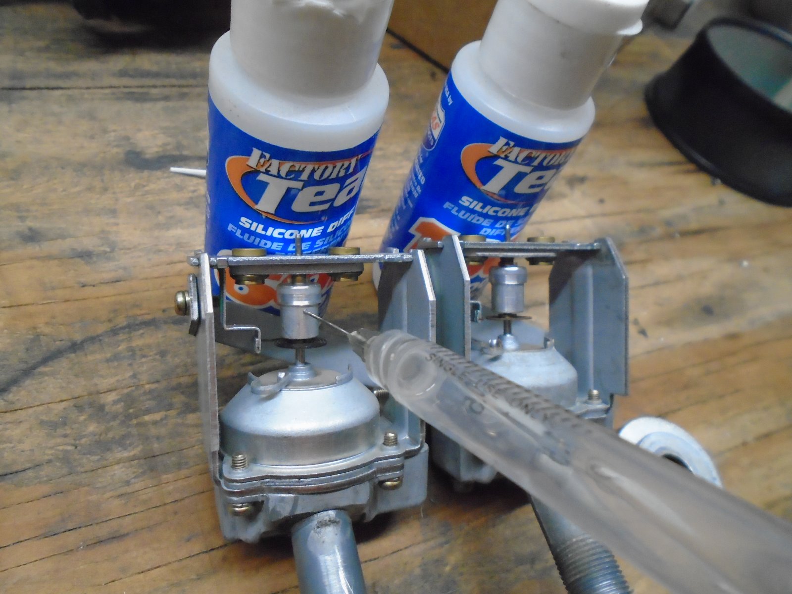

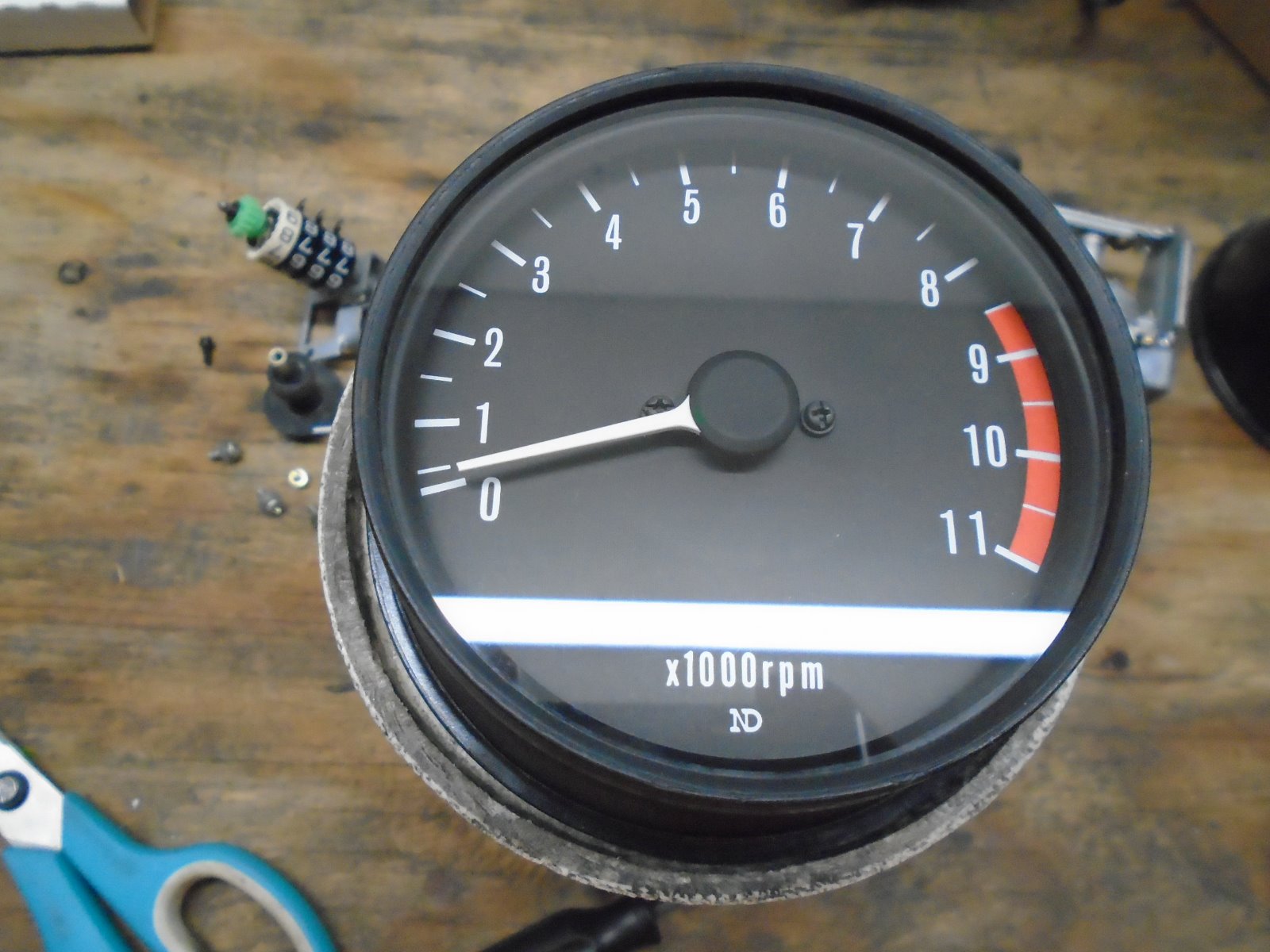

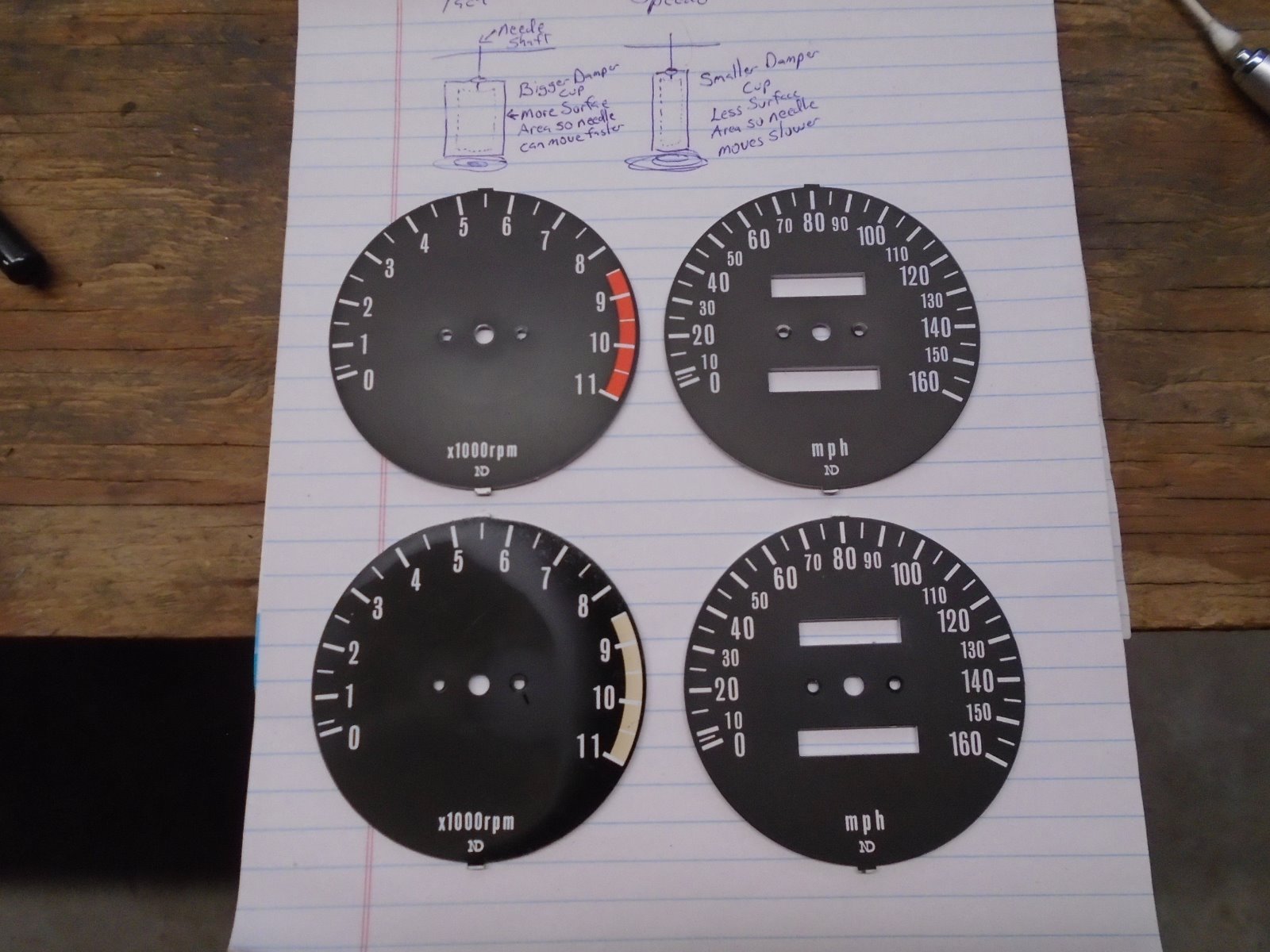

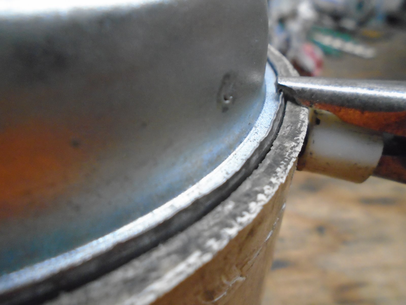

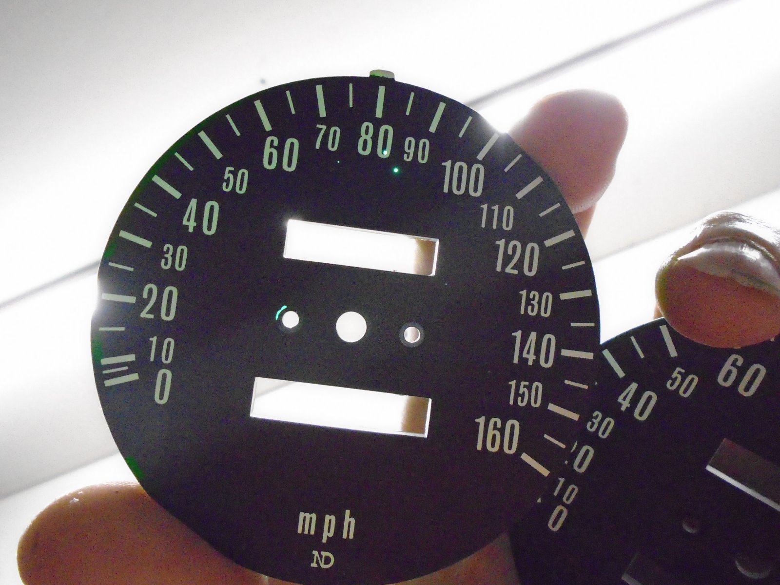

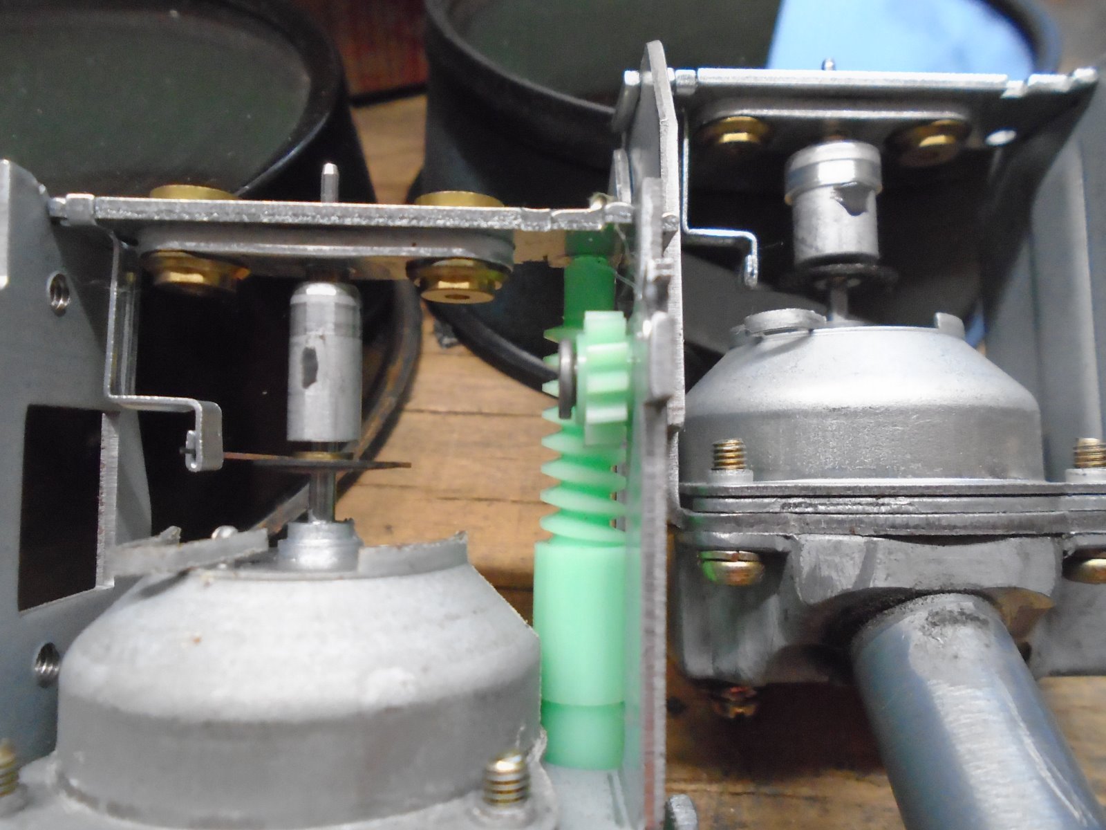

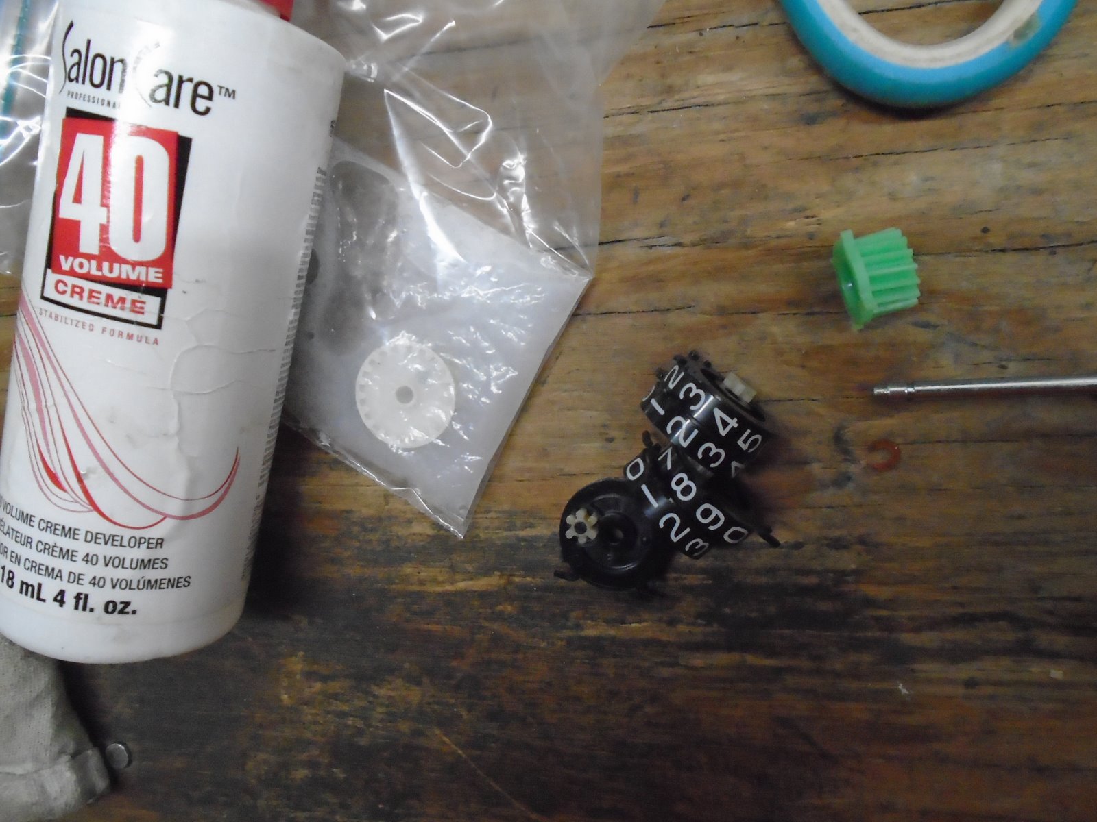

Here is some stuff i'm doing to Mikaw's gauges. Refill damper cups and product used, I use, and some info for others that might find it interesting or useful. More photos will be added, cannot get them all in one reply. These suffered from damper fluid puking, bad storage. Some pinhole pitting of silkscreen, allows light to shine thru when ridding at night. Note these are Used OEM faces. Hand re-painted redline on tach. And mileage register removal to whiten-up the 1/10th mile wheel.

More photos of what you will encounter if you are a DIY type.
