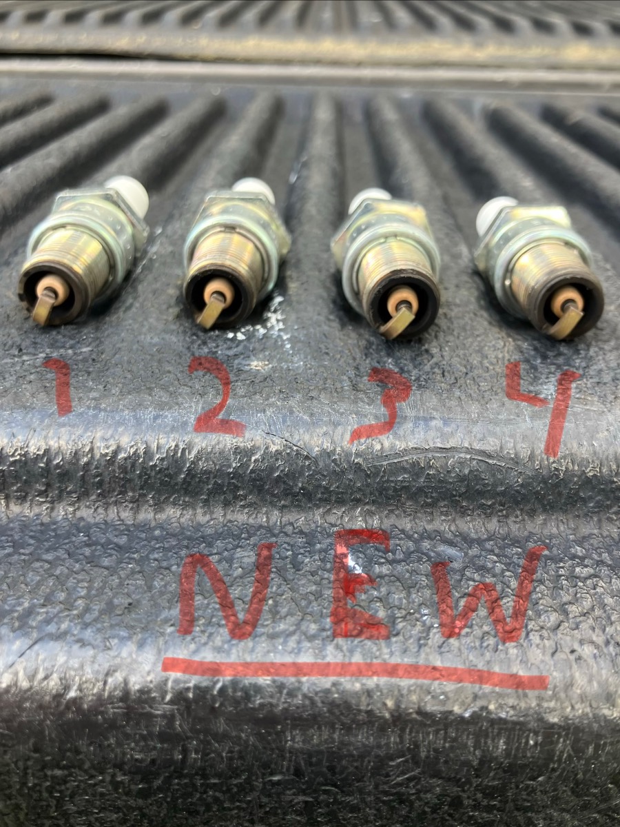

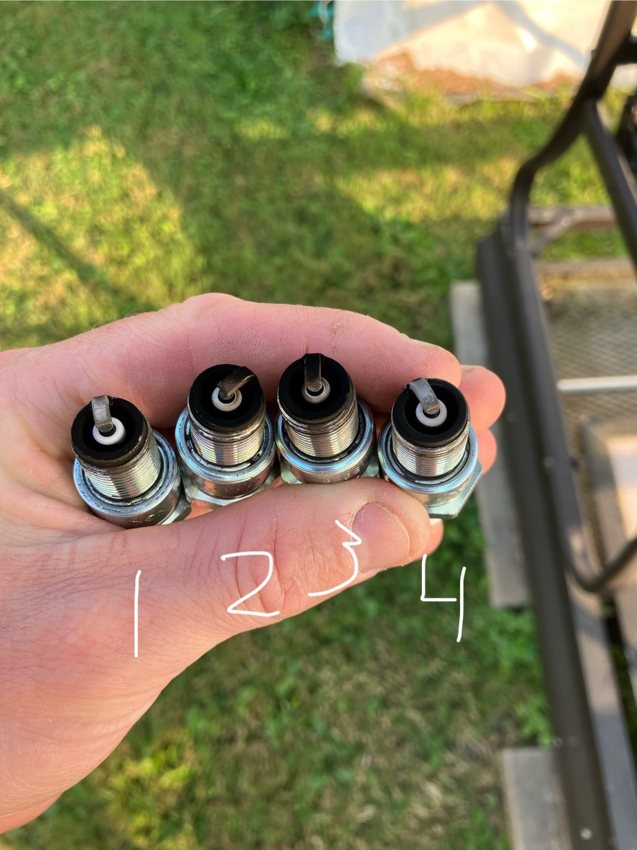

I saw 12-12.5afr on cruise 1/8-1/4 and 13.5 1/2 cruise on flat road. My idle is now at 13.3-13.6. What are you thinking?

I don't think it's a coincidence that the sooty plugs in your first pic (2&3) are fired by the same coil and pick up ?????

I have the same coil!! New real KN pod instead of ebay one.. so weird.. what about color ?

15 Jun 2026 14:12colour in the second pic isn’t too bad, don’t forget the coil is only as good as the pick-up and igniter that trigger itI have the same coil!! New real KN pod instead of ebay one.. so weird.. what about color ?
