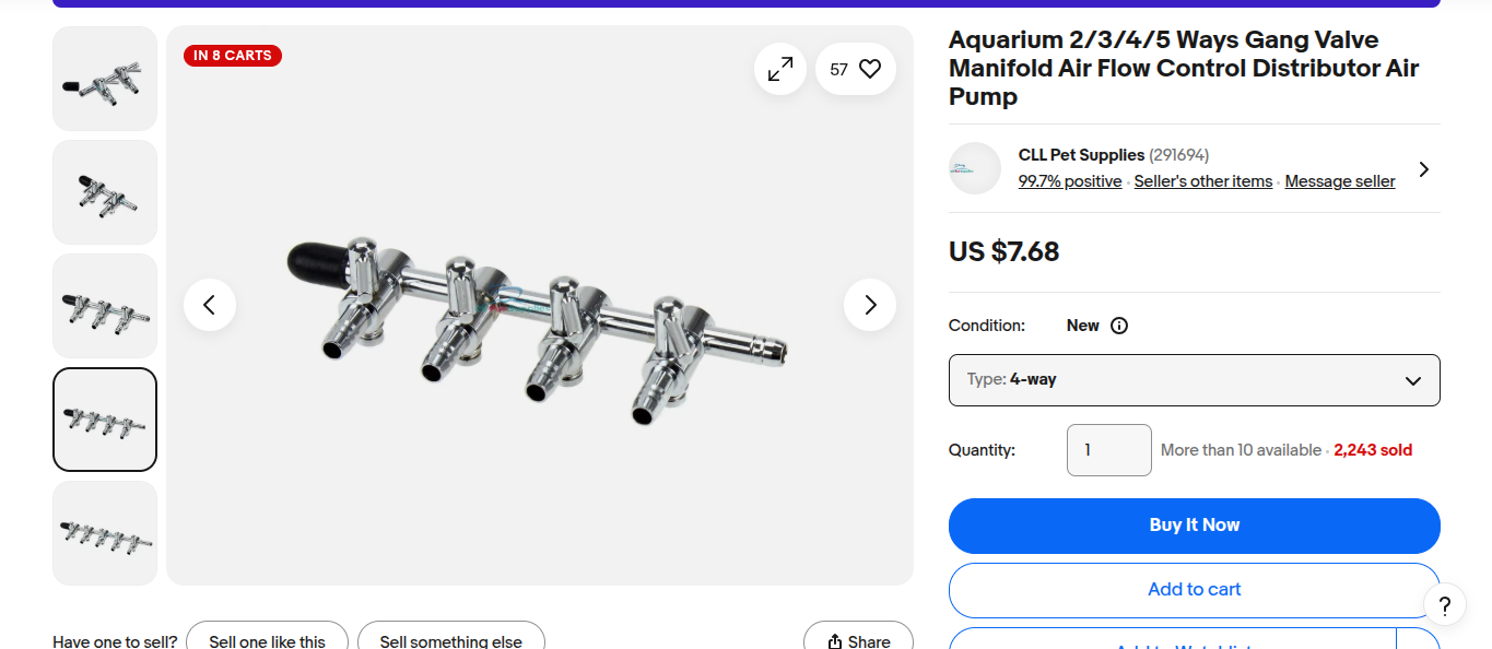

Back in the day, before I had carb sync gages, I would use an aquarium pump gang valve connected to an automotive fuel pump/manifold pressure gage. Since adjusting one carb has an effect on the others, and you could only see the effect on one carb at a time, It took a lot of jumping from one carb to another, but in the end, it got then synced.
