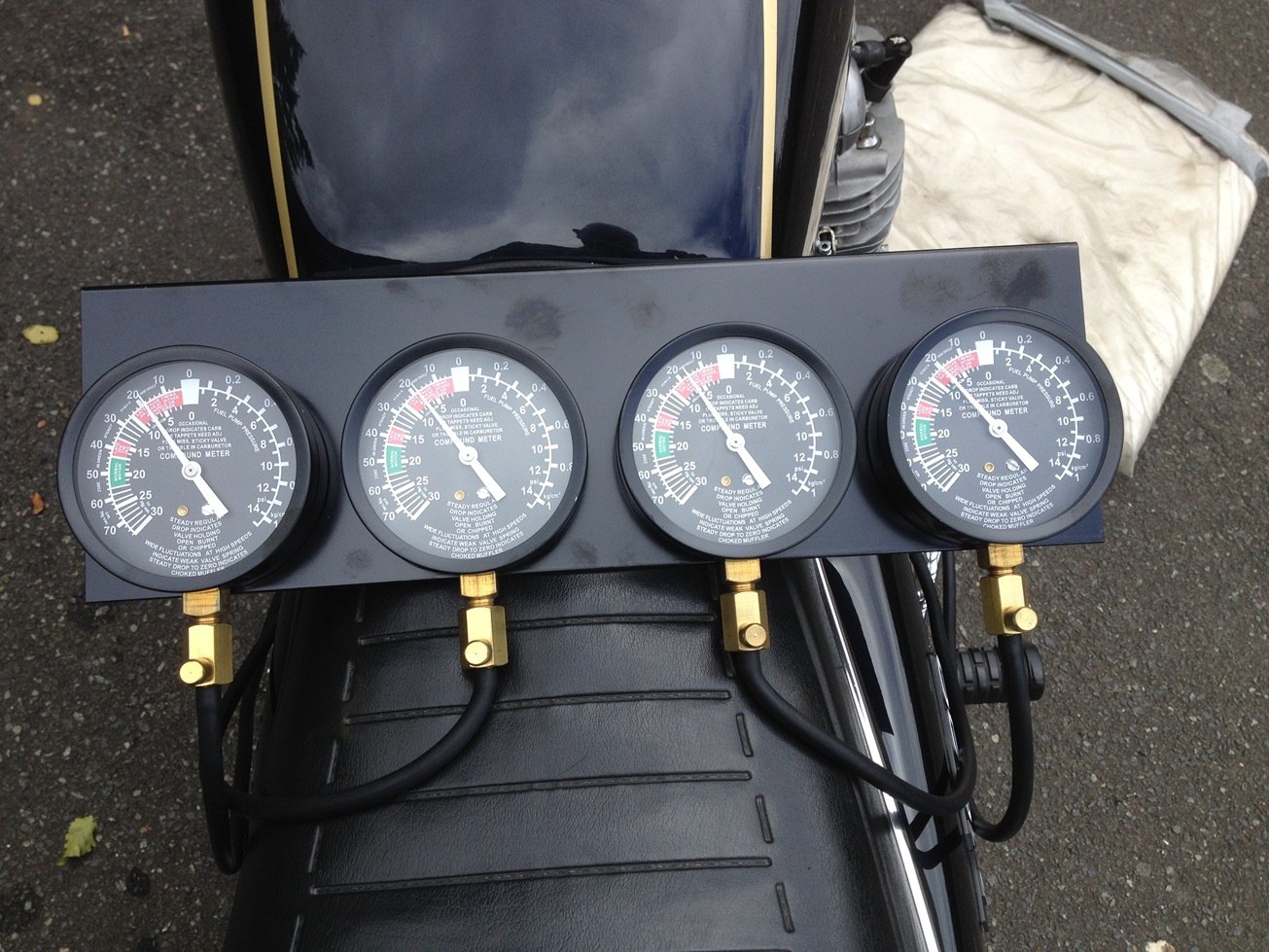

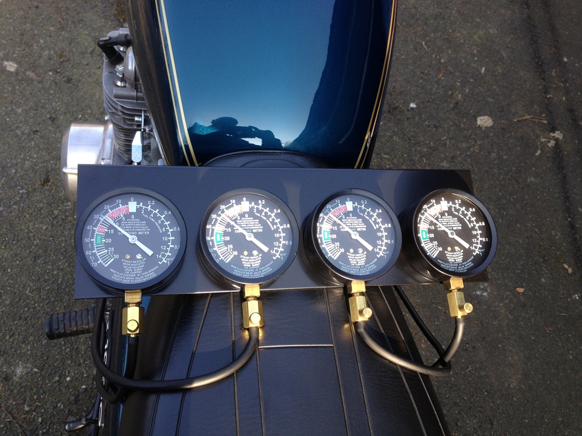

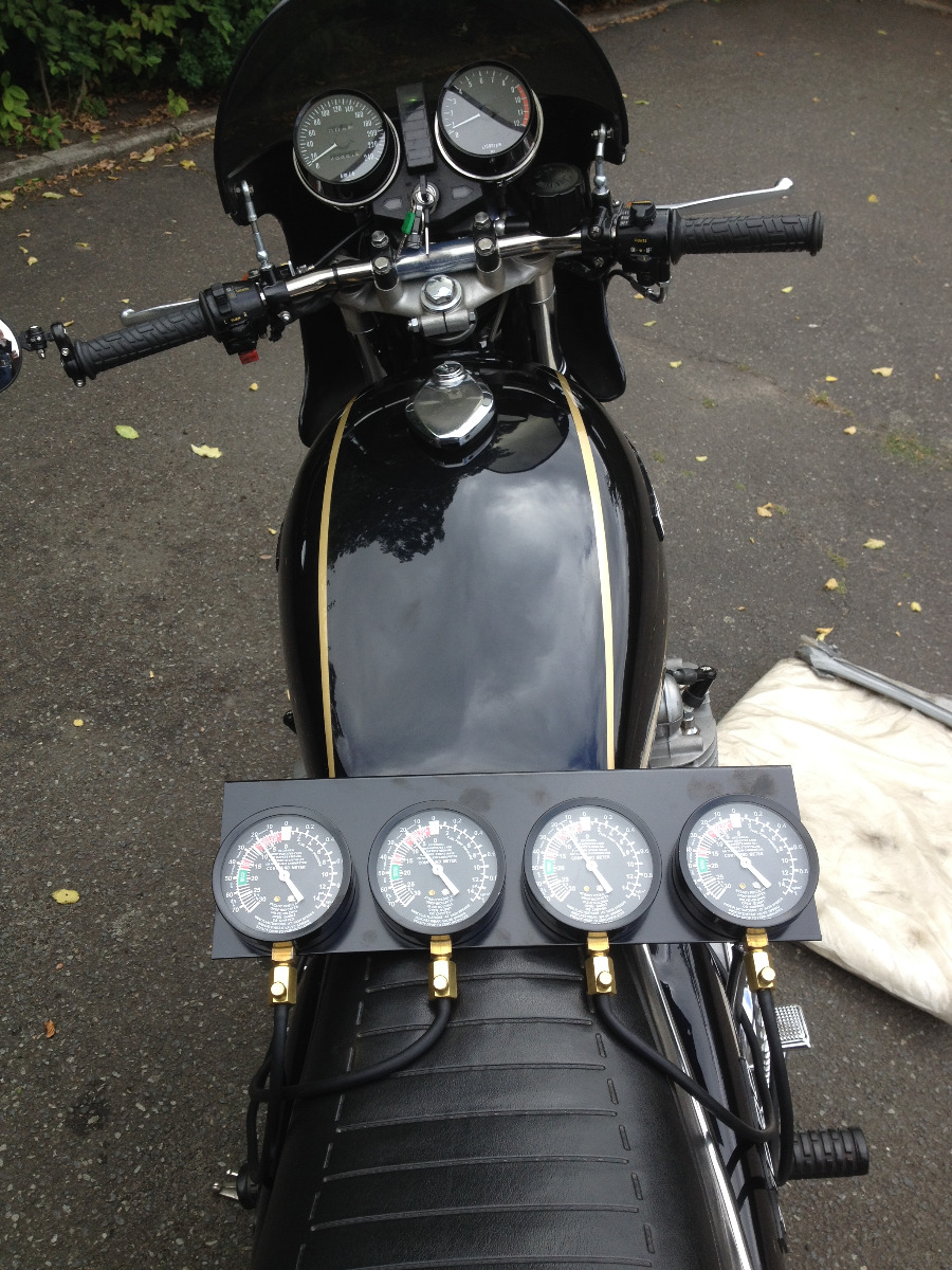

I have a "cheap" 4-clock synchronous tester for two years now, and I'm very happy with it! - (It works just as well in terms of display and sensitivity as my long-used, high-quality BOEHM 4-clock tester, which I had for 25 years...).. The pics shown while working on both Z1000 bikes.

I've a "Motion Pro stick style" i've had for years. As well as the ole Mercury sticks, still have a glass tube NOS one down in the outbuilding. The Morgan Carbtune is a Nice one, never owned one Though. Sorry Kofla, those Analog individual gauges can be a bear and come with calibration issues. Some have removable lenses to set the needles but that's often only in a "certain" range of vacuum. Of course some gauges are Much better then others but Steer Clear of those Blue backplated Amazon units, they are crap. I have a set i will give you, they are just that bad. A kid gave them to me years ago and just threw them in a box.
