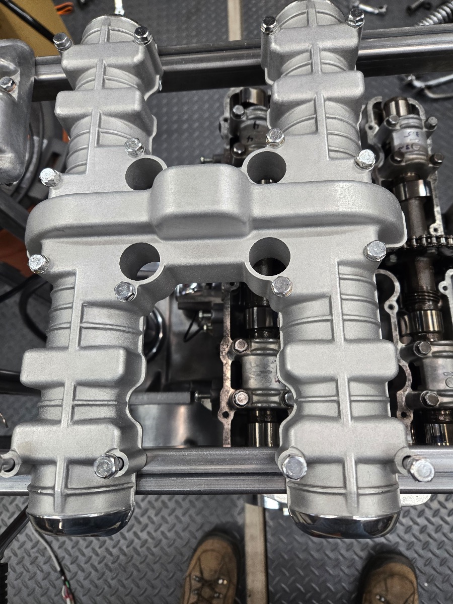

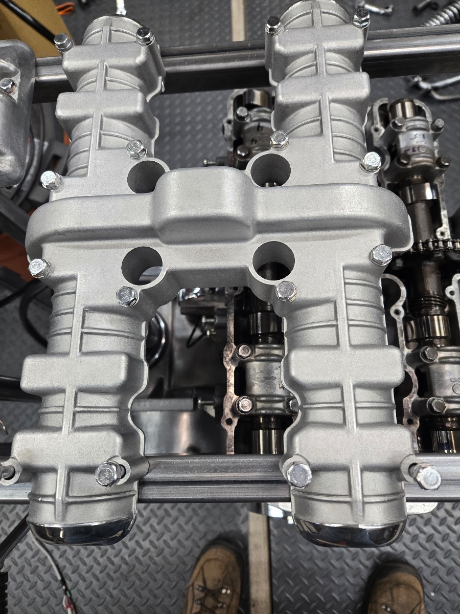

15 Nov 2024 08:36Speaking of wired shot that is what I use in my blast cabinet. I clean my cases and other parts with it. I love it compared to using glass beads. Is use SS cut and conditioned .016 wire. After years the cut wire is getting to be like the conditioned wire and leaves a nice finish.
as originally finished.

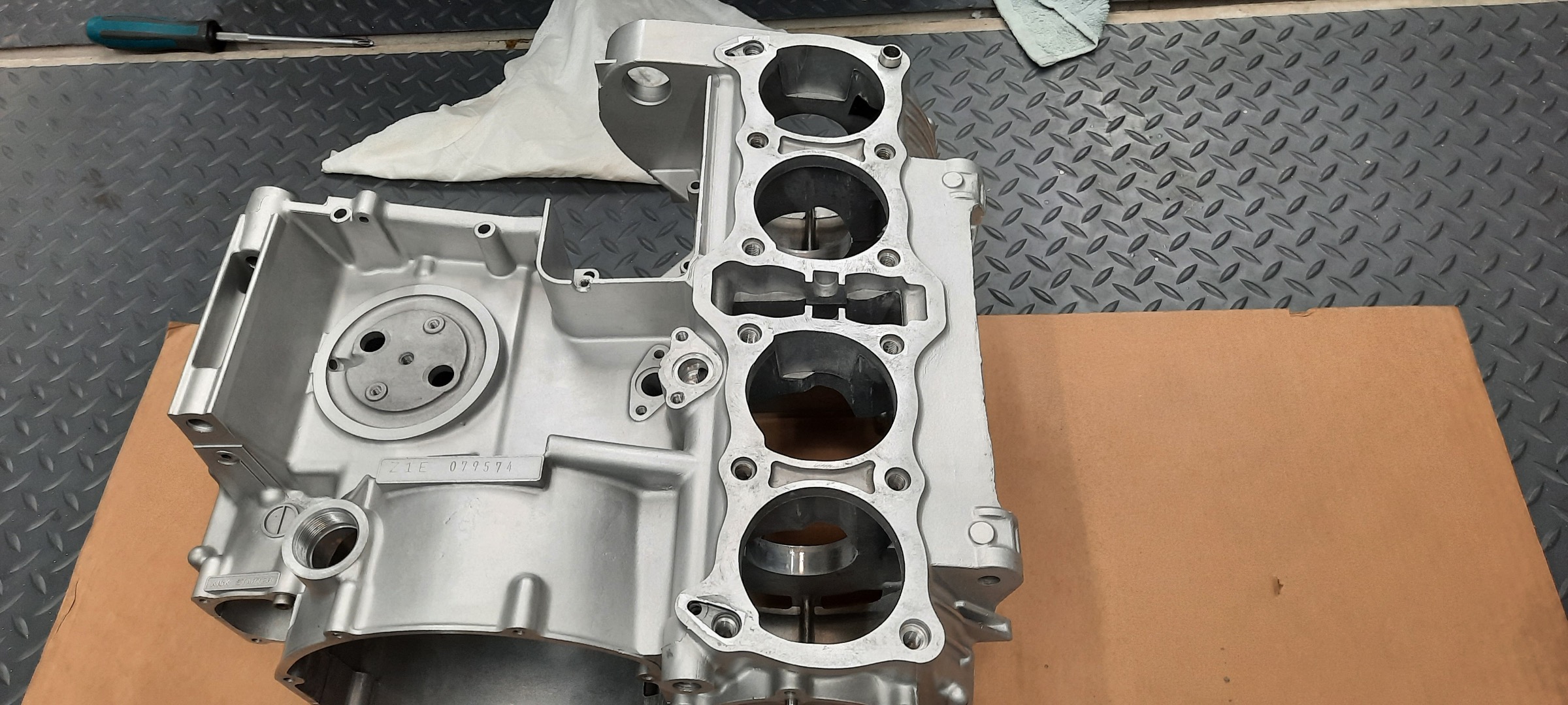

So my method for cases is blast with std cut if the cases are heavy stained or corroded. Then I change to the conditioned cut and hit them again. Then I wash in hot soapy water with a heavy dose of Dawn and gently scrub with 0000 steel wool to further smooth the surface. Doesn't take much with the steel wool but the more you scrub the closer it gets to that vapor blast finish. it produces a finish that is almost as good as vapor blast but I have saved a few hundred bucks. I must add you should plug all threaded holes or use a bolt in them. I also tape off surfaces that I don't want blasted or have oil passages. I only blast the outside of the cases anyway but you really don't want media items in there. The media is 314 SS so is slightly magnetic..

I use plastic containers to keep the used media in and have one for media that has been mixed over time. After so many years my cut used media is pretty rounded and gives a pretty good finish on its own. This is a cover just done and was very stained
