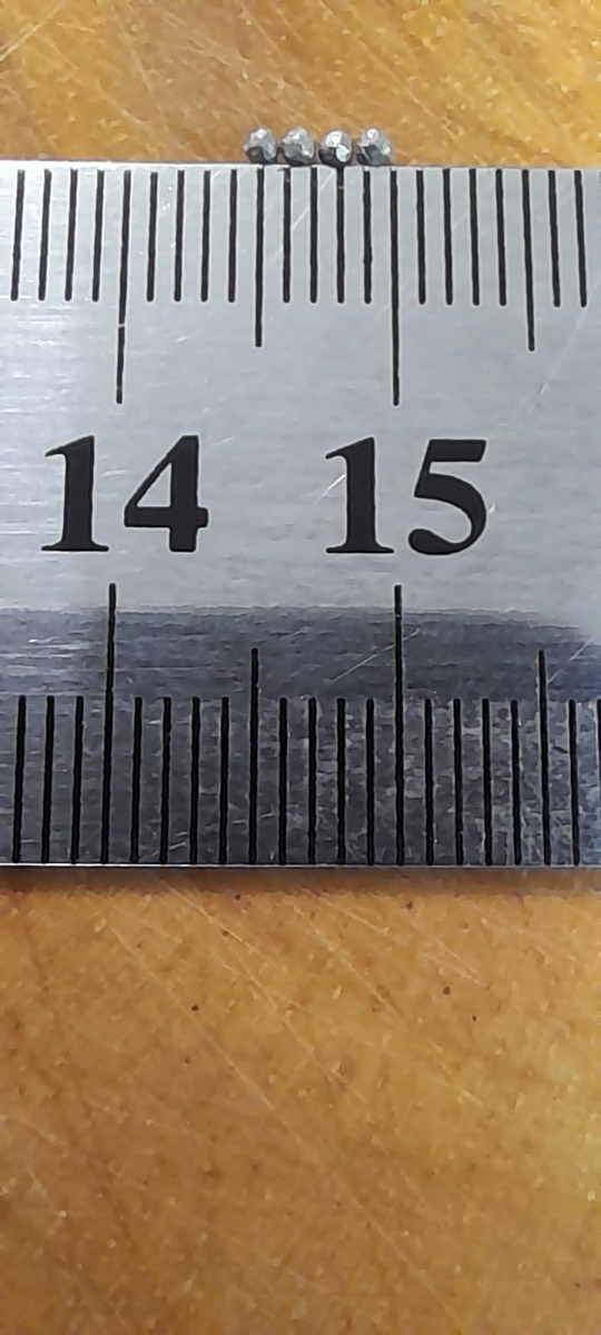

  Has anyone had these come out of a carb before, these dropped out of the drain of number one carb last week, they are aluminium and have multiple uneven facets/impact marks on them, I got a set of mk11 pumpers a couple of years ago that had never been apart, still had the yellow assembly paint spots on them, I stripped, sonic cleaned and replaced all rubber parts, gaskets and a couple of bits of brass that were beyond redemption, while stripped as stated sonic  bathed blown through with brake cleaners and finished with air, slides had absolutely no wear, been running them for a couple of years and drain the bowls off periodically,  a couple of weeks ago these dropped out of number one, bear in mind they cannot get in the bowl through the float valve as they are just over a millimetre accross, I am assuming they are polishing beads from the original production line, where they were hidden up is a mystery to me, any ideas, there is no chance they have got in there in my care as I have nothing like this or blasting equipment.

Not the check balls as they are stainless steel and are too large to go through any passageways, the facets on their surface kind of dictates they have been blasted at a surface, i crushed one with a screwdriver blade, I also tried to melt it with a soldering iron to no avail dispelling any idea that it was lead or solder. It appears I am at an impass,  the carbs are working correctly and very well, such a strange find.

The brass and check balls are all in place,  the balls in picture are aluminum and are not check balls they are just over 1mm, check balls are around 3mm and steel and would not end up with the facets.

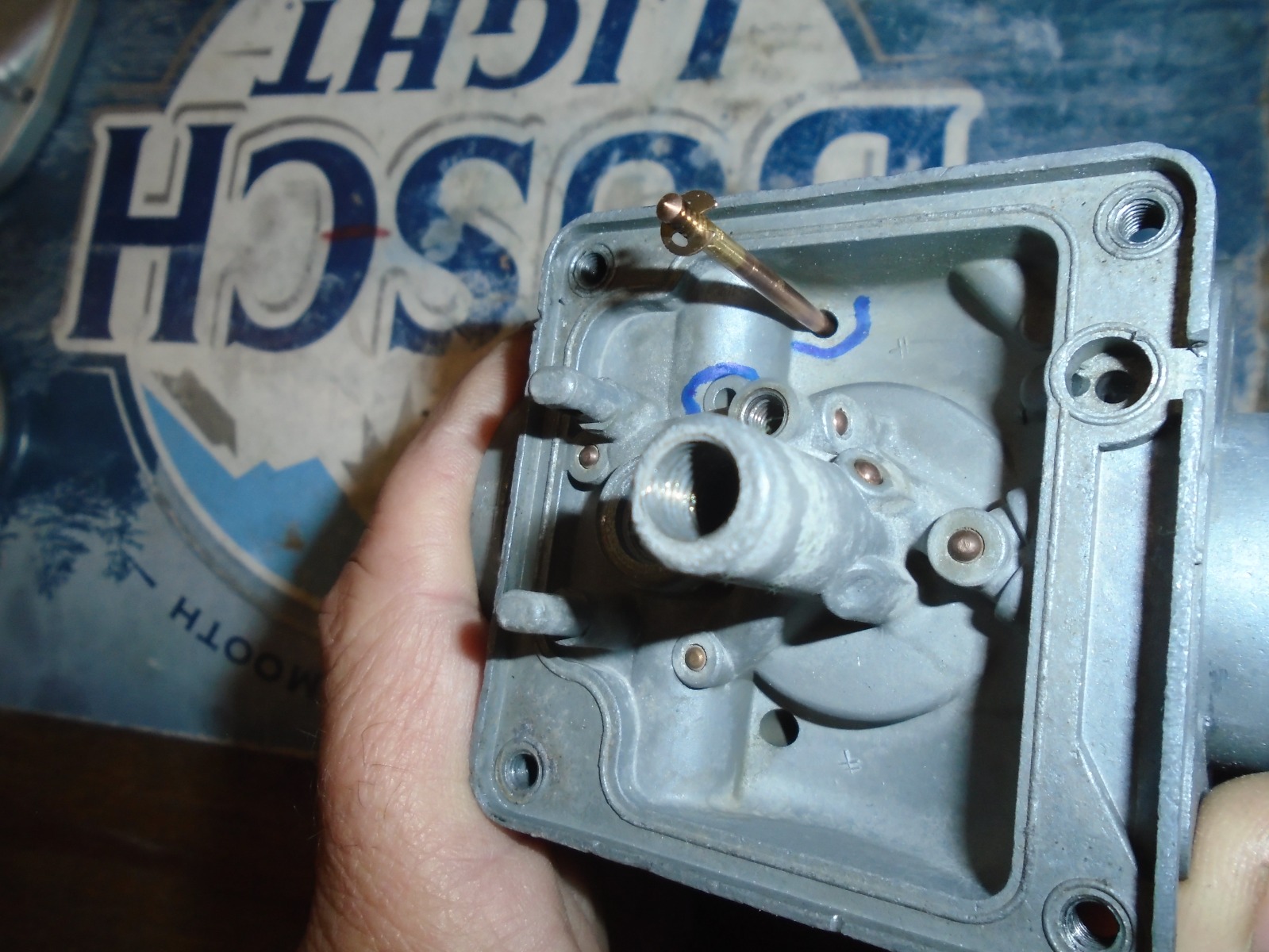

If alien balls are that small Texas we shouldn't have to worry about an invasion, at least the women will be safe. I've never encounter anything resembling something like that either?? But always check the carb casting blind holes. These are passages formed in the molding/casting process but never used. Junk can get wedged up in there only to come out at a later date. A similar VM carb passages shown. I have a sonic cleaner but rarely use it, i mechanically clean all the ones i do. Then solvent/water high pressure out all the debris.

My conclusion is that these have been in the carbs since fettling in the original foundry, they are conditioned cut wire shot, I found out about these by looking on line and they manufacture them still.
