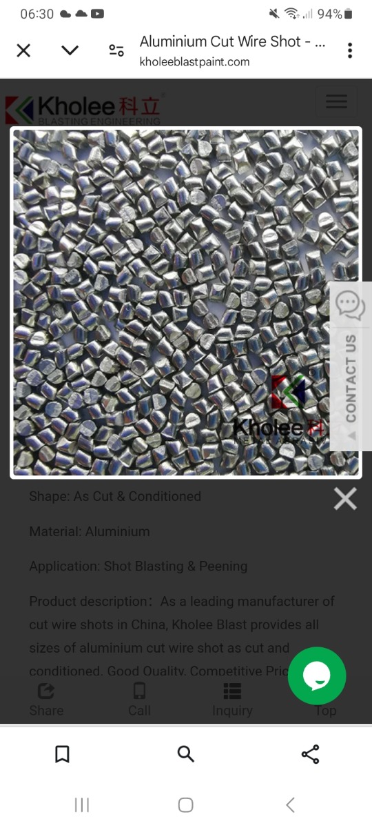

My conclusion is that these have been in the carbs since fettling in the original foundry, they are conditioned cut wire shot, I found out about these by looking on line and they manufacture them still.
Last edit: 15 Nov 2024 00:44 by kevski. Reason: Grammar correction
