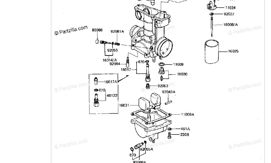

The two center carbs were missing the "KAWASAKI OEM NEEDLE JET#V95".
Once in place it runs on all four and idles fine. Today is a good day!

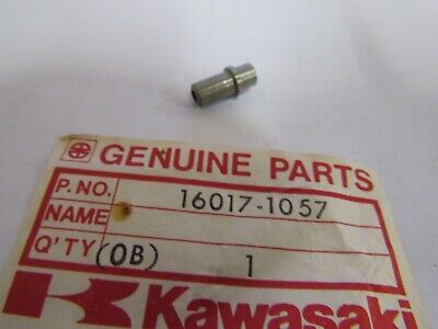

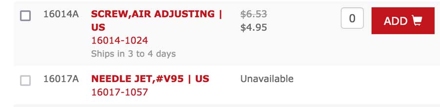

Ness. Calm down--you do see that Kawasaki refers to THIS part as the needle jet #V95. Right?
It's the very small piece at the top of the main jet.

Are you still speechless after you look at the part number and the picture?

First of all, I have no idea where you live, because that information is not available in your profile. For many parts of the world, the Needle Jet is code 16017, not 16017A. But regardless, how does someone leave out critical parts of the carbs on two carbs, but install them on the other two? Oh, never mind.
PS: I wish I had a nickle for every set of "clean carbs" that were actually messed up. I've seen this so many times, it's my default. But saying anything, puts the OP on the defensive.
