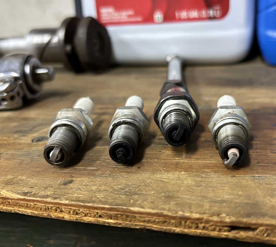

pic of the plugs after a few miles of rough riding.

The 2/3 spark plugs looks like runnig very rich on fuel.
A weak spark (low voltage coil = un-burnt fue)l can effect the same.
