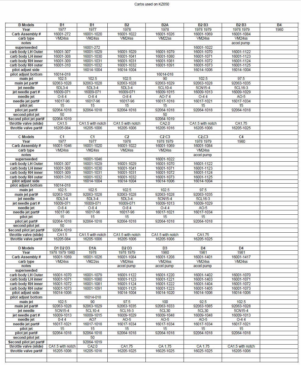

Depending on model the needle jet varies from a 0.8 to 0.4
Here's a chart to help identify which carbs you have in case the donor carbs were a different spec but every set that uses the 5DL3 needle matches with the 0.8 jet as you have so that is correct and i would rule that out ..

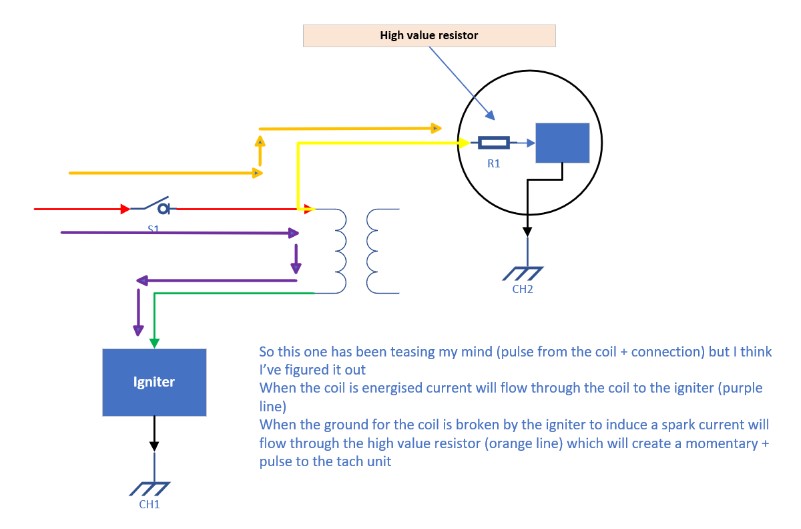

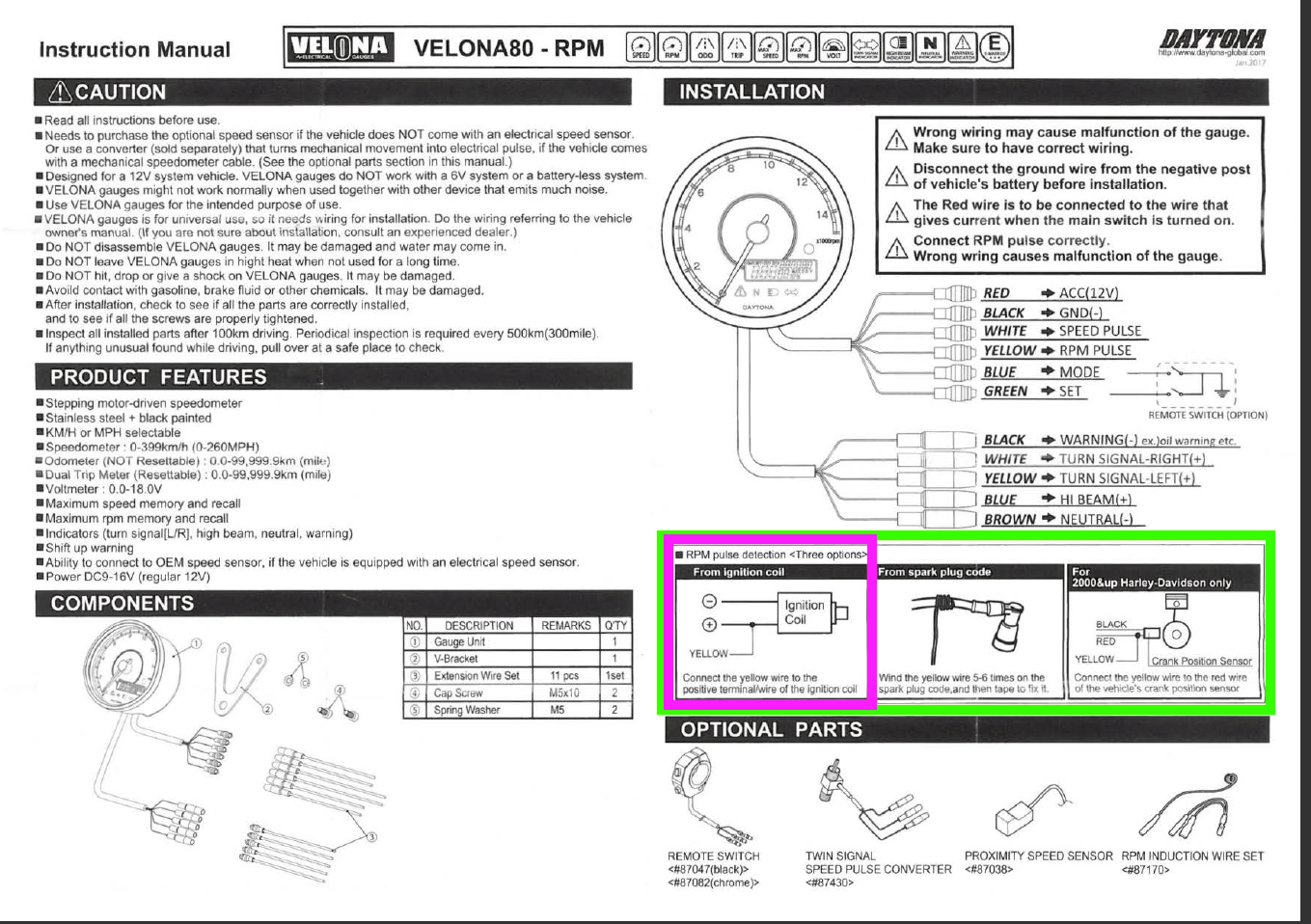

Maybe I will switch from black coils (Dyna 5Ohm) to the green 3Ohm because I have them in the rack.
Interesting, Dyna ignition occur to interferences to my Daytona speedo. RPM indication is little jumping at 5k.
