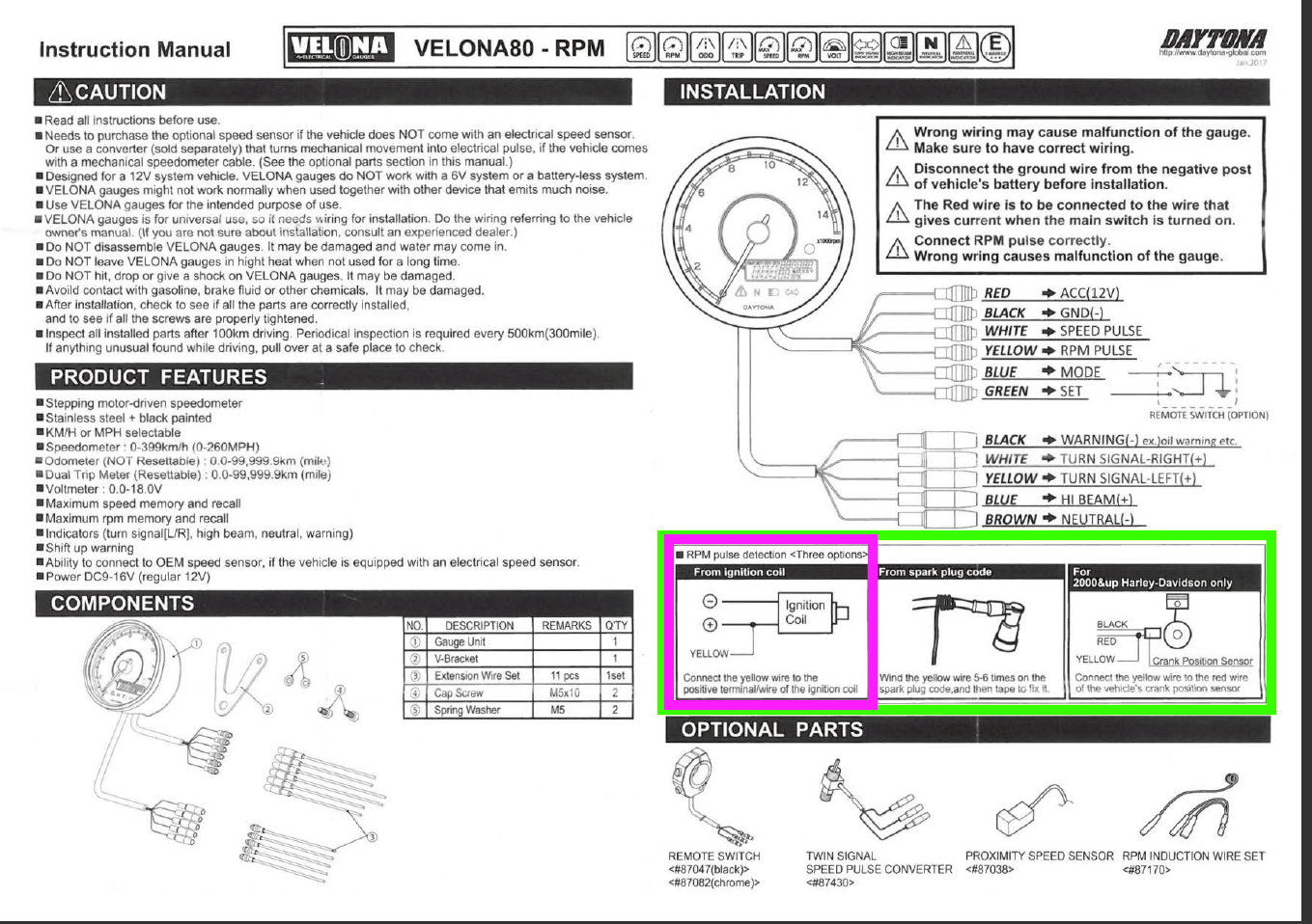

Wookie mentioned your shift light.... How did you wire up your shift light?

20 Jul 2024 01:04Tanks and sorry, have overseen your post.Have you tried disconnecting the ignition pulse to your "shift light" ? (it is possible that there is a conflict between the ignition module and the shift light circuit ?)
Have thought about that but there is no direct link between shift flash and ignition. The speedo is simply connected and get rpm from positive wire of right coil.

Disconnect that tach wire and take it for a ride.

20 Jul 2024 09:47Makes sense. If it's robbing one coil of even a little power the bike won't run for SHT.Disconnect that tach wire and take it for a ride.

20 Jul 2024 14:20That doesn't sound right, the positive side is a constant ignition live, surely the tach pulse should be on the switched side of the coil ????Tanks and sorry, have overseen your post.Have you tried disconnecting the ignition pulse to your "shift light" ? (it is possible that there is a conflict between the ignition module and the shift light circuit ?)

Yeah, Wookie it's a weird one. I tried to find the installation instructions last night. It has a positive coil wire tie in.
I'll dig up the instructions and post when I get back home.
photo: W&W Cycles

Thanks guys for thinking over the electrical thing.
Just tried with complete unplugged tachometer. No change at all…
