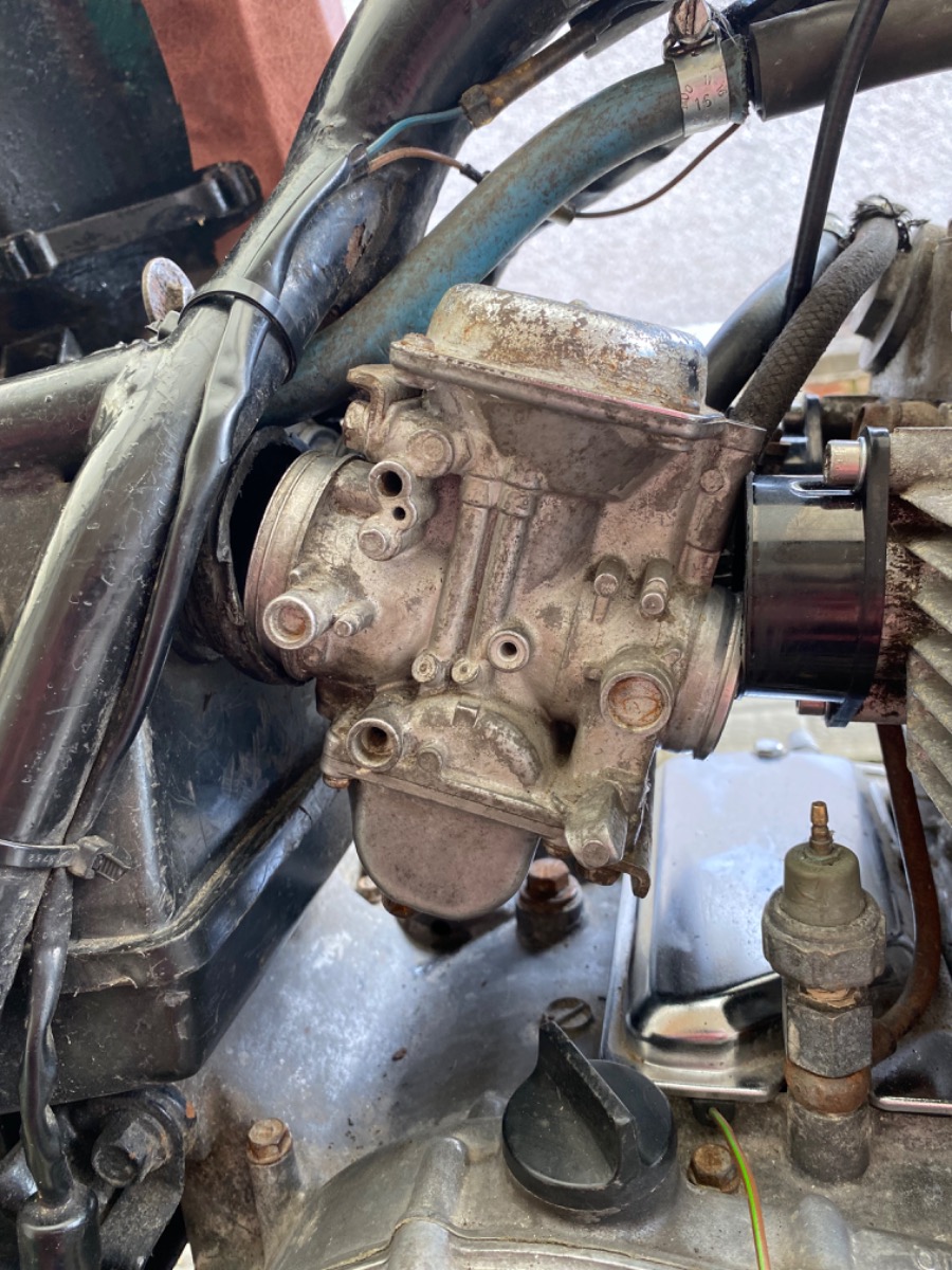

On the advice of a Kawasaki engineer I replaced the manifold carburettor boots.
notwithstanding the difficulty in both removing and replacing the carbs, the idle speed is now over 5000rpm. The engineer warned me this would happen however loosening the black thumb-grip idle adjuster screw underneath the carbs right off, the high rpm remains.
prior to the removal of the carbs, it idled around 700 rpm.
the engine certainly runs better in gear but Boy! After one mile the exhausts were red hot.
there is no slack on the throttle. As soon as I begin to turn it, it revs. At the very least I need to introduce some short slack there.
im now having a brain freeze. To reduce the idle speed, do I need to adjust the throttle cable adjuster to effectively make the outer cable longer, or shorter? There is very little room to make it shorter.
I am loathed to remove the carbs again. The gap between the engine block and the plastic air box behind is so much narrower than the width of the carbs with the manifold boots on. I followed the service manual instructions to the letter and it was brute force to both remove and replace the carbs.
advice gratefully received.

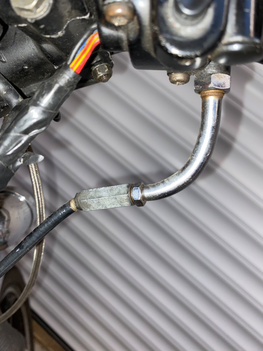

First at all your throttle cable and RH control switsh wiring looks like under permanent tention (higher/wider handle bar).
Do you have any slack or play in throttle grip, if not adjust the cable adjuster screw if possible?
It could be a sharp bent, knick or rust build up that stiffen the cable movment. A good cleaning and some drops of oil on all moving parts do sometimes wonderful thinks!
I don´t see any hose clamps on the airbox to carb and carb to intake boots side! So your engine is runing lean and hot!
After this the carbs need also a static/vaccum sync to balance the the carbs butterflys to the same amount of air/fuel for a smooth idle.

there was never a spring band on the air box side of the carb. The clamps I removed from the intake boots were huge. I’ll order replacements. The fit without the clamps is better than the perished originals.
I have no slack on the throttle grip.

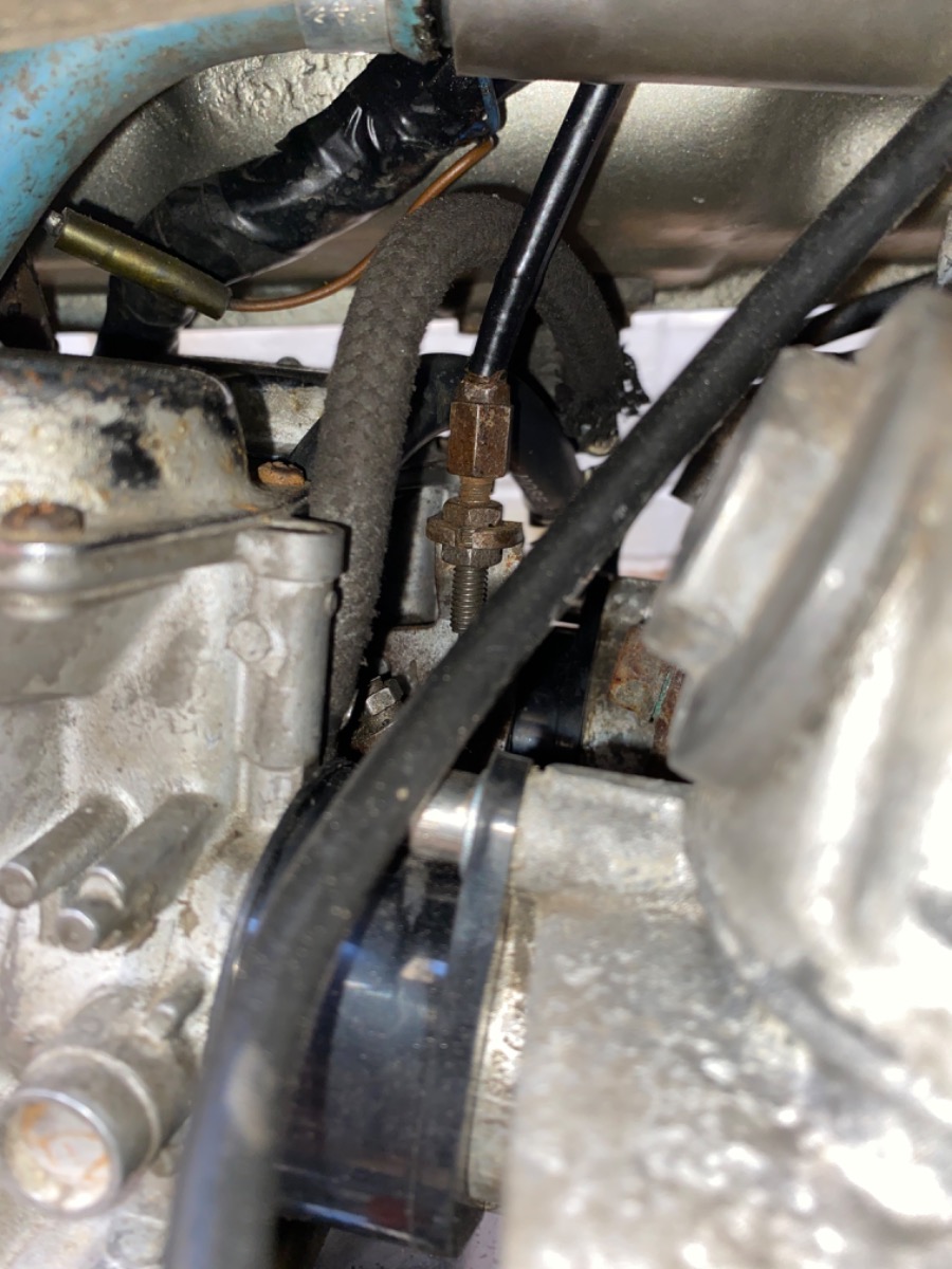

Which way should I be adjusting the cable adjuster screw? This is where the brain freeze has set in! In one of the pictures you can see the majority of the outer cable thread is below the bracket. Should there be less of that thread, I.e. effectively making the outer cable longer, to reduce the idle speed?

Airbox side spring clips are not as important as engine side manifold clamps. Without the engine side clamps you'll be drawing in unmonitored air and running lean.
Throttle cable outer, shorter means longer usable inner so allowing slides to close fully.
Read the service manual section about routing and fitting the cables and how much slack each cable should have when the throttle is fully closed.

I fixed your pics. Next time click insert all after your text. Not having clamps on the intakes will cause a lean condition. Also lubing the cables can be your friend.

there is very limited scope to turn the adjuster clockwise. See the picture. I don’t think I’ll get the revs down much with what’s left of the threads, so there must be something else going on. Do you agree?

I do think I have an issue with the throttle cable route. It is now stretched when I turn the handlebars full left. It wasn’t before. It’s ok with the handlebars straight, and turned right Looking at old pictures, it should be routing through a gap near the top of the petrol tank. It’s currently routing much lower. I’ll fix that tomorrow am if I can.

Regarding the problem, there is something wrong with your throttle cable. Most likely it's not seated somewhere.

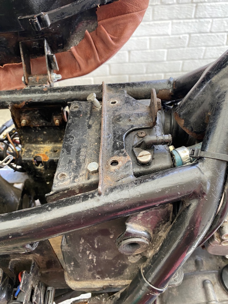

I’ve removed the tank and the routing of the cable wasn’t perfect. No kink but perhaps the tank was pressing on the outer sheath.

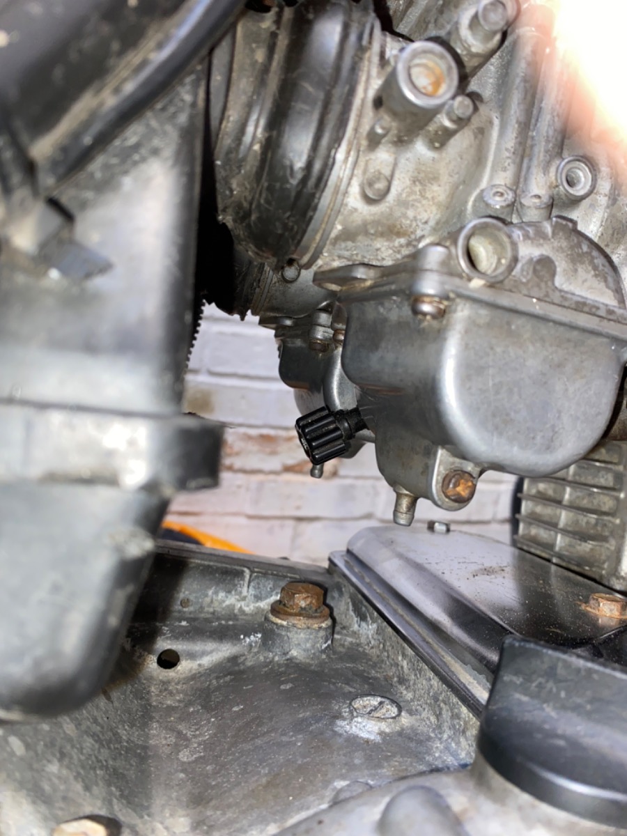

BUT ….. The rhs carb overflow is leaking a stream of petrol. This was not happening before. The fuel switch is at ON.
I thought I’d made such great progress with this forum’s help.
What might be the problem now please?
