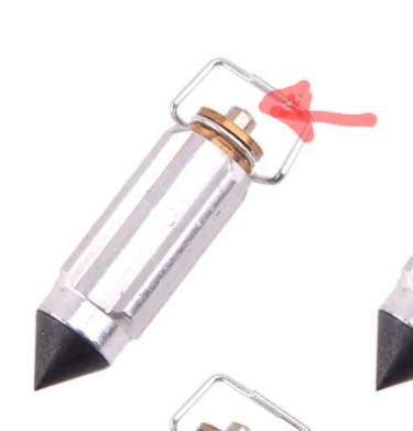

If the pin in the top of the needle valve doesn't SPRING in and out of the body of the needle valve but does move in and out then its knavkered and you need a new one.
I'm not talking about the needle valve moving in and out of the valve seat but the valve (with pin sticking out of it) itself. The pin on the end should be spring loaded.

Thanks. It does spring out. Not with great energy but does come out quickly. I’m curious why the LH carb float springs up and has some bounce where as the float in the overflowing RH carb returns to its position but without the bounce?

Internal spring could be full of crud or broken.
Probably easiest to get a new one.

The OEM Keihin or Keester brand float needles are best. They are rubber tipped, and 40 year is a long time for rubber parts to live life in gasoline.
And obviously, all that rust and crap will clog up the carbs, including the float needle, keeping the bike from running right.

The keyster needles are good. They have a proper needle spring, that can hold up the weight of the float. All the other aftermarket needles I tried couldn't.
