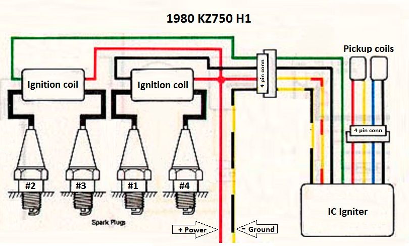

You can try swapping the two coil wires, black and green.
Easy to swap.
If they are connected wrong to begin with, the spark plugs will fire, but at the wrong time.
Swap the black and green coil wires, and try to start her.
This is an electronic Ignition diagram, points also use the green and black wires:
Easy to swap.

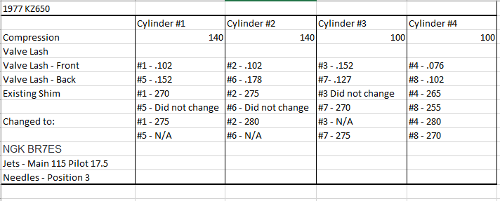

I checked the compression (princess auto/harbour freight style tester, questionable I know) and found the following results #1-140 ,#2 -140, #3-100 , #4 -100. I was advised by some people on the site to check the valve lash and adjust the shims accordingly, I have those numbers at home.

Something is not right with compression in #3 & #4. But that wouldn't prevent the engine from starting or the carb from flooding.
Just to be clear...when you increase the shim size you decrease your valve lash. For example, when you went from a 270 to a 275 on cylinder #1 front, you decreased the clearance from 0.12 to 0.05. I don't have the book in front of me but from memory I think you want about 0.15 valve lash. Did you check after you changed shims?
