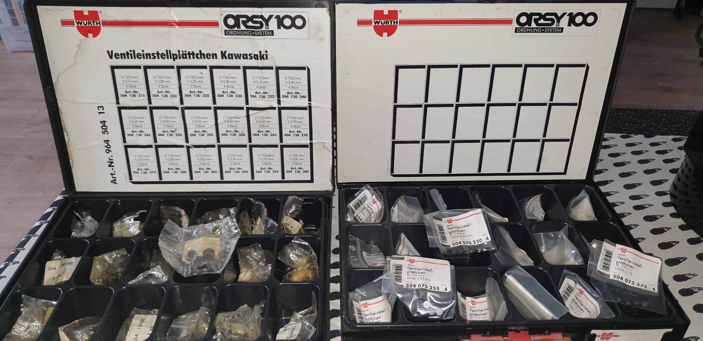

Your local Kawasaki dealer or bike shop should have what you need. Give it a try.....
My Würth set of shims, steal deal on ebay (80 Euros).
