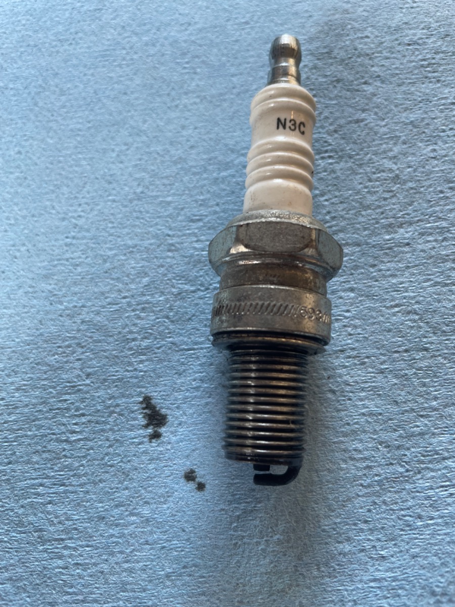

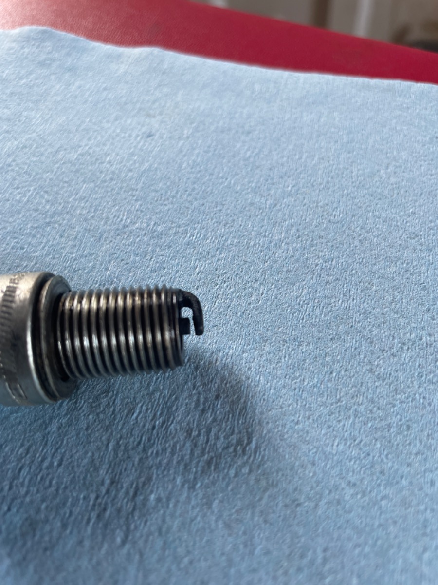

- BlackEyeCafe
- Posts: 74
- Thanks: 3
Re: KZ650. Carb #3 spitting fuel out. Wont start
17 Aug 2022 10:38 - 17 Aug 2022 10:46
1977 KZ650 C
Jets - Main 115 - Pilot 17.5 - Needles - Position 3 - NGK BR7ES
Last edit: 17 Aug 2022 10:46 by BlackEyeCafe.
- Posts: 4836
- Thanks: 1851
17 Aug 2022 10:52
You can save that plug so you can test, use a propane torch and heat the ceramic and earth strap. It will take some time but eventually the ceramic will start to lighten, continue to heat till the whitest color is achieved.
