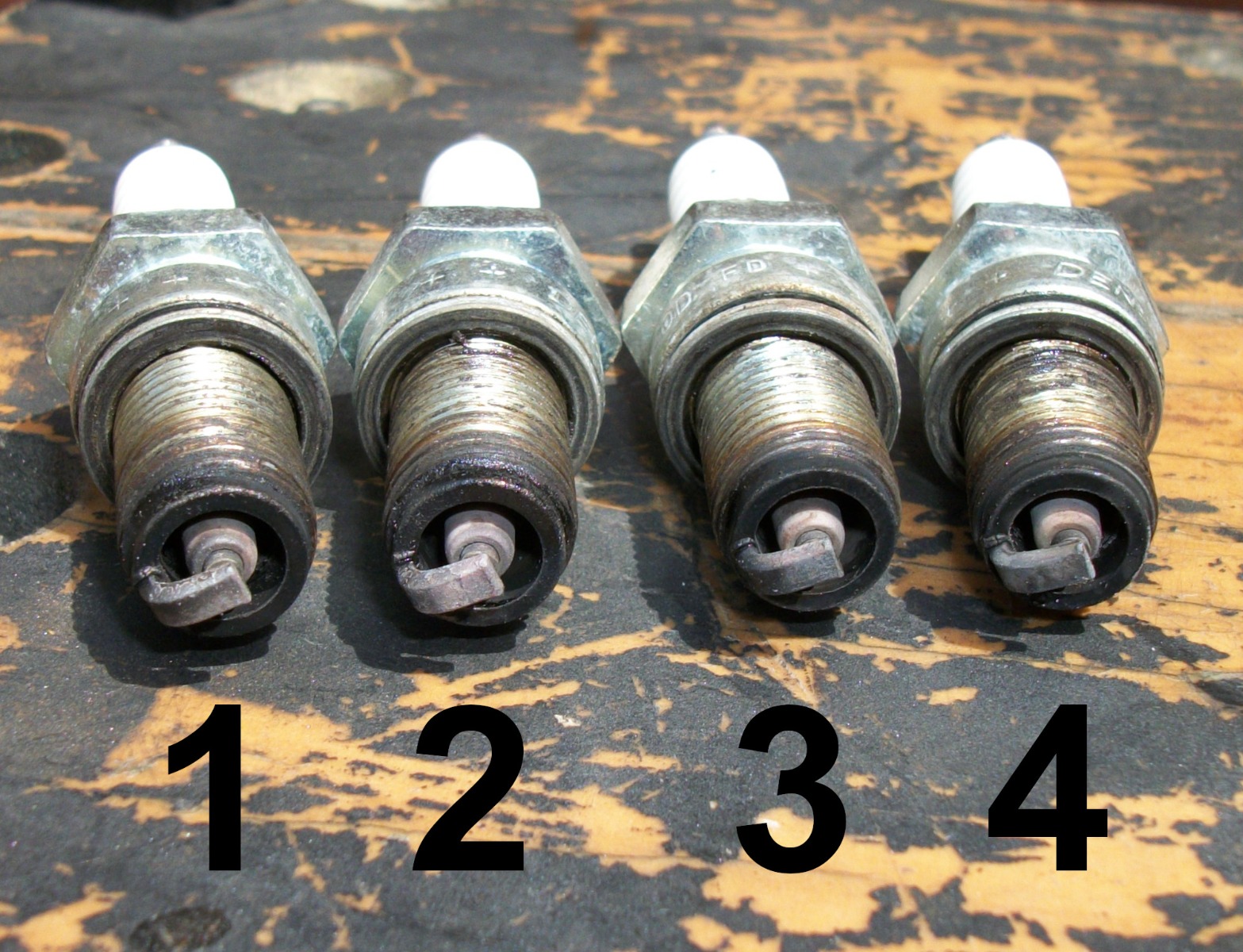

28 Jun 2022 15:11 - 28 Jun 2022 15:12Ok here are the plugs. I took it on a 20 mile ride without really pushing hard, they look decent? The tips look a little darker than yours.

Can't see enough detail in your photos.
Perhaps take individual pics, of each plug... kinda like the pic I posted?

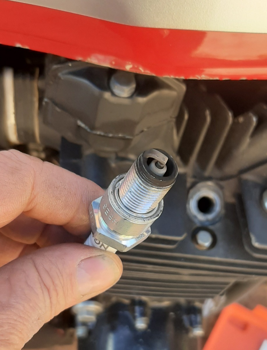

Plugs look OK but you will need to run it in the "problem Zone" and look again.
here are my Z500 plugs after 300 miles of running fine at 4500 -5000 rpm most of the time. E5 fuel only
Rob B

gvin, yours look kinda ok, not perfect. However, I would just try a fresh set of plugs.
Also, check for spark "strength"... (weak, or intermittent spark will cause the symptoms you are having)
Perform the test by plugging them into their respective caps, "earthing" their bodies against the cylinder-head and cranking while looking closely at the electrodes.
There should be a bright blue spark, and also, you should be able to "hear" the spark...
You should also do a comparison between "old" and "new" plugs to get an indication of any differences...
(I always have a new plug in my tool-box for such a comparison)
