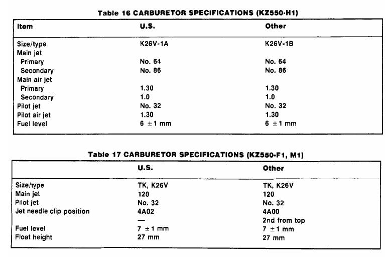

Welcome, from what info i have the fuel level could be out.
27mm to top of float or 7mm +/- 1mm down from float bowl i think is the spec for the TK26 CV carbs
also the idle mix adjust needles in pattern kits are sometimes not right, this was the case with my 1200 Mk2 bandit so i used the stock Suzuki ones with the pattern seals and washer.
I do not have a link for the Z550 with CV carbs and the GPZ550H unitrak is similar but not the same jet sizes. Please post the jets you have used and ones available in the kit

I checked the float bowl level and was in spec per the owners manual. Forgot to state that on my opening post. Good point about jet sizes, I kept everything from the original carbs as the parts were not damaged, but replaced since I had new ones. I will be taking these apart once again and replacing the new brass parts with the old ones. I will report back afterwards.

28 Jun 2022 08:43The original jets were #32 as were the ones that came with the kit. Per the suggestion above, I tore down the carbs and reinstalled the original pilot jet. When I tore the carbs down, I rechecked the float height and they appear to be within spec.Welcome, from what info i have the fuel level could be out.
