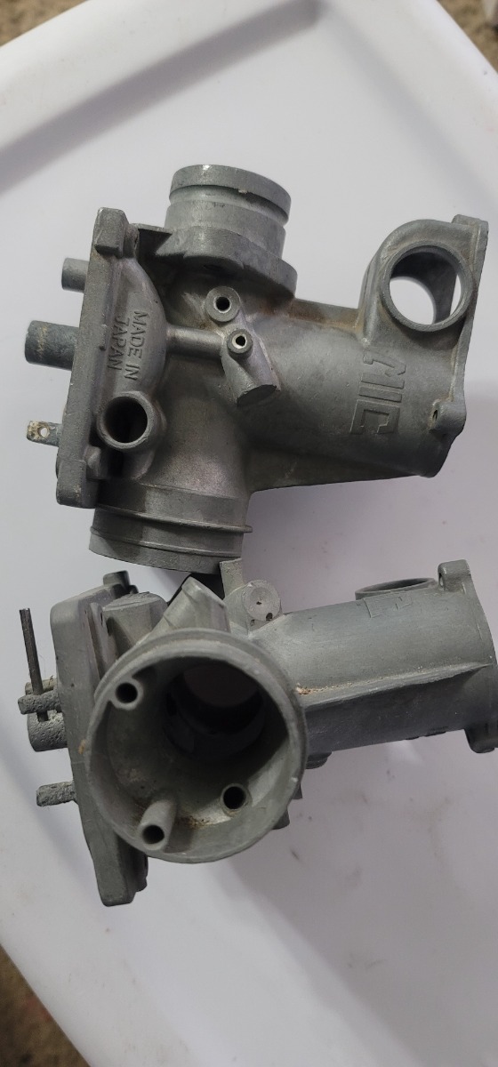

Hey everyone. So a little back story and context. A couple years ago, a buddy gave me his old kz that he was going to work on. It's a 1977 kz650b I believe, based on the paperwork and title. It's a full and complete rebuild I'm doing, from the ground up. It had most all of the parts, and the last time it was put together which was about 4 years ago, it wpuld run decently, but it was having carb issues. So obviously based on that the bike came in pieces, and I know I'm going to have to purchase quite a lot to get this up and running, but this whole situation is going to be more of a learning experience, and I will probably never get rid of the bike once it's done. I've never done something like this, but the bike was free and I'm using this as a kind of, intro, into engines. I am pretty mechanically inclined, but forgive me if I don't know the names of stuff, or how to begin identifying. So the bike came with two sets of carbs. The ones installed (loosely, lol) were ribbed. (Pictured). I'm thinking they were the classic vm24s as they did not have the extra port at about 10:00 though they do have three ports so, maybe I misunderstood something. The set I need identified, description and context: The second set of carbs that came with it, had a smooth, non ribbed body, and seemed to be identical for nearly all intents and purposes except the slide, and the bores of all the openings is larger on the smooth set, and the carb itself is slightly larger. Other than that they look like they may be able to bolt right on, and all of the holes and everything are the same, the float bowl in the top cap piece fit onto it just fine. the previous owner had no clue what they were, or came off, all he knew was the owner before him purchased them with the intent to replace the ribbed ones. When I opened it up, one of the ribbed carbs is trashed as the slide was completely seized in there and no amount of work could get it out. But the other set that came with it, the smooth, we're in quite good shape and I was able to remove the slide and get them completely broken down so that I can clean them very well. So long story long, the identification part is, does anybody know what this smooth bodied carbs are?Questions: What they came off of? Was it another KZ650 or was it maybe from a 750 or something? if I get these all put together and rebuilt can I slap them on my 77? And final question, if it is going to be a big deal or something to replace them, would it just be worth it to go get a fourth carb to make the set, of the ribbed ones? Really all I would need is the body. So the pictures are of the smooth bodied ones, one of the ribbed, and a couple comparing the two.

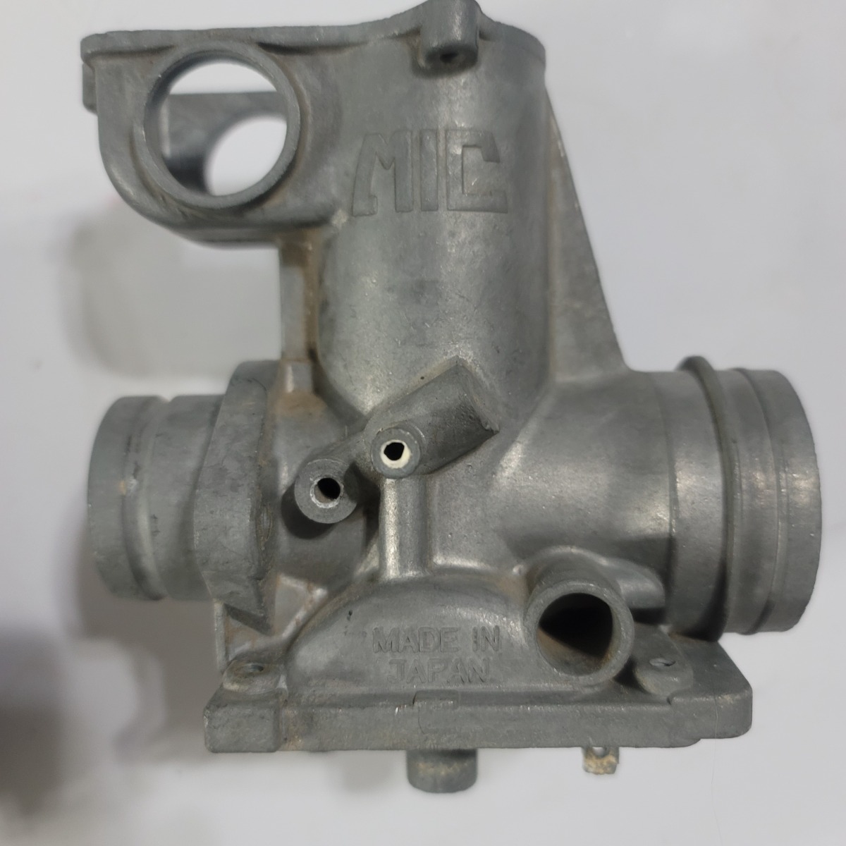

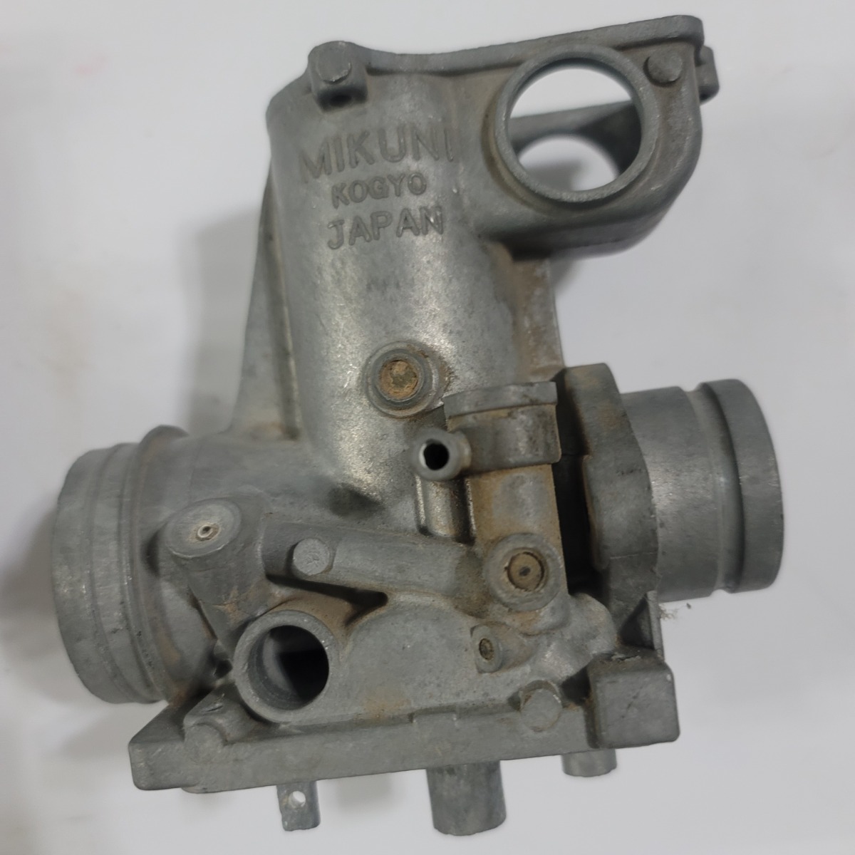

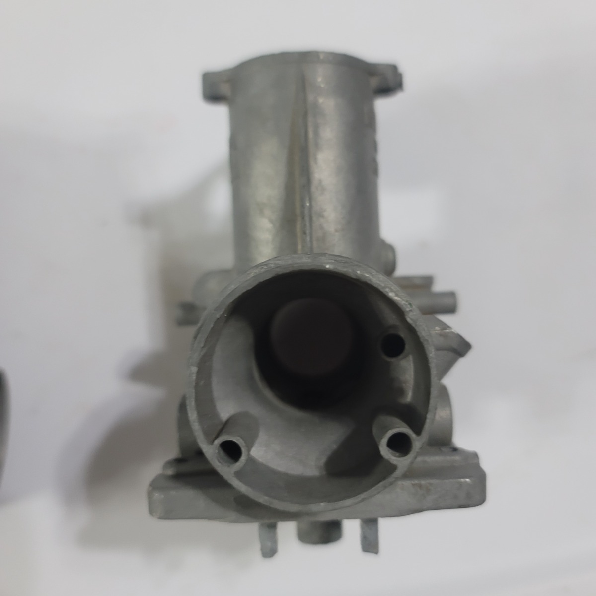

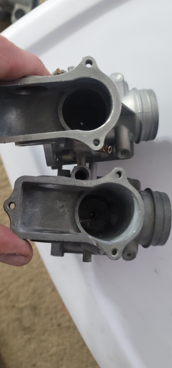

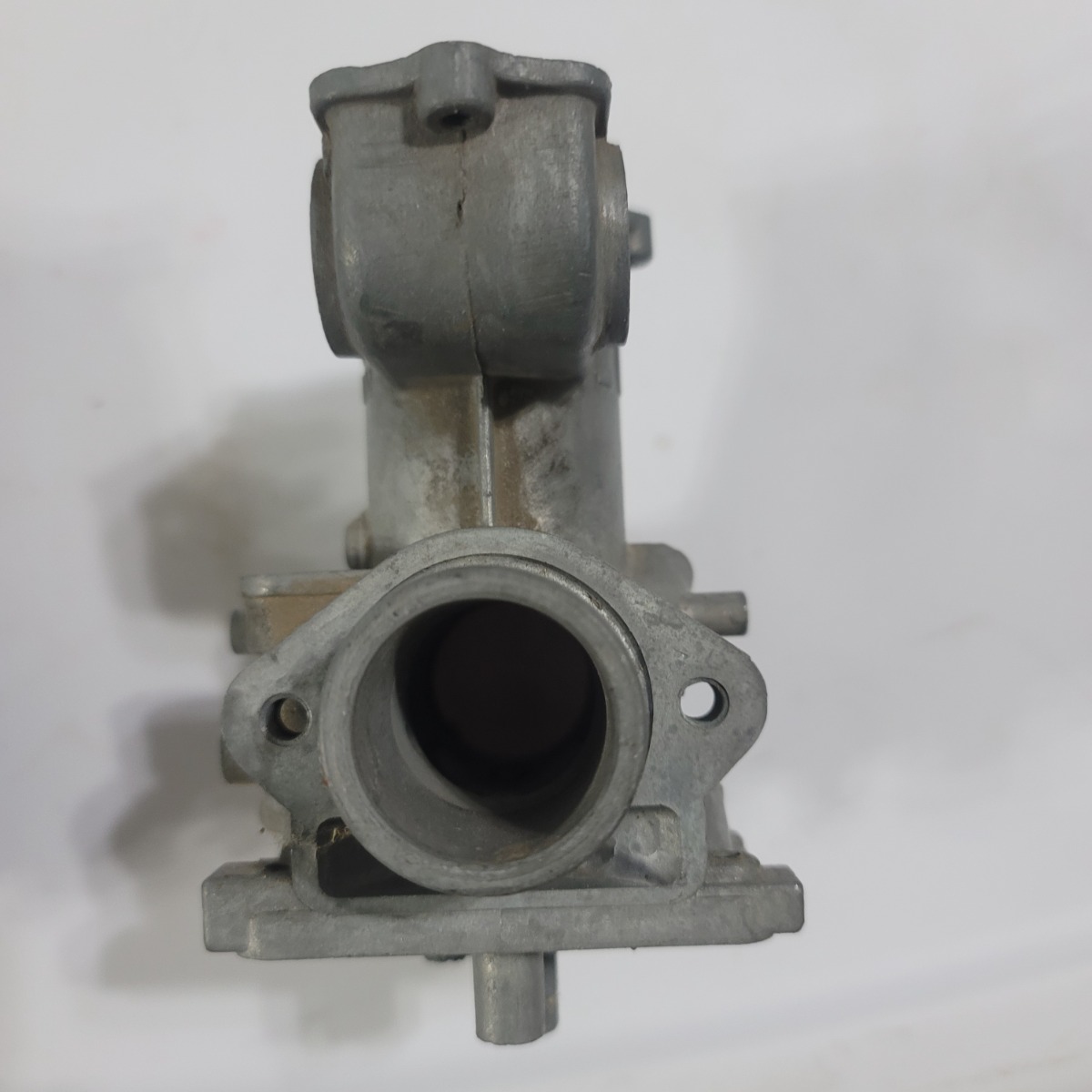

Non of your pic or links are visible but all the ribbed carbs will be Z650 and either VM22 or VM24's.
Then non ribbed will be VM26 or VM28's and are from either Z900/1000 or GS750/1000 depending on mixture screw configuration or even VM29 smoothbores which are performance carbs and never fitted as stock to any machine.
The 26/28's are the same spacing as the 22/24's but will need the 900/1000 boots with a slight modification to the mounting holes to fit the 650 head.
Once you post some visible pics we can confirm what you have.

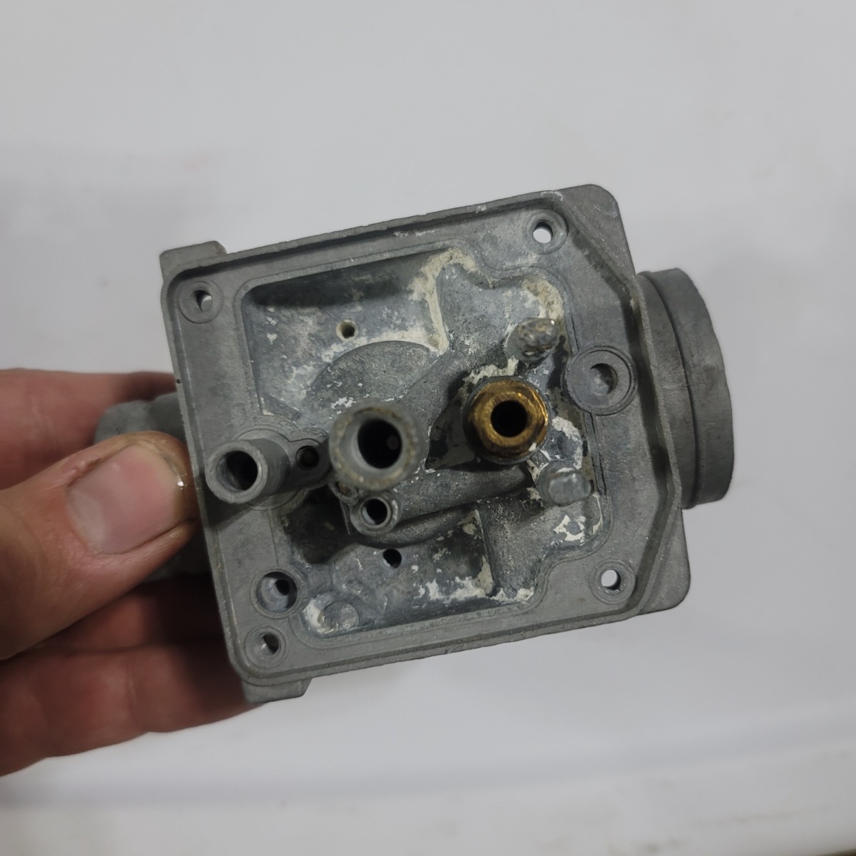

Zed1015 will be the expert. The body with the horizontal rids are VM24SS used on the 650. The body with only the vertical rib are VM26SS used on the Kz1000.
Just a note of caution. The float post look very pitted and might be weakened. Support them while pushing the float pin in and out.

Yeah they aren't as bad as they look in the pic but there is some pitting to it. I had plans of being very careful. Thank you much for the caution.

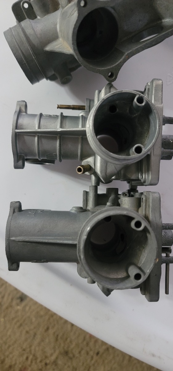

The ribbed carbs are VM24MM and the others are VM26MM Kawasaki carbs.
The 650 boots are too small for the vm26/28 which is why you would need the 900/1000 boots ( which also have the vac port tube) to fit them.
The holes in the 900/1000 boots are wider apart than the 650 ones so if they were to be used the holes need be elongated inwards slightly for them to fit the 650 head.
