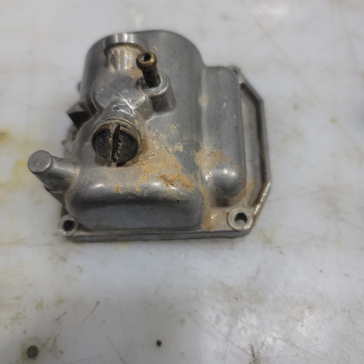

Hi, are your carbs, air Agustin on side or on the bottom with the bowl?
and if? Which side? As there are 2 sides each, that saying! I have some parts couple had brass choke tubes broke. So I have 1 good body with adjuster on bottom. Also some perfect slides all 4 with all the brass items. If your looking to fix your originals.

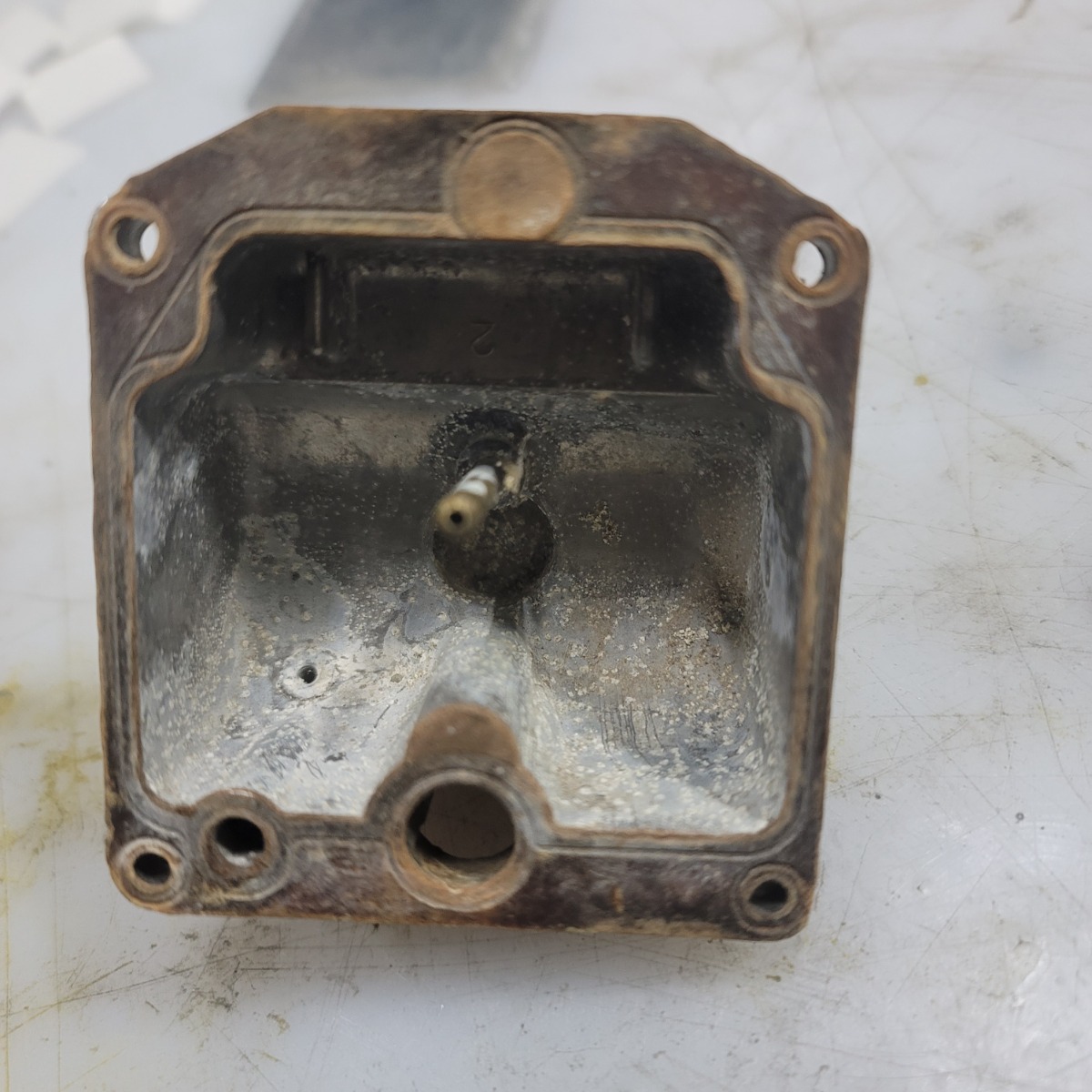

I do not know, without pulling out charts and everything. There are pictures of all sides of the 26, but if you need a pic of the vm24, I'll take them when hoE. and if you need a picture of the bowls or anything I can show you that also.
here are pics of the bowl
I believe, the carb that is damaged is and outside one, but I would have to look at some diagrams and put them in order. Again everything came in pieces. The carbs were put together in their framing or whatever you would like to call it so they were still all attached together but like these slides and the bowls and all of that had been removed. They did take the 24s and just throw the balls and stuff back on it real quick and and slap it on loosely just for transportation but.
That is how the bowls on both of them look.
Sorry I just don't know a whole lot about engines and this bike is essentially going to be my engine class LOL. I'm using it to learn I am fairly mechanically inclined so I'm not really worried about doing any of the work, and if I end up just trashing the whole thing that's not a problem but. I'm trying to put as little money into it as possible to get it back running. Most all of the work is going to be refurbishing as many parts as I can, I'm going to tear down the engine all new gaskets all new hoses. I'm going to try to reuse as many of the electronics as possible, but will replace whatever needs to be replaced. I may have to build a new wiring harness but I already have tons of wire and connectors and everything for building a harness so that wouldn't be too big of a deal. But I'm just trying to get out of aying for too much, as if I have to put a whole bunch of money into it, once I get the antique status what's in my state it has to be basically stock, it can't look radically different, then I will start tearing it apart and playing with it. The stuff I learned from rebuilding everything will then go into modifications. I plan on stripping it down to a cafe racer style. And the reason I need to do that is because the title is in somebody's name who is dead, who sold it to somebody else but they just filled out the title, they did not get new tags for it, and that person is now dead too, and it was in a barn given to a friend of mine by the family of the Dead Guy. I guess the guy who's dead right now who bought it from the original guy was doing a lot of work to it and he just got too old. Anyway so the title I have has somebody who died like 15 years ago on it, and then on the back it's filled out to somebody who died like 5 years ago, and in my state that title is basically trash now. Bill of sale doesn't work and the only two avenues I have would be a quiet title, or an antique. They will title antiques with Just a Bill of sale. But again for to be an antique it has to look stock so

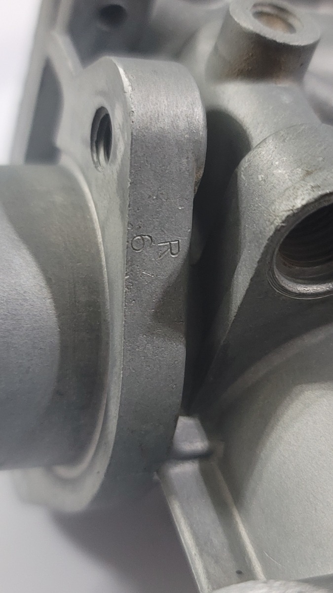

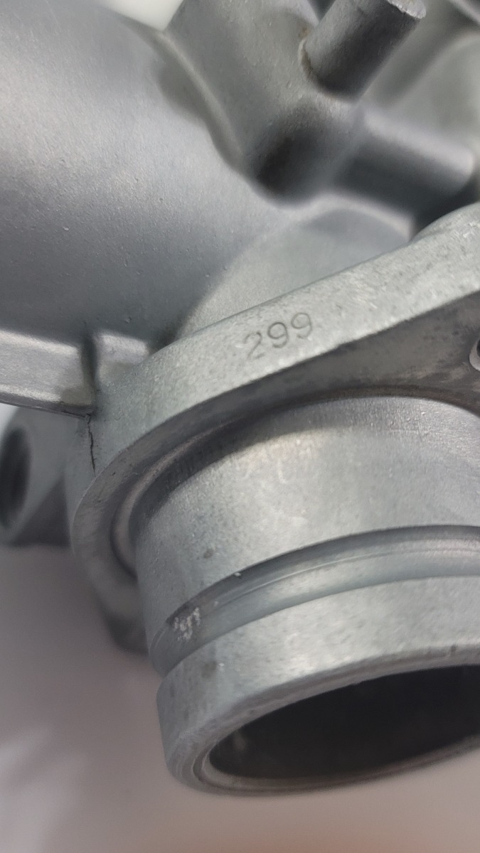

So on one side of the flange it says 299, on the other side of the flange it says r67, I provided pictures but the seven is very faint. But the number on the choke side is 299
