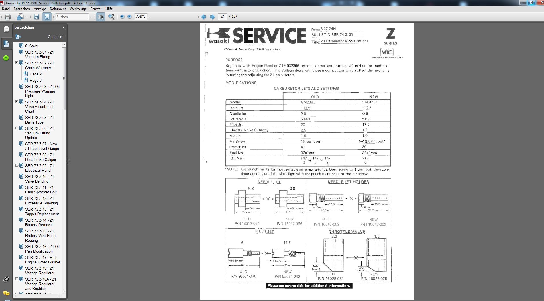

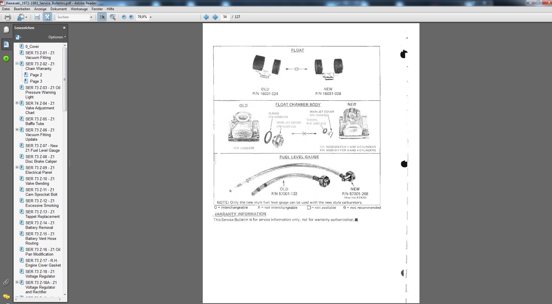

Some Service Bulletin info about the VM28SC carbs. They get an new type of the needle jet holder and needle jets.

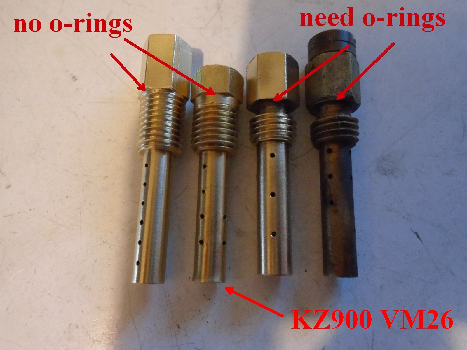

A collection of diffrent type of needle jet holders
