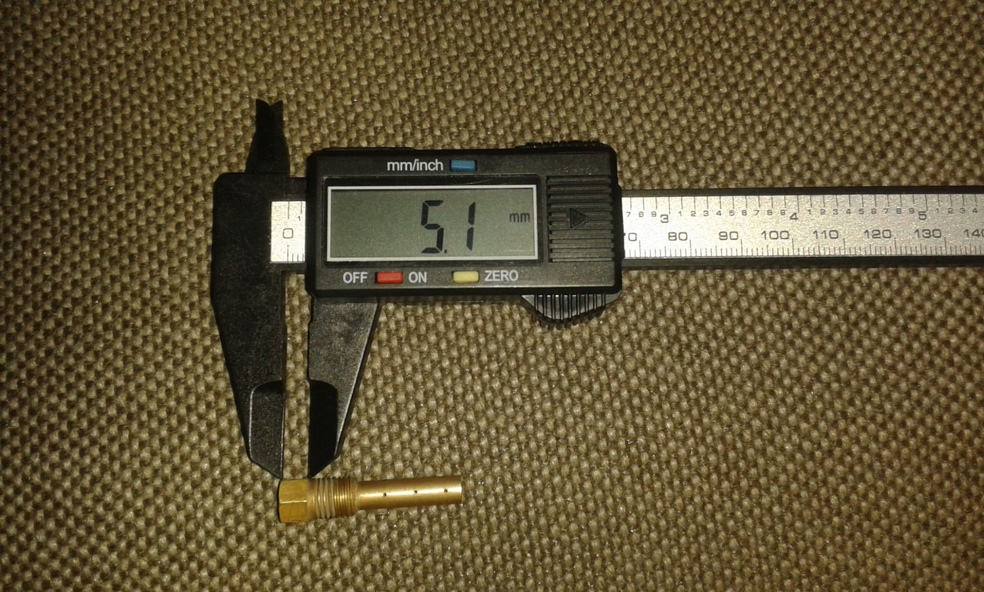

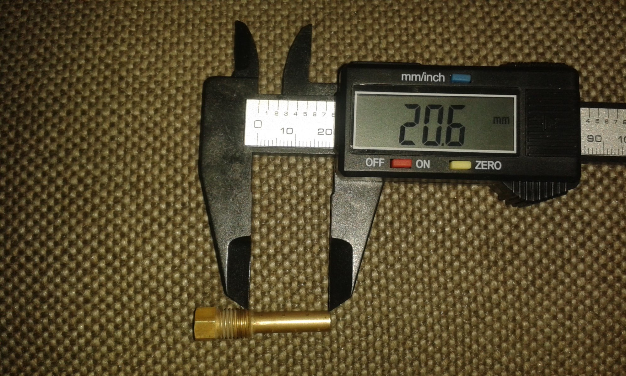

Re: Vm26ss emulsion tube and needle jet
26 Apr 2020 09:21 - 26 Apr 2020 09:21

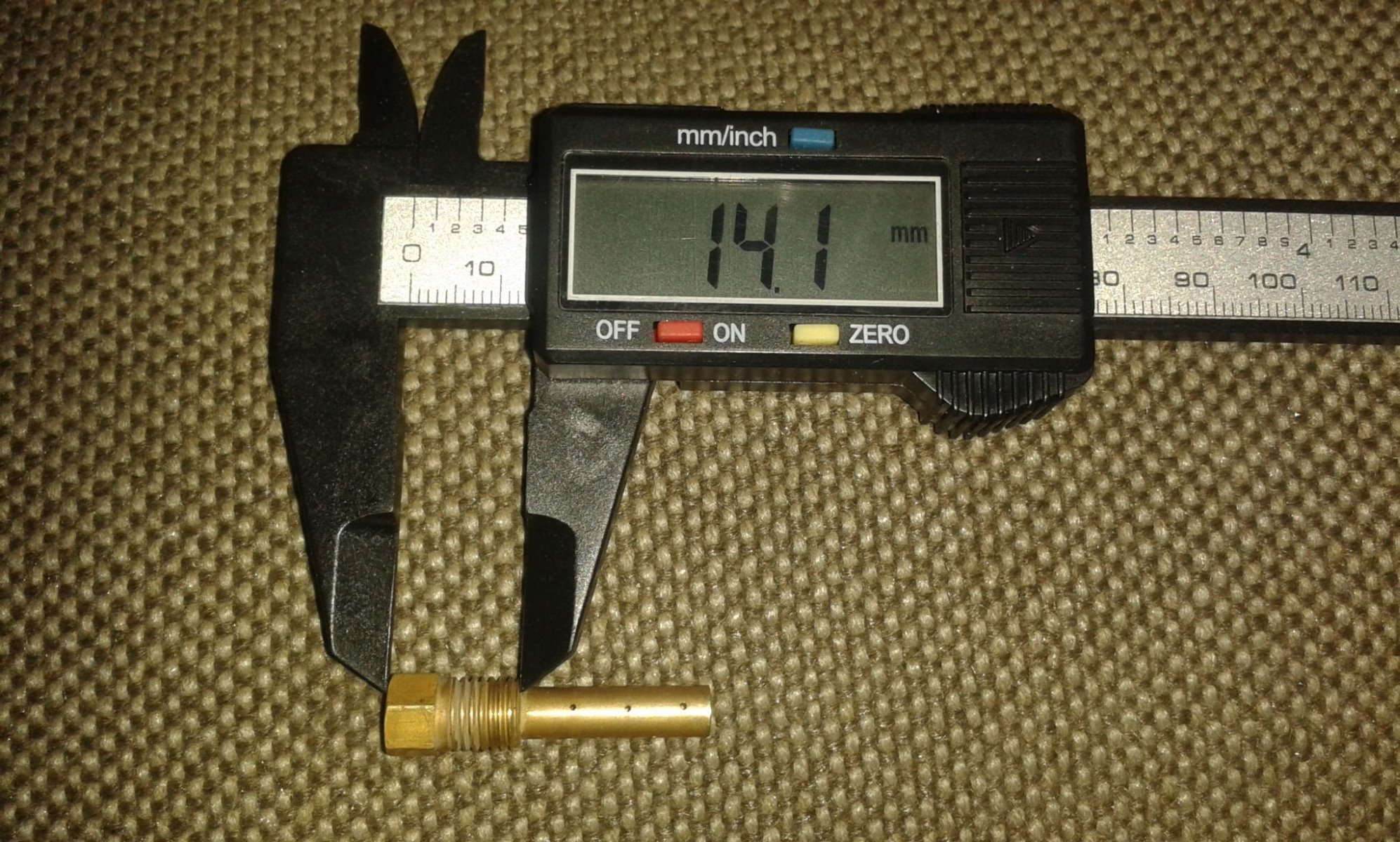

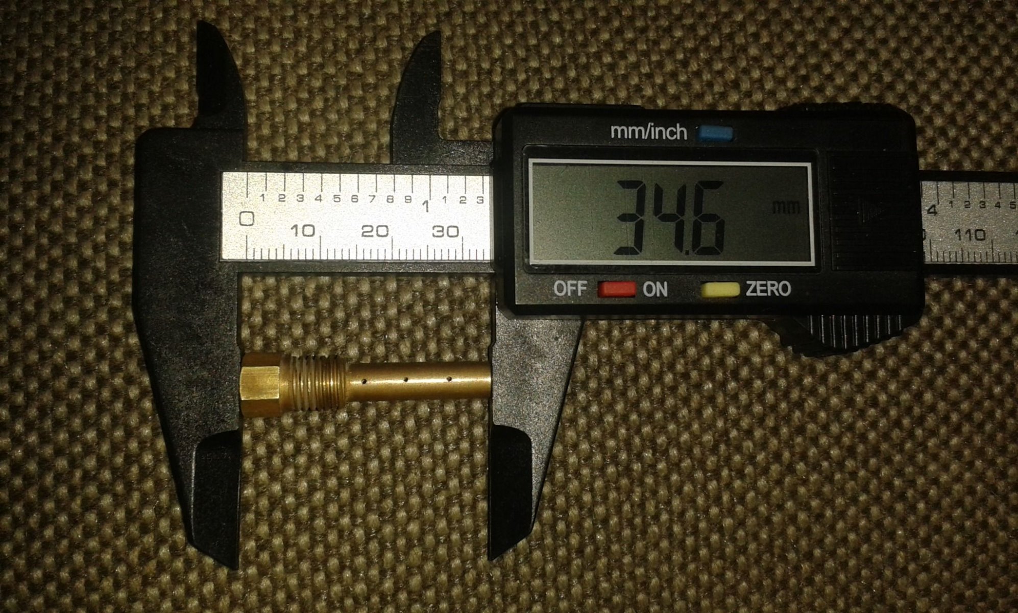

No Problem, it´a 15 minutes Job on one bowl removing four Allen head screws .
We will see if some one is faster, if so you will get double checked values.

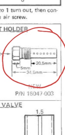

26 Apr 2020 14:31Attachments:
- Posts: 4420
- Thanks: 2269

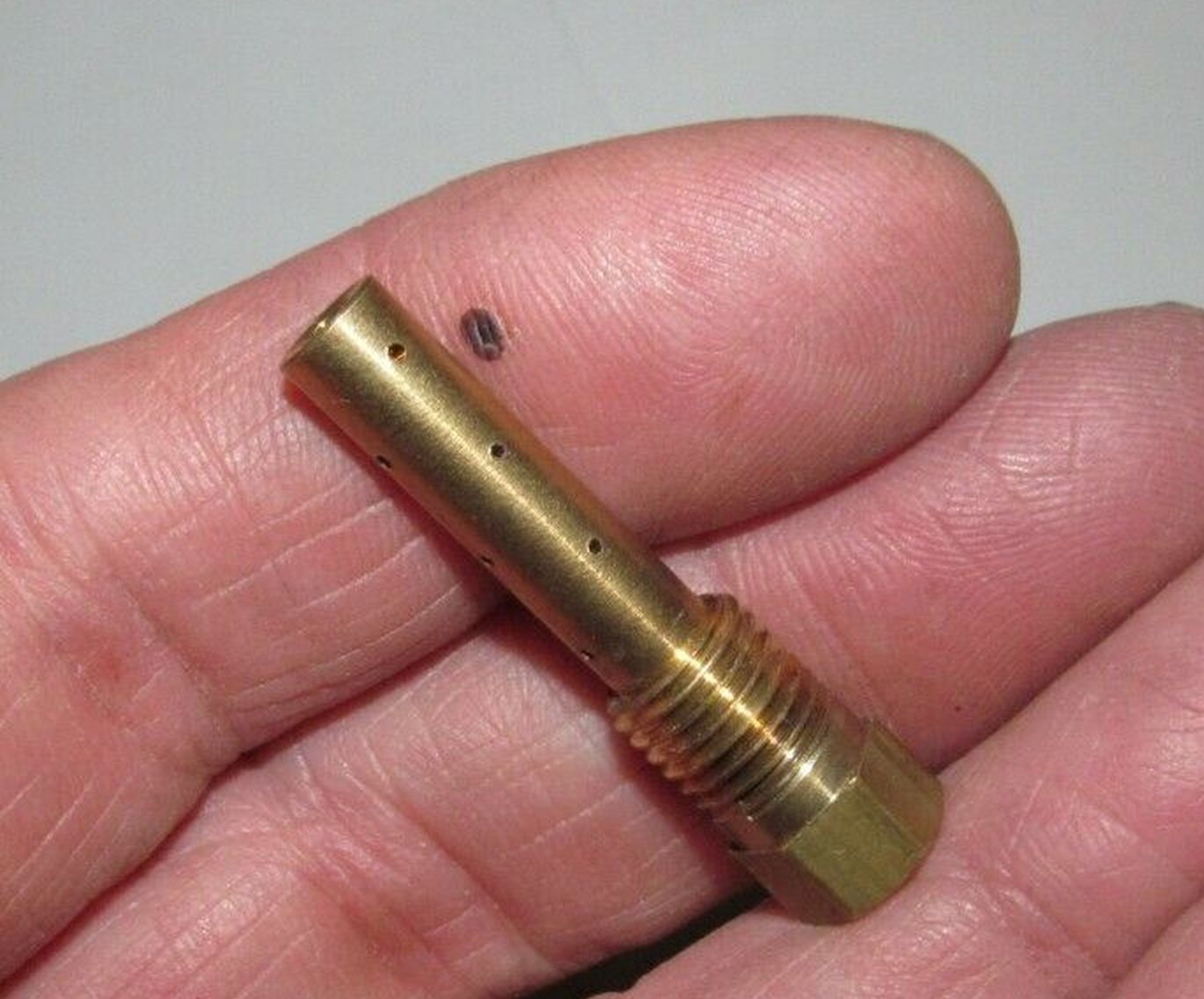

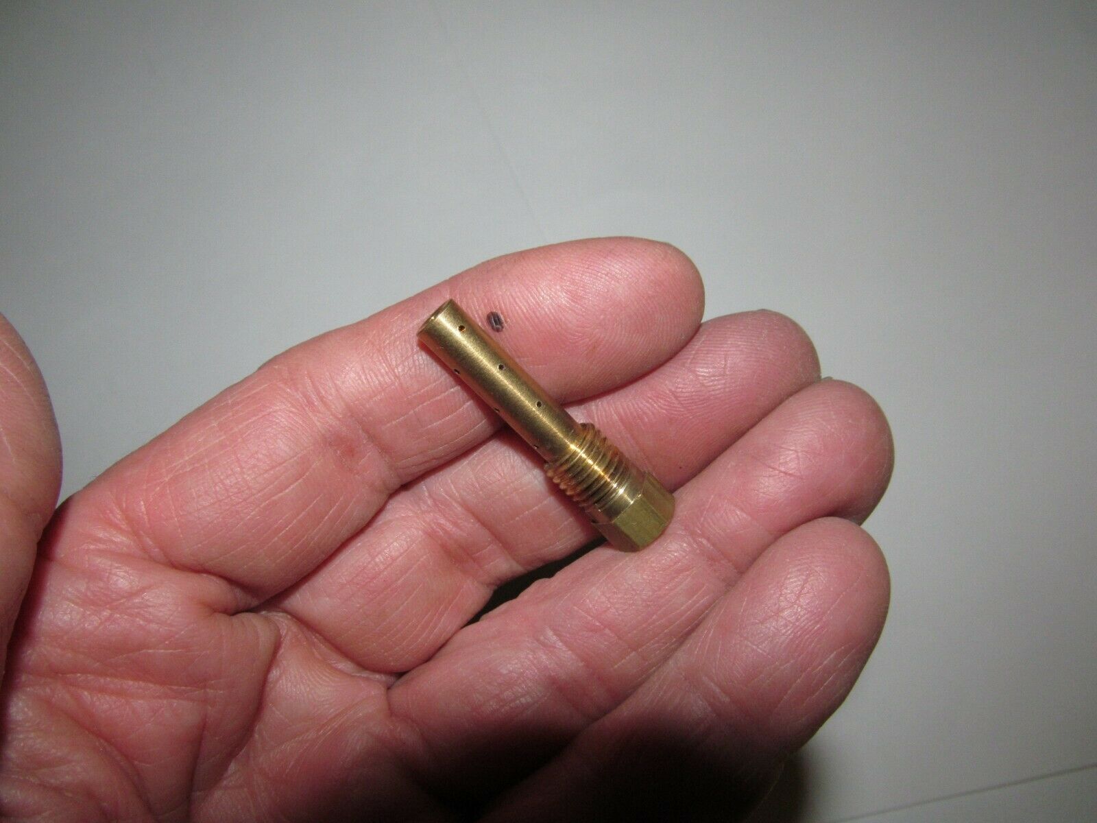

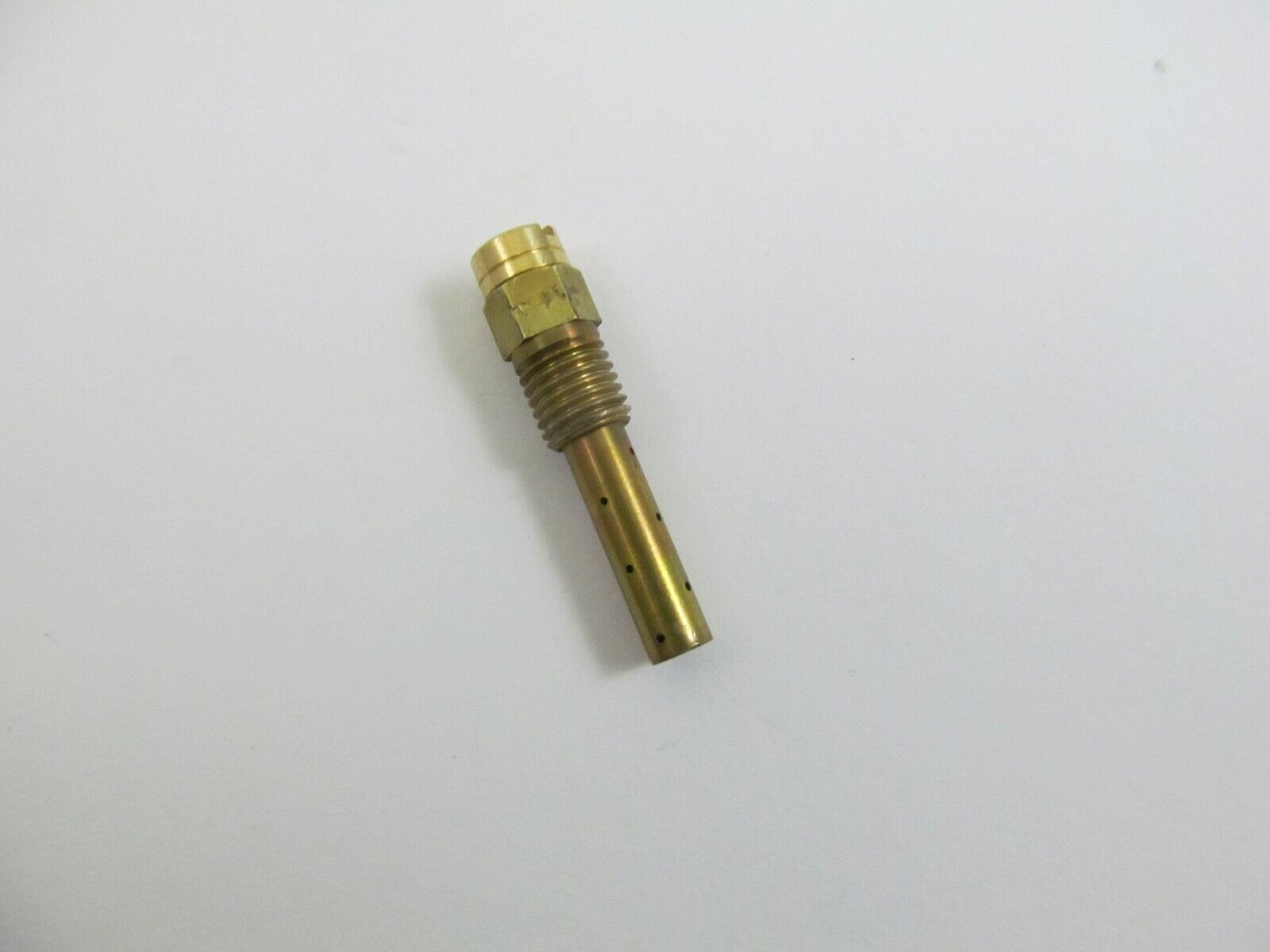

26 Apr 2020 15:43 - 26 Apr 2020 15:45
Yes, the size is the same but the bore hole pattern is different.
rover.ebay.com/rover/1/711-53200-19255-0...ZZLE-%2F274291441137
rover.ebay.com/rover/1/711-53200-19255-0...ZZLE-%2F352987730396
