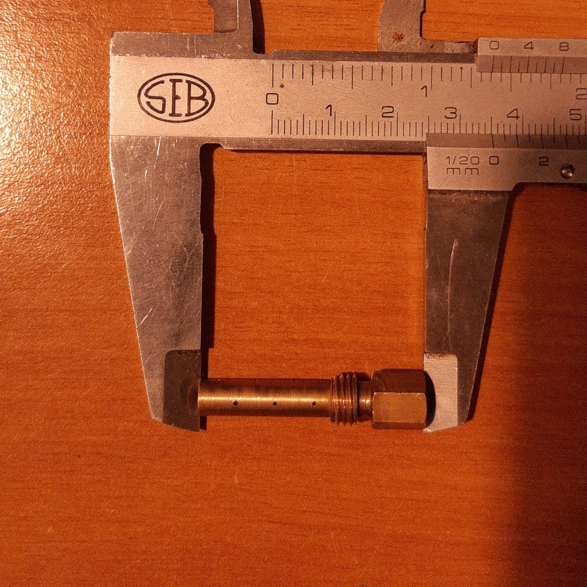

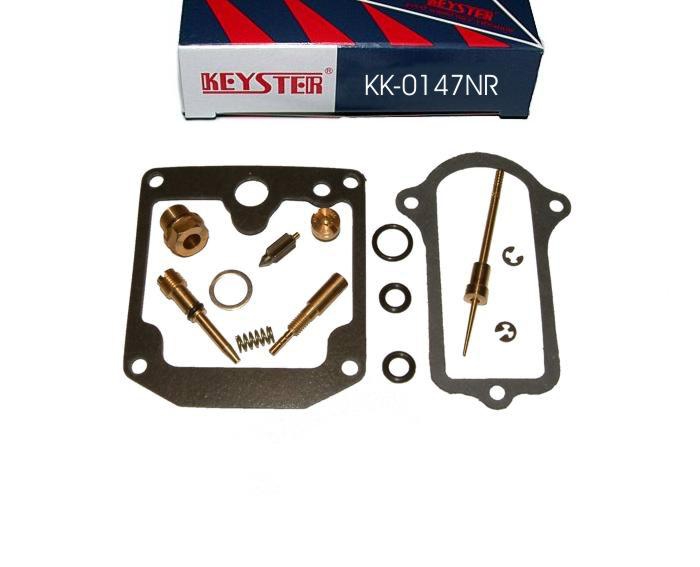

Oh ok sorry when i said emulsion tube i meant main jet holder or bleed pipe. Been searching information on internet and that part have so many different names
I attached pictures of the bleed pipe and the needle jet

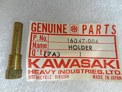

I found out there is also a different type of bleed pipe without oring which i attached too with it's part number, taken from google, unaware of that pipe lenght

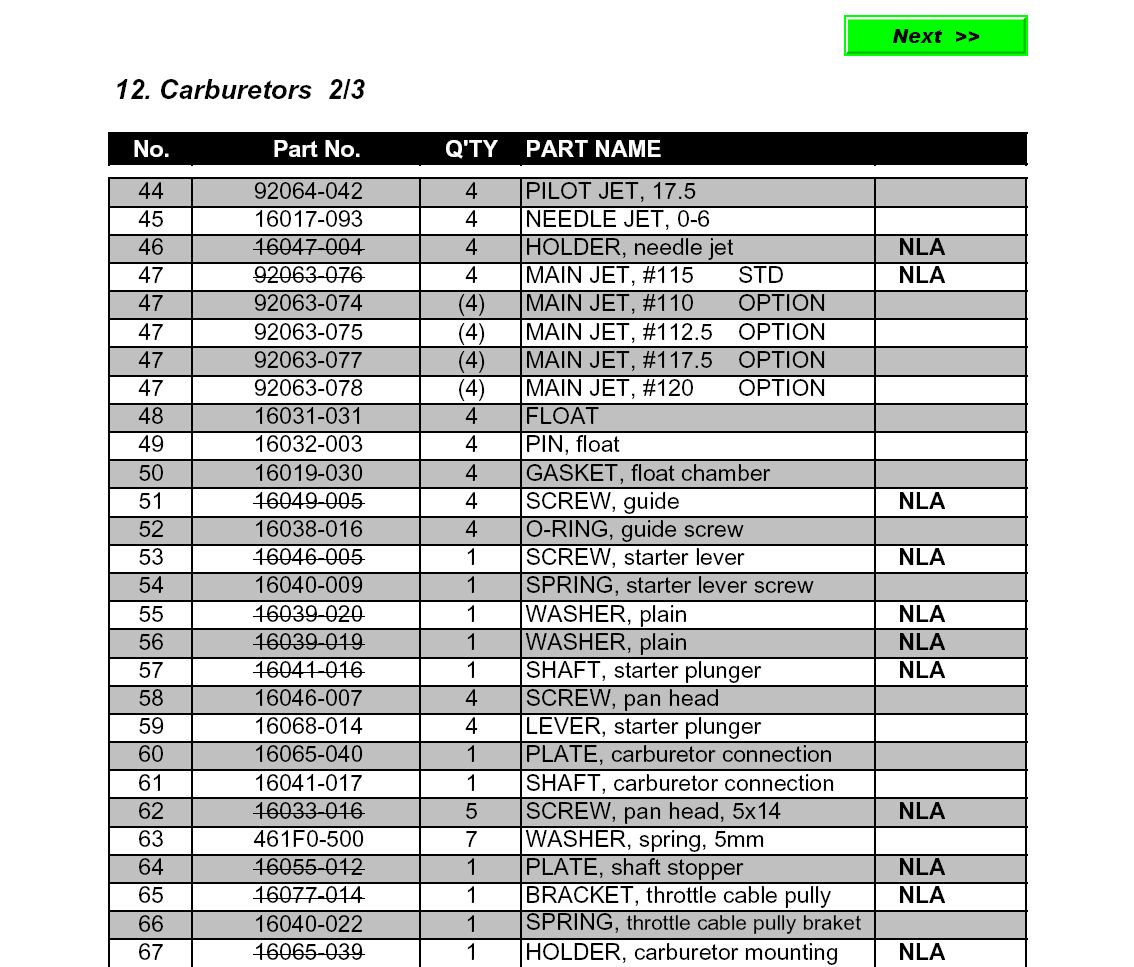

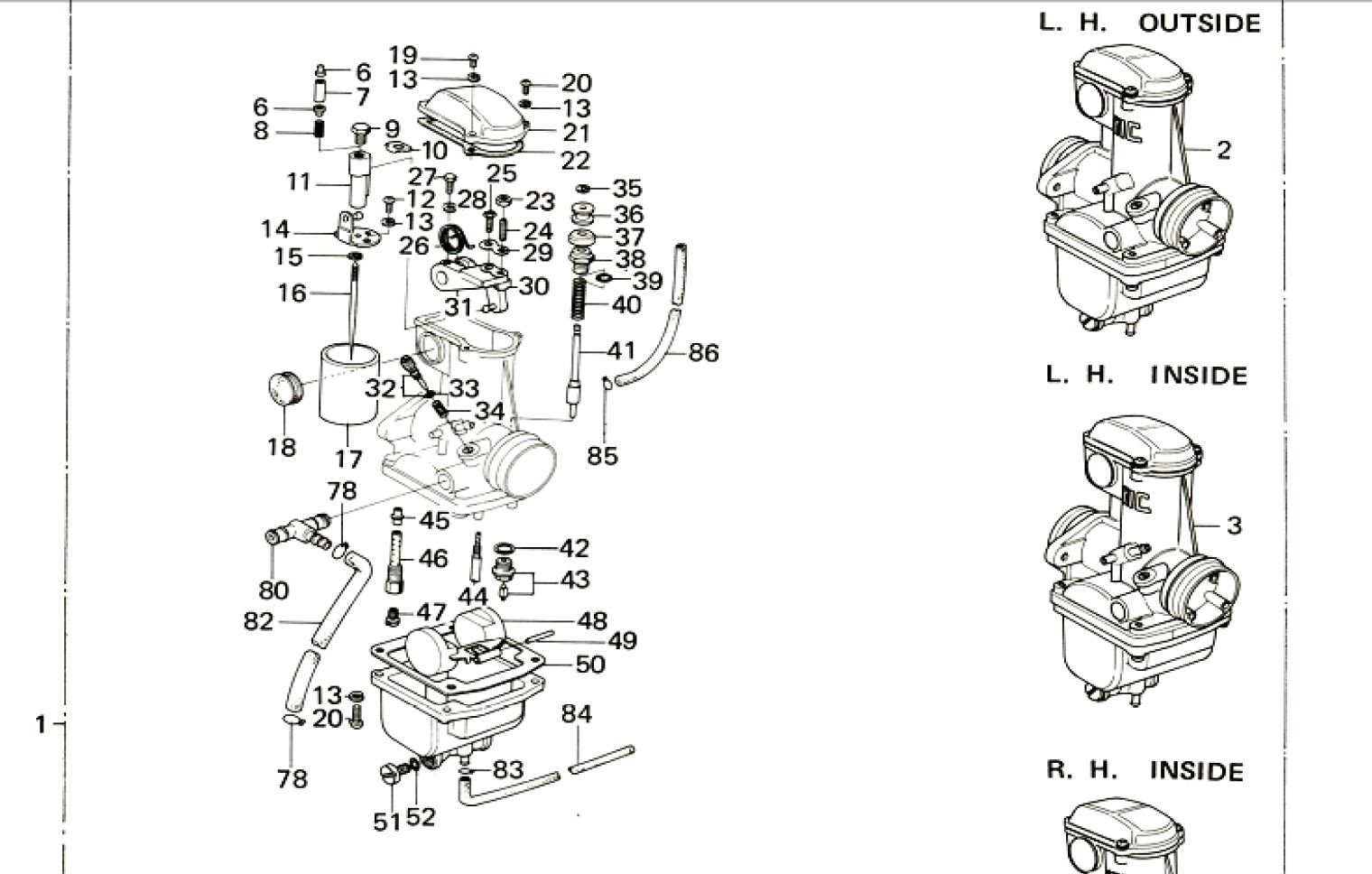

Looks like your needle jets are missing on top of the emulsion tube/needle Jet holder, part#45.

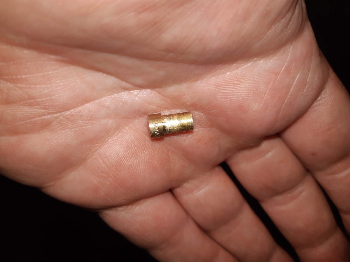

The needle jet i am working with are the one in the palm of my hand in the picture above
Code stamped on it is 250 - mikuni square symbol - 0-6

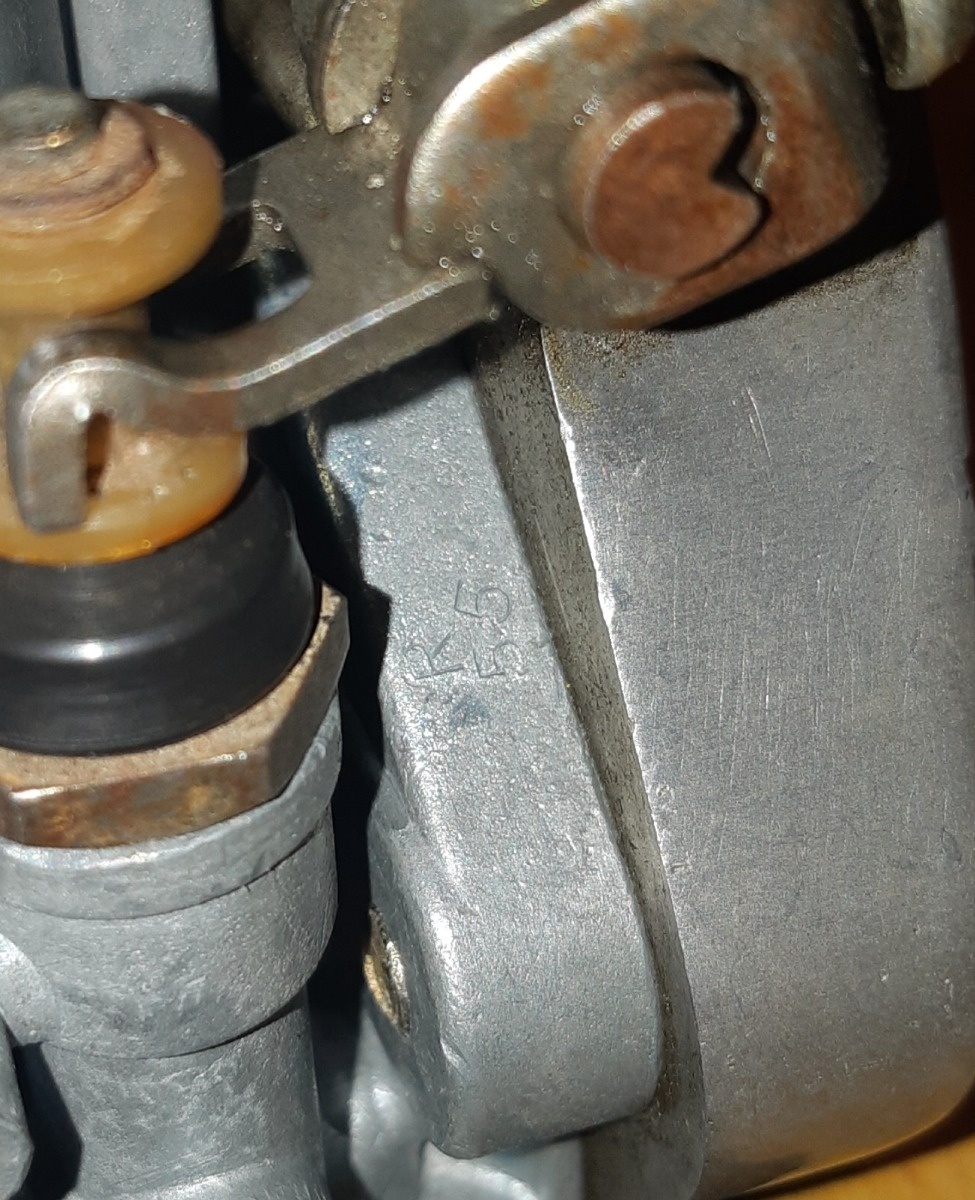

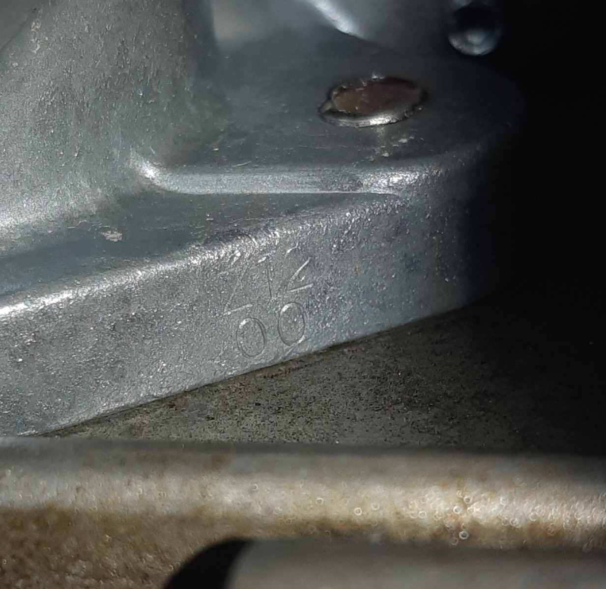

On the carburetors i found the codes in the next pictures which are Z12 00 on one side of the flange and R 55 on the other side
Forgot to mention, they have the air idle screw, the ones on the side of the body on the airbox side

Please click "insert" on your photos so they show up in high resolution instead of tiny thumbnails.

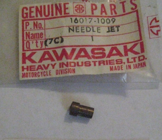

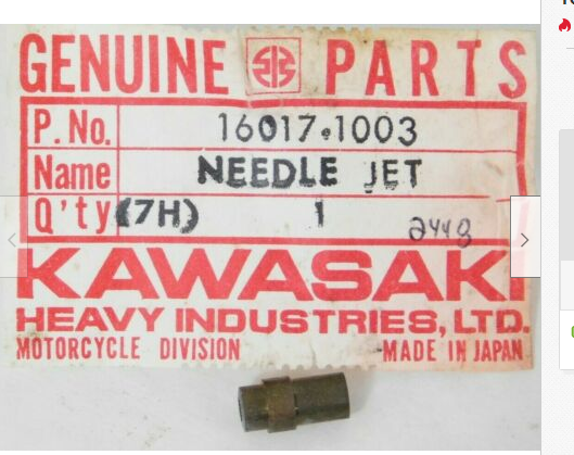

The bleed pipe that takes the O-ring uses the -1009 needle jet
The bleed pipe w/o the O-ring uses the -1003 needle jet

So i have a correct set, bleed pipe with oring and 1009 type of needle jet

Vict from the information i have gathered from yourself and Neil you have vm26s from the earlier models, which makes the needle jet you have pictured the wrong type along with the bleed pipe, you need the other types of needle jet and bleed pipe, if you are in the UK Allens will do the jets, but they are not cheap.
