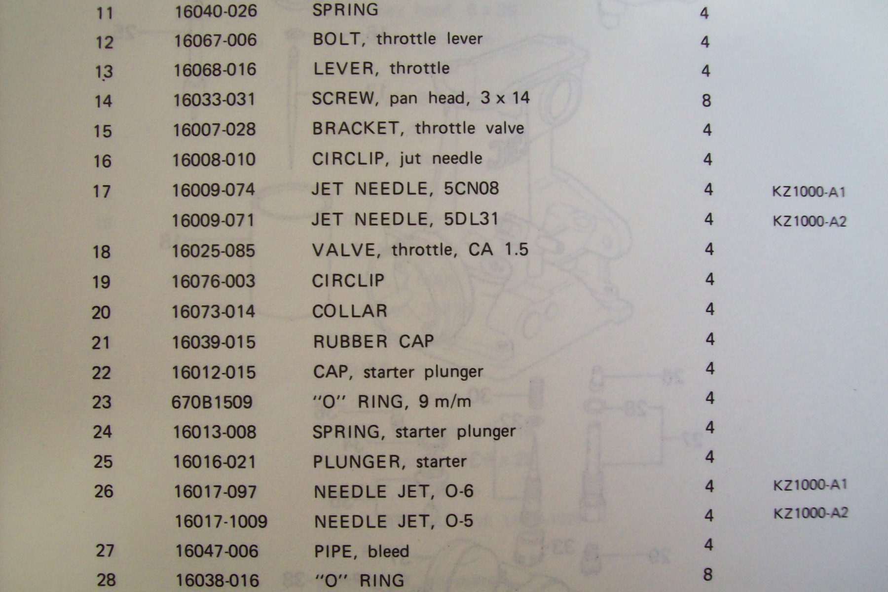

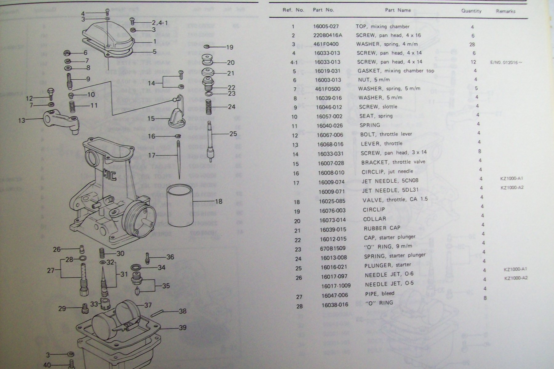

Just happen to have a REAL Kawasaki parts book for the Kz1000A1 and the Kz1000A2.
This should give you the correct part number for the Kz1000A1 needle.

According to the kit shown by Scirocco the needle jet you need is a series 258, size O-6. The jet needle is a 5CN8, set in the middle clip position. (3) That said, you probably don't need to change the jets right away. You might want to try to run with what you've got and save your money for now. Also of note is the price from the site Scirocco posted. It's about the same price un US$ as the kits sold by Z1 Enterprises, which have a lot more parts in them.

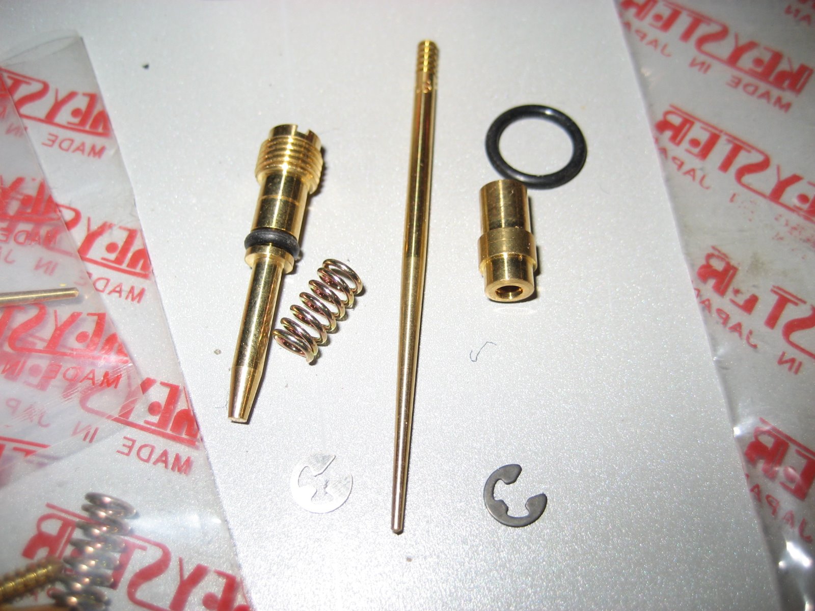

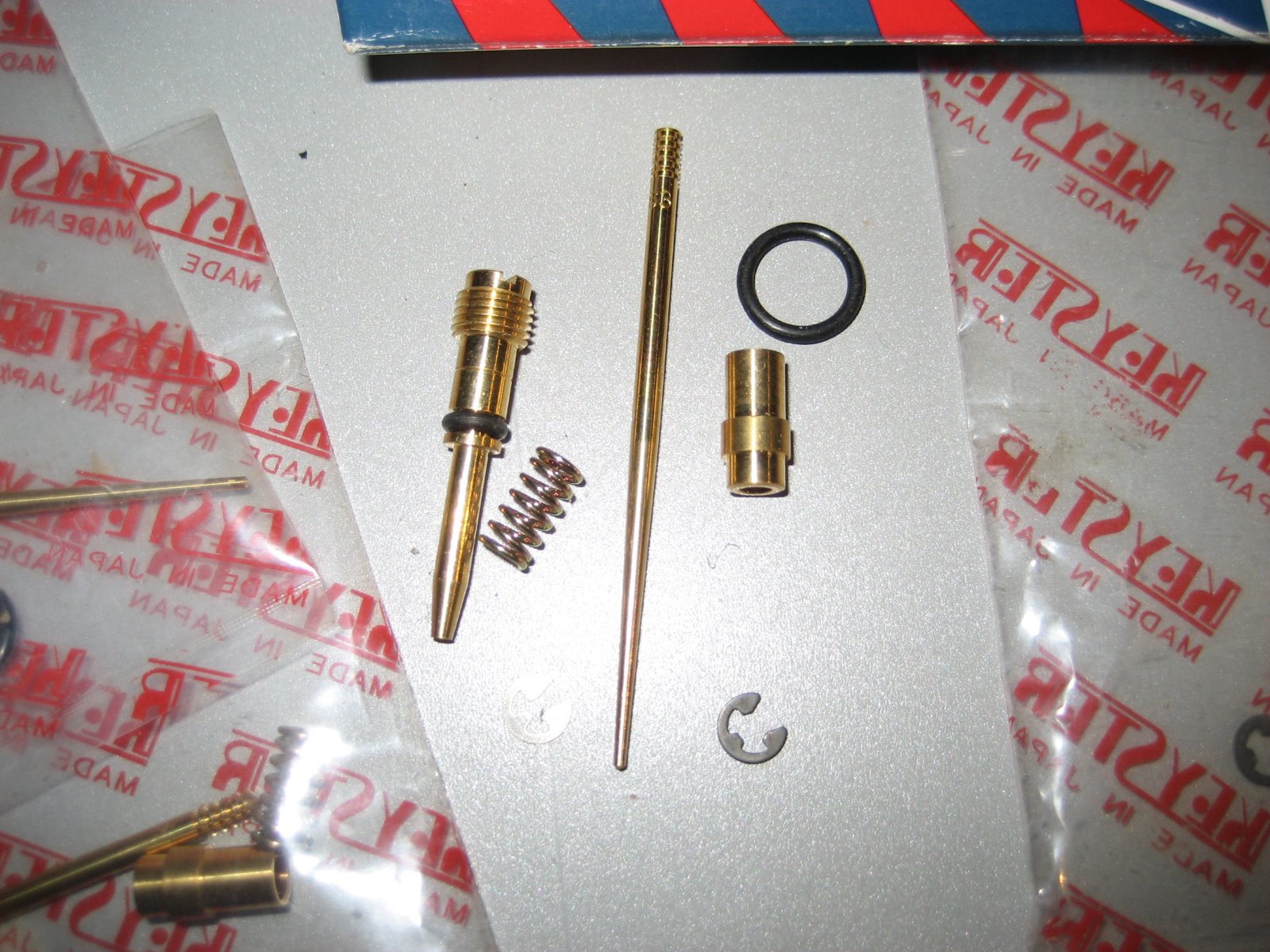

Rick H, If you want i can offer you a new set (4x) of #243 O-6 needle jets and jet needle #5DL31.
They are left-over parts out of an Keyster KK-0161NR kit, (76 KZ900 A4).

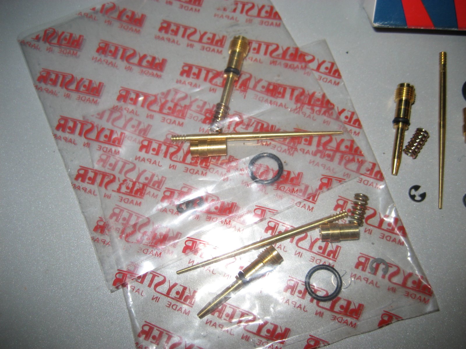

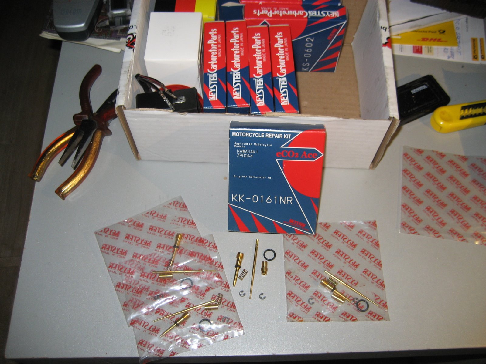

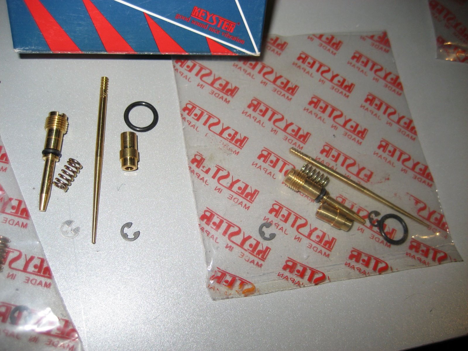

All left-over parts of the Keyster KK-0161NR kit.
Rick, do you want all parts or only the jet needles and needle jets?

I don't know if the diffuser will fit behind those needle jets. The jets have an extra extension on the bottom end.

Good point hardrockminer!!! My needle jets are looking different (longer) so i am out off the game.
