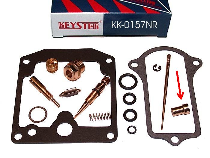

The Keyster KK-0157NR set contains the needle jet 0-6
www.motorradbay.de/kz1000a1-kk-0157nr-ke...a70e956c727eb78a9401
www.kawaschrauber.de/shop/product_info.p...j-1977&SESS=ymhikvot
