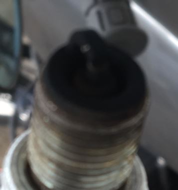

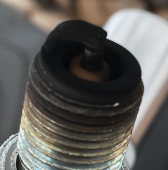

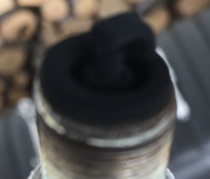

After I rebuild the engine and upgraded to bigbore 810 kit, I have fighting against bad engine running... it turned out the problem was the float hight duo to wrong and bad needle and seat for the carbs.
So now in my mine the engine is going really well, almost so I don`t want to touch anything
Only some small issue of idle, problery duo to some out sync on the carb.
Anyway, I have not checked the plugs for a while and after a 3 hours drive with high speed yesterday, I took out the plugs and all four was block almost identical, some less black was the 4`th, please see attached photos.
During the troubleshooting was the pilot jet increased from 17.5 to 20.0, can these be the reason?
It was not so black before rebuild of the engine when I running 750cc stock engine.

Are you running the proper heat range sparkplugs for your bike ? I never assume .
I would put new plugs in it , Then do your mixture plug color check.
Looks like a real rich mixture.
Easy free check might be to lean out needles ( lower them ) and see what happens
I dont claim to be a 810cc tune expert , but dropping the needles can be done with out any money invested

Unless you did a plug chop at high speed the condition of those plugs only show a rich mixture at idle and possibly the plug is too cold ( you should want B8 or B9's)...
Base circle of plug is mixture and ground strap is heat range but over rich idle will mask all that.
First put the needle back to the middle position and run it . if still showing rich fit the smaller pilots and run it again.
To determine the mix at other throttle openings you need to hold the throttle under load ( going up a hill etc ) and kill the motor at whatever throttle opening/ fuel circuit you want to check the mixture at or get it on a dyno.
For the plug chop method it's easier if you mark the throttle grip and the housing with white marker at 1/4 -1/2 and 3/4 throttle positions so that you can accurately hold the throttle in the correct position before killing the ignition.
