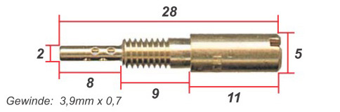

17.5 pilot jet
www.motorradbay.de/keysterjetformikunica...6e1769fe4384b9c23a36
I have 4 x 17,5 pilots left if you want.

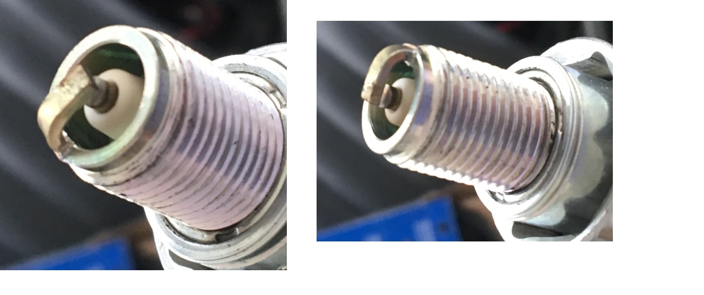

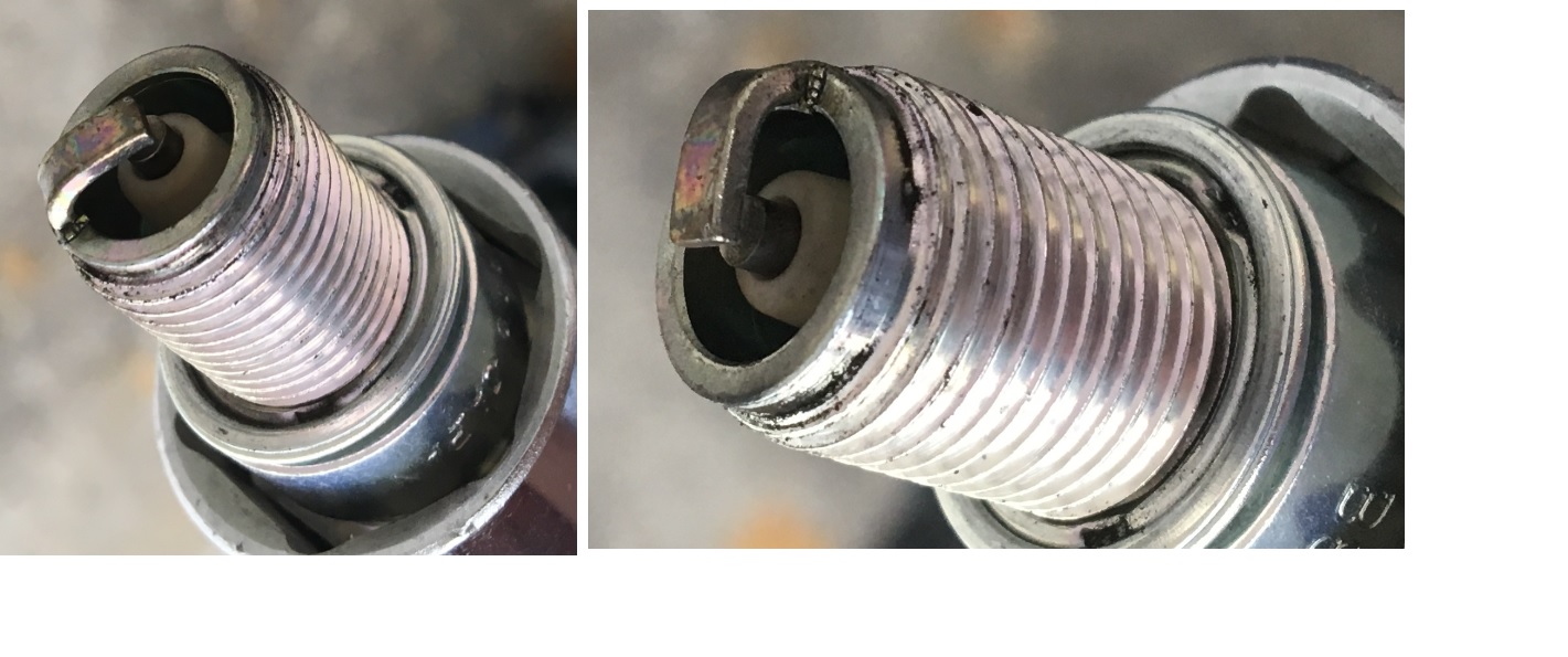

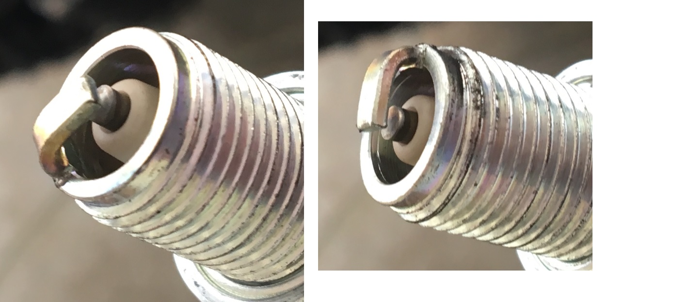

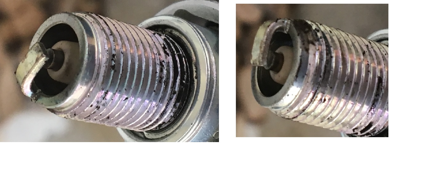

Finaly some work done!
Today have I installed four new spark plugs B8ES lower the needle from 5`th to 4`th position and installed the 17.5 pilot jets.
I adjusted all air mix screw to 1 turn out plus 1/4.
I also synced the carbs.
I recorded a video when I was finish, the idle needle on the RPM display, has not been so stably before on 1... never seen since I have had the bike...
streamable.com/na5kj
I started up the bike, it started easier then before and the idle was more smooth... I let it run for around 5-10 minutes to it was hot...
Then I took out the spark plugs, please see picture below:
Cylinder 1:
Cylinder 2:
Cylinder 3:
Cylinder 4:
I don`t know if the engine was run long enoufh, bu the plugs looks good for now?
My plan is to drive the bike around in different roads city and high speed and then take them out and see how they looks like?
If the engine is running fine and the plugs looks fine I don`t need to do more ? If the plugs are not perfect, then I need to figue out what
area the problem is ? pilot ? needle? main jet.. but not before ?
Cylinder 1:
Cylinder 2:
Cylinder 3:
Cylinder 4:
