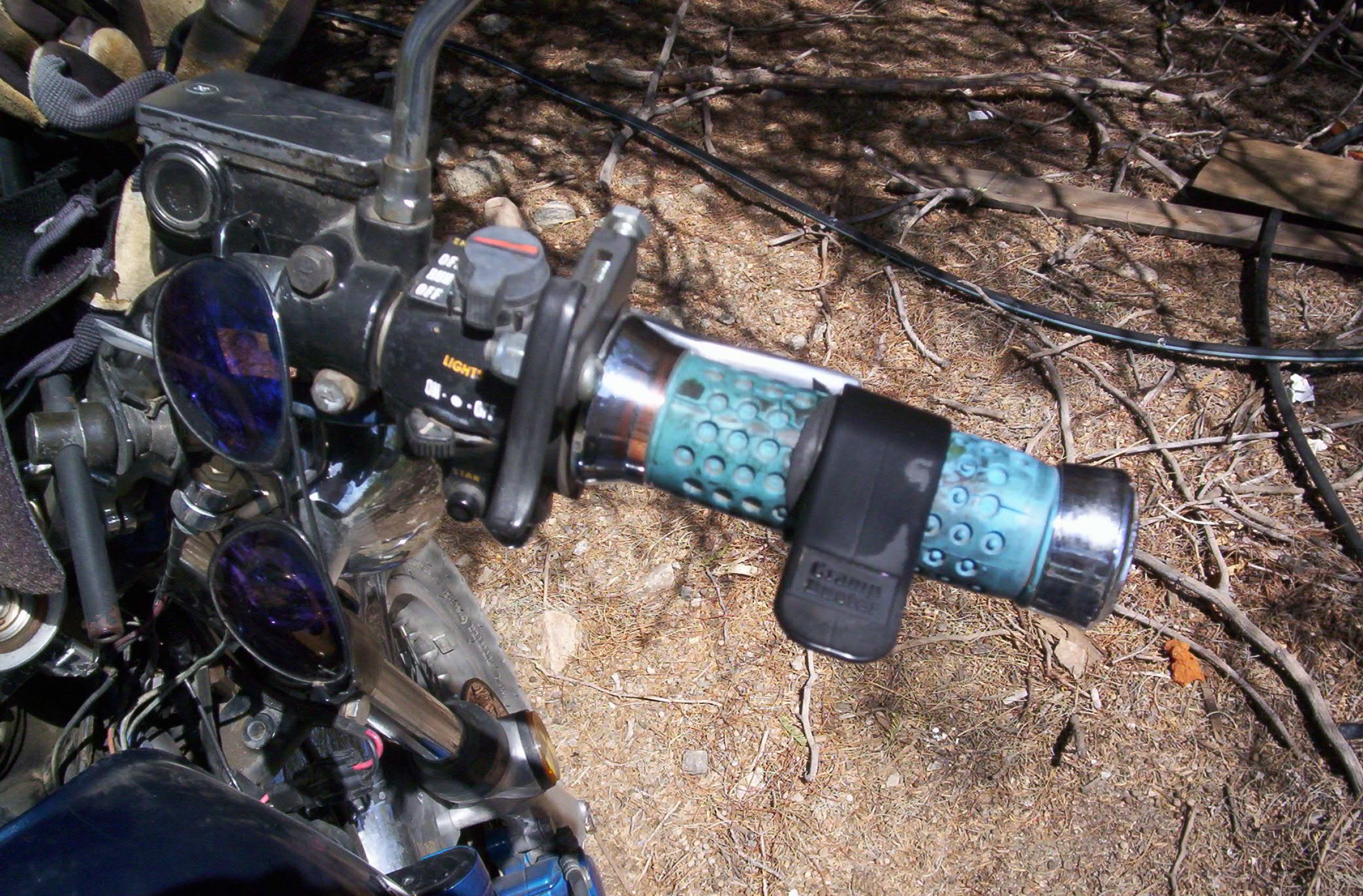

I rode for many years without one. In 13 I went back to two. Not so much for safety, when I blip the throttle it is crisper and it's easier on my old wrist. Got a cruse control and cramp buster too.

I remember Vance and Hines filling there slides with lead.... I think on their Susy 1000 pro stocker to get the idle to drop back down instantly and sound cooler..... always liked the idea but never try'd it. Thinking the dual cables help that way too...... love that cruise control too Steve one of the things I would never do without.

Nice to be able to take my hands off the bars and let them rest on long rides. Freaks out the people behind me especially when I lean back and stretch with both hands off the bars. :woohoo:
