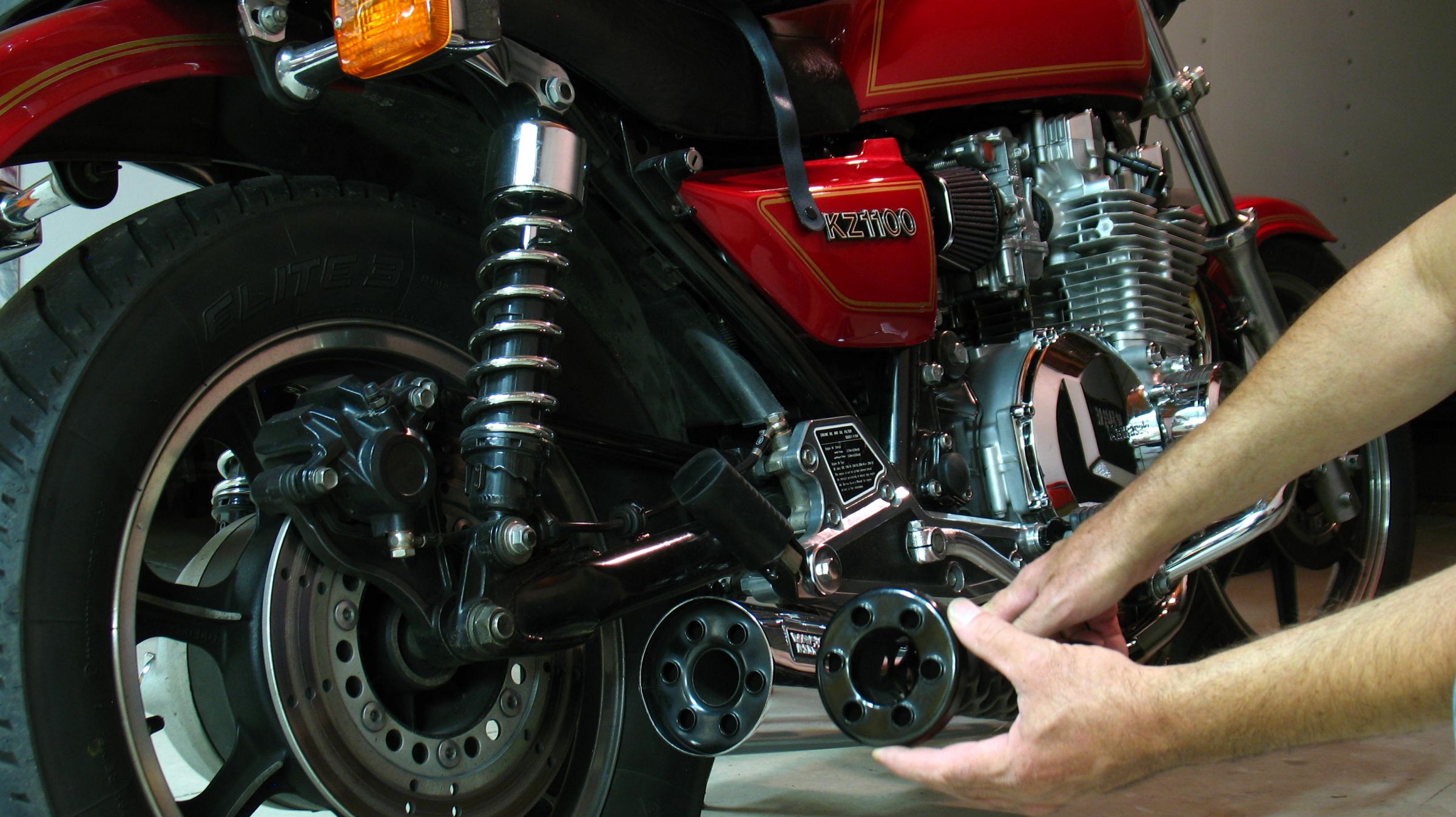

Thinking about the competition baffle again :whistle: , since I'm pulling more air with pods now...perhaps no baffle at all :ohmy:

I still have my competition baffle in. Yet to try the street one. I repacked it ans it works well. Try no baffle. I'll bet that won't last long. :evil:

05 Aug 2016 06:07swest wrote: I still have my competition baffle in. Yet to try the street one. I repacked it ans it works well. Try no baffle. I'll bet that won't last long. :evil:
Kept displacing and blowing holes through the packing, and I hate handling the stuff. That crap is gone, dude! :evil:

Back pressure is your friend. I'm going to try the street baffle without packing. My Jardines didn't have any. The drag baffle was a drag :lol: .
