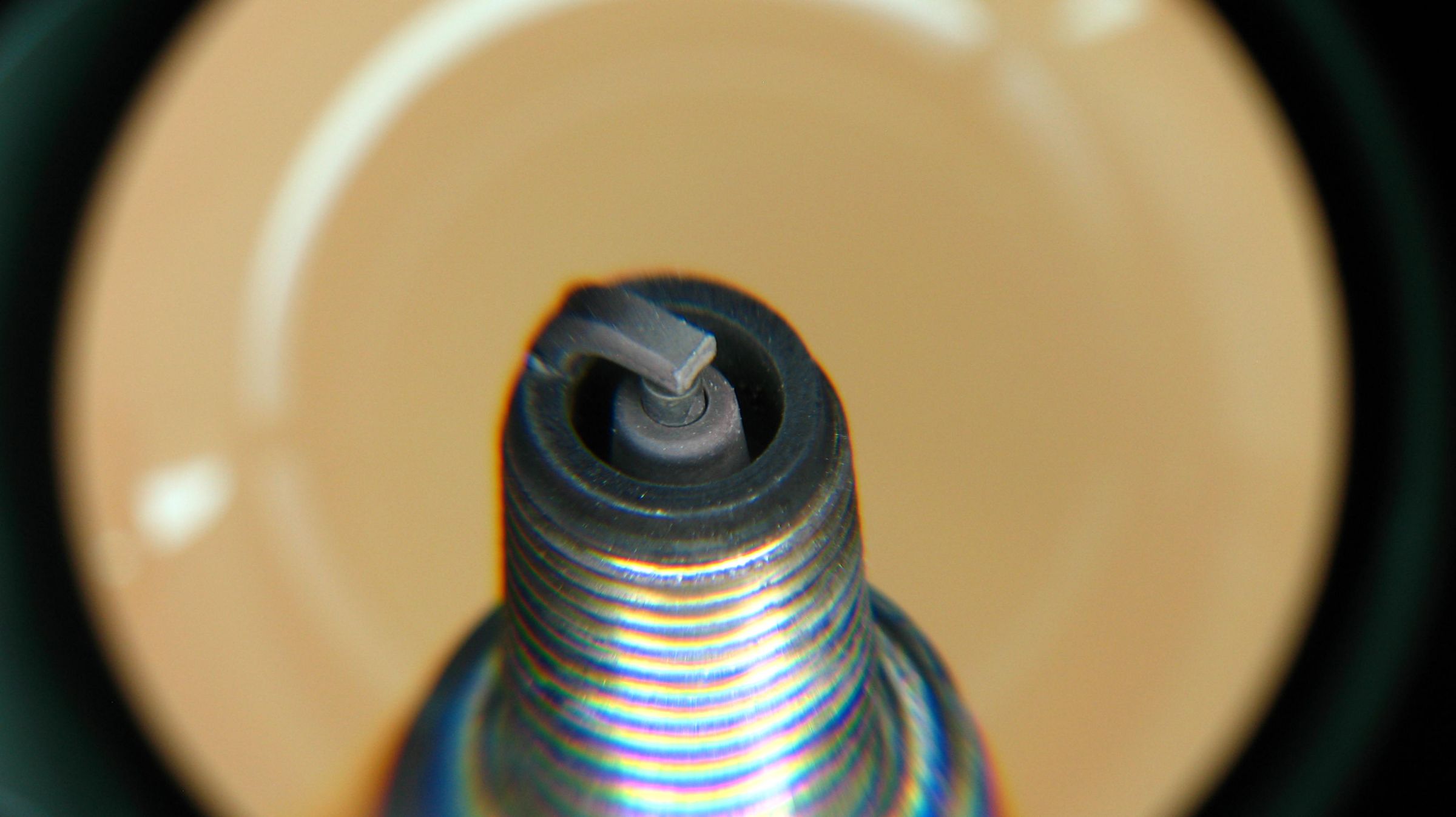

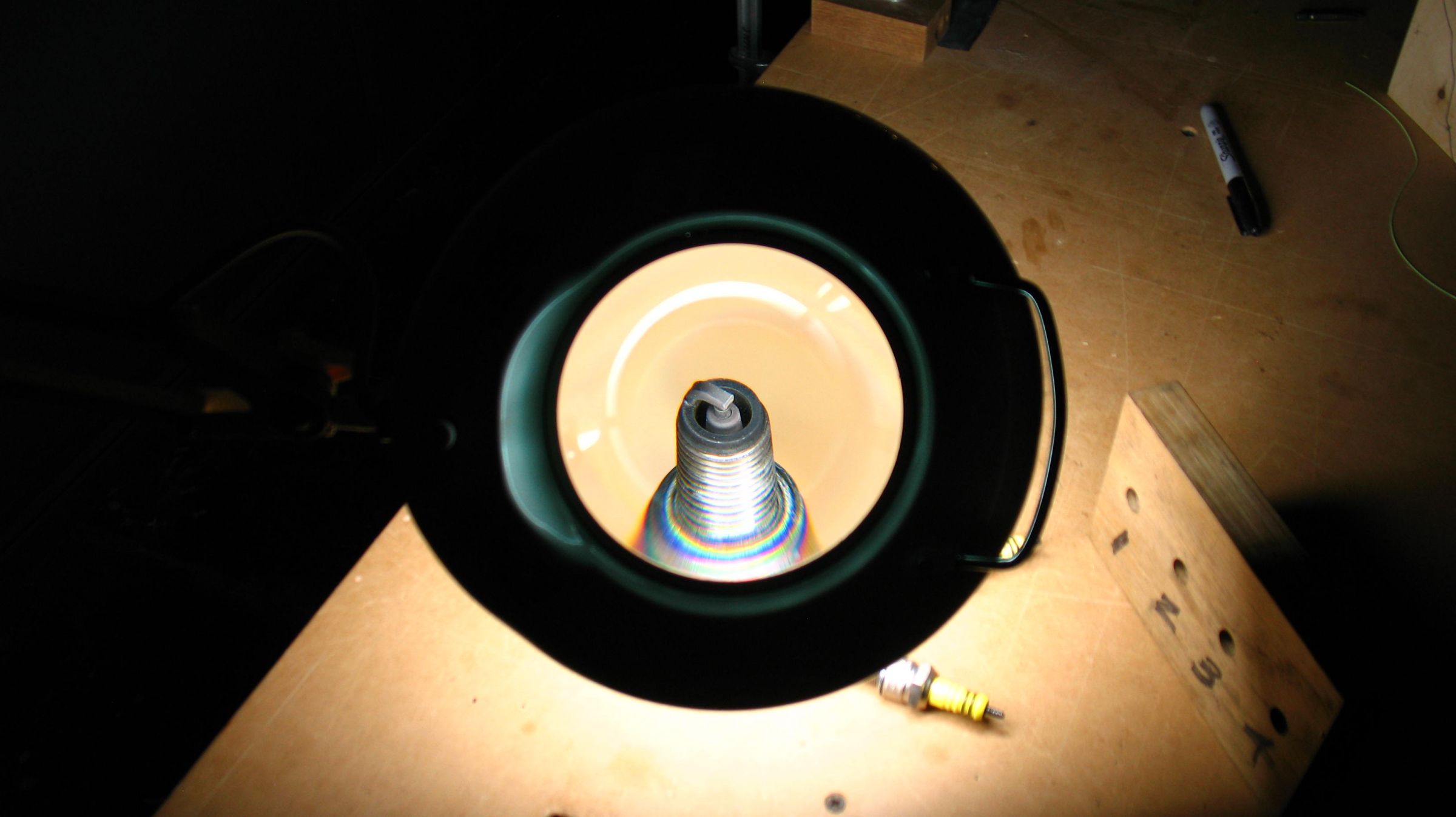

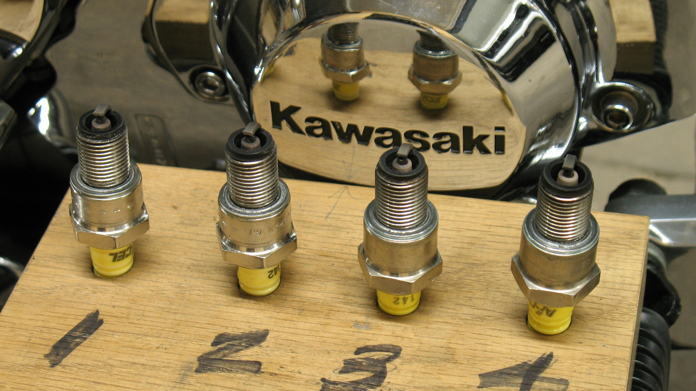

02 Aug 2016 23:33 - 03 Aug 2016 05:37swest wrote: Depends on what gear and how long. Watch those plugs in this heat.
Reinstalled the .7 air jets to richen up the #20 pilot jets.
These carbs originally came with .8 air jets. Smaller richens, and bigger leans. :S
Plug appearance with pod setup after a couple long rides:
1982 KZ1100-A2
