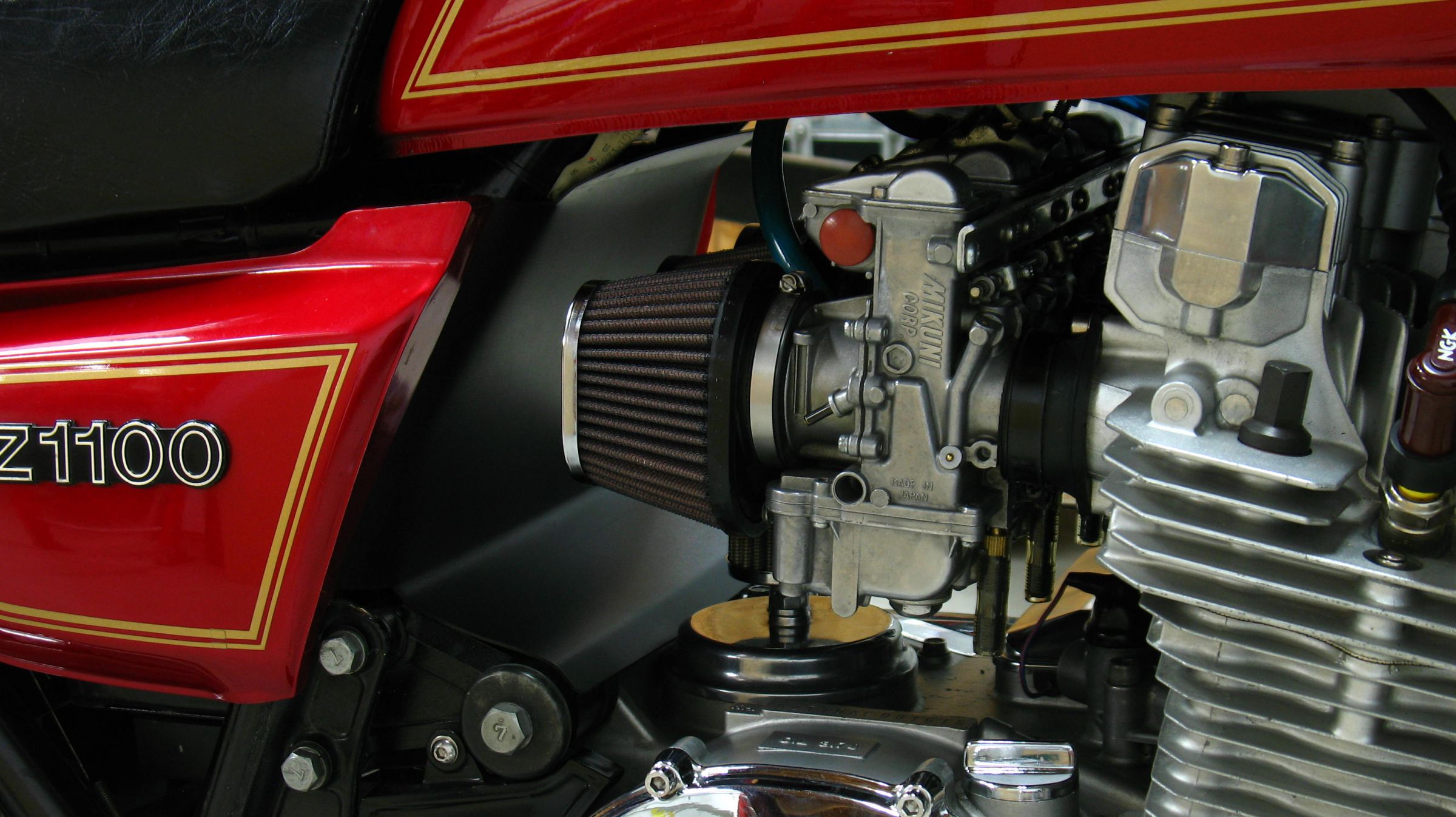

:whistle: Prepping for the K&N individual air filters I've had tucked away in a box...aka PODS!
Planning to start with the #20 pilots, along with the quieter V&H Street baffle...
