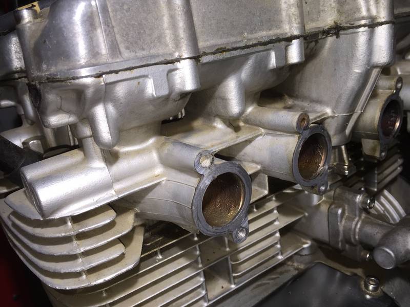

Since the carbs are out and I'm replacing the boots I figured I'd look around.

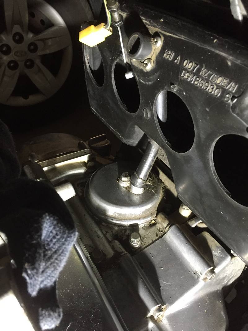

I replaced the cylinder head cover with the non-emissions version so that top hole isn't needed any more. Anyone have recommendations on the best way to cover it? What about the breather tube connected to the airbox...does it need to stay there?

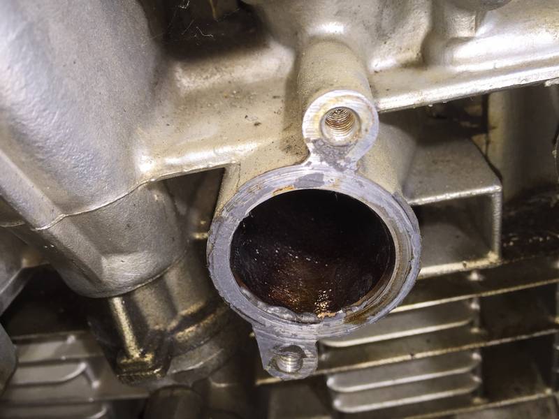

What about the residue just inside the carb boots? Should I try cleaning it out with something? Use a wire brush or does it even matter?

somebody put grey RTV sealer on the intake manifolds to seal a vacuum leak.

I removed that nipple from the airbox and replaced it with an aluminum plate sealed with RTV.
The crankcase breather must remain functional. I'd just leave it alone.
The dark residue inside the intake ports on the head won't hurt anything. I'd leave that alone too.
And needless to say, be sure to check and adjust the valves as needed while you got everything all apart.

Keep the breather. The dark color suggests intake valve leakage. Adjust the valves.

Whats the best thing to use to remove that stuff? Scraping it hasn't been too successful.
bountyhunter wrote: somebody put grey RTV sealer on the intake manifolds to seal a vacuum leak.

Fortunately, I adjusted valve clearances when I replaced the cylinder head cover. Likely that dark was from when it was out of whack before.
