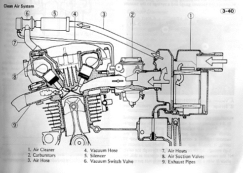

19 Mar 2016 14:46car5car wrote: There are 2 vent holes (tubes) on top of my valve cover. I installed hose, connecting them together.
Hoses from the stock clean air system attached to the left side air suction valve cap and to the right side air suction valve cap.
An air suction valve is commonly referred to as a reed valve.

19 Mar 2016 17:08car5car wrote: As far as I know air injection system is a reason for popping on many bikes. That is why people disable them all the time. Maybe plugging is better than connecting hose between tubes.
I don't know what you mean about 'popping'. The reason I got rid of mine is because I didn't like how it looked and I didn't want the additional complication on my bike. All the system actually does is bring in fresh air to mix with the exhaust so that it would pass US emissions requirements. Kind of funny how it worked...same amount of exhaust in the air but the government was happy because it didn't come out over a certain percentage. LOL
Imo, whether you plug them or connect the two hoses together like you did, won't really matter.

That looks pretty nice...I might go mildly ghetto on it and make one out of black plastic or something. Been looking around my garage for options.
I noticed that hose doesn't connect directly inside the airbox as well. So leaving the connection into the bottom will keep it open like you and patton recommended.

19 Mar 2016 19:33Little B wrote: . . . I noticed that hose doesn't connect directly inside the airbox as well. So leaving the connection into the bottom will keep it open like you and patton recommended.
Thanks for confirming that the hose doesn't connect directly inside the airbox.
My X-Ray vision failed again. :lol:
