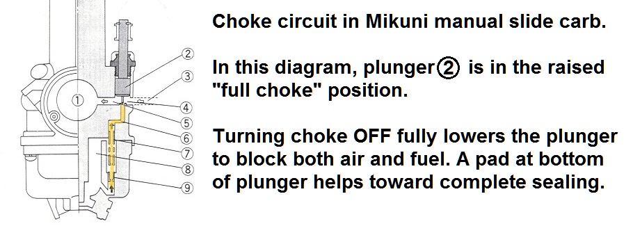

The choke (enrichener) circuit is a separate circuit inside the carb, which is different from the pilot circuit.
It might also require some tlc, but generally, in my experience, causes less problems than the pilot circuit.
