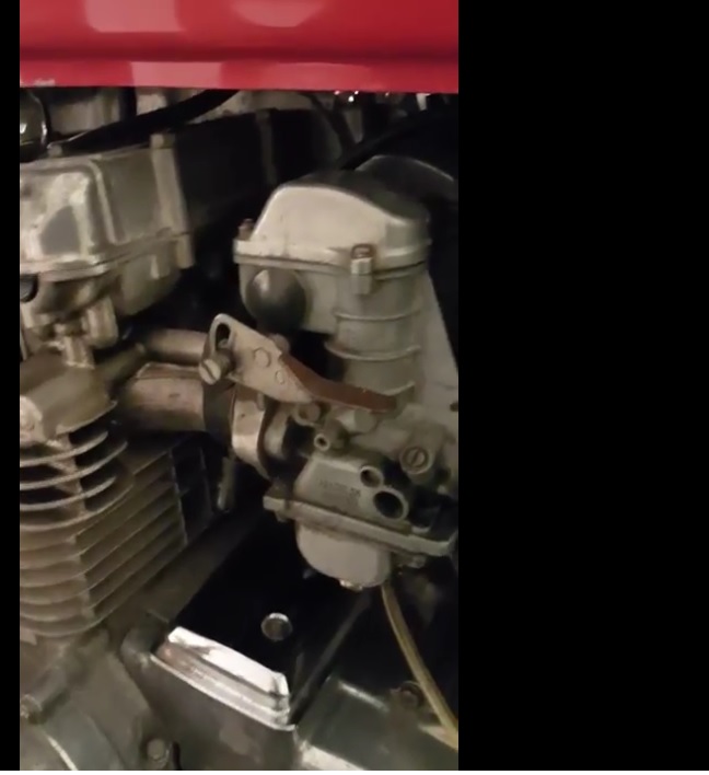

What I meant was that after I finally get the bike going down the road again, it will start running decent again about 30 seconds later. I'm getting ready to post a link to a video of the bike running. It almost sounds like it's choking but idk how to explain it very well. You can really hear it when the seat is up

Is the video showing that there's not a vacuum hose attached to the petcock?
If so, is the vacuum nipple capped/plugged on the carb or carb holder where the missing vacuum hose is supposed to be attached?
An open (uncapped/unplugged) vacuum nipple on any carb or carb holder usually results in a large air leak.
Video indicates a racing idle with the choke OFF.
Was the engine already warm when cranked and started in the video?
